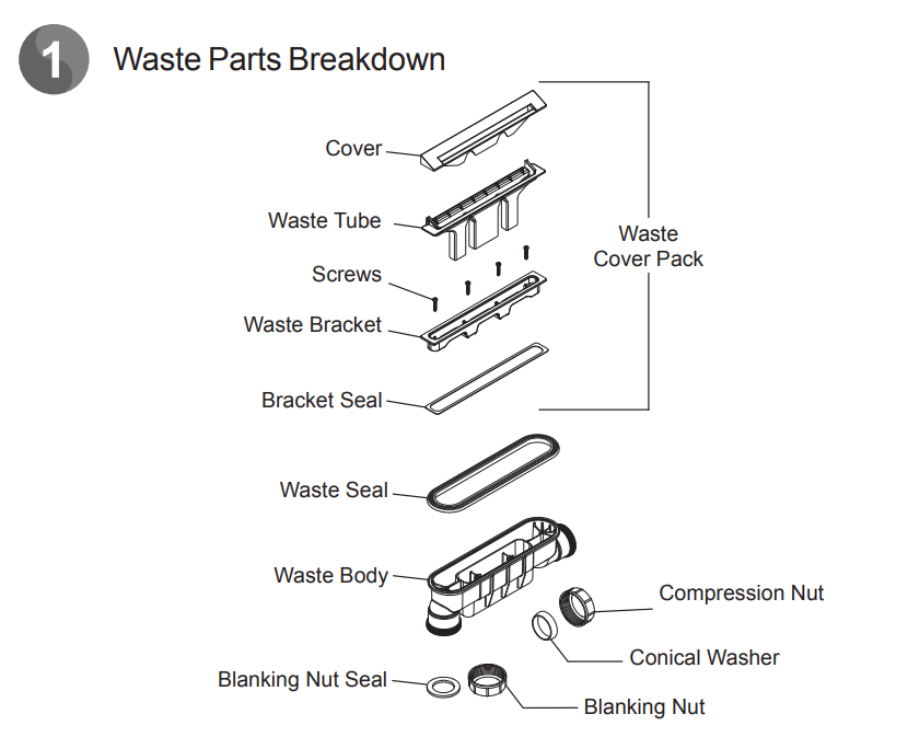

Had actually been using shower for a while fine (a few showers a month) but recently found a slow leak coming down through ceiling in bedroom underneath. Cut a hole in ceiling to inspect, and turns out the "waste seal" under tray was pinched\torn and after a few mins of hot shower it was letting water through. Mira sent out a whole new assembly - and when replacing, i noticed plumber never fitted the "bracket seal" - so when i reassembled with that added, and a not torn "waste seal" - i could sense it was all more 'air tight' and was operating as designed (i.e. "waste tubes" and waste body forming a water trap'). But while we fixed one issue, we started seeing the 'airlocking' @Madrab described , which the hole sorted....but believe i'm reading that a better fall would have sorted too?
Main question i have now though - is the fact i drilled an 8mm hole (on opposite side of drain escape) meaning that i'm going to get sewer gas up? Is that what a self-venting piece should prevent. Like OP, my fall probably isn't great, and goes out to the soil stack with AAV. I don't believe i have a self venting section of pipe work under shower tray- there's just an elbow coming off vertical waste outlet and a white flexi bit for a half-meter that i can feel connects into a solid pipe and goes outside to meet soil stack. should i replace flexi run with a self seal or something suitable? Any advice appreciated.
Update: Confirmed it's a mcalpine stiff flexi (with the smooth inside), so not too bad, thinking i use the flexiness to try connect to the opposite waste side (horizontal one) so that creates more of a fall, as being connected to the vertical means it's a bit lower). i'll take a pic later...
