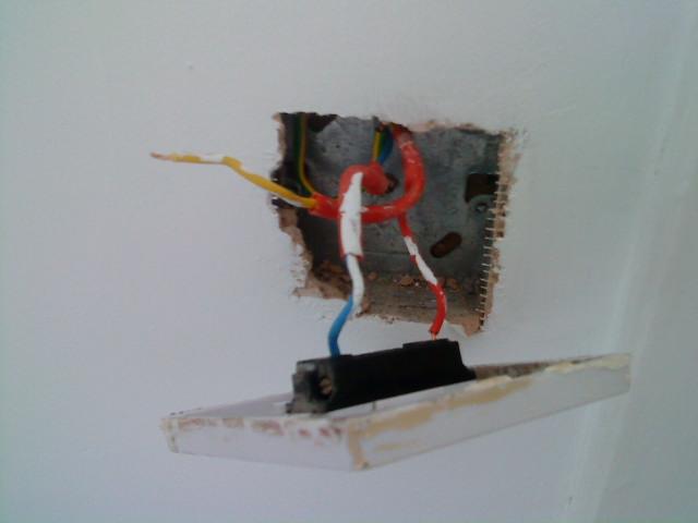

At the switch there is a single 3-core and earth cable, colours are red, yellow and blue. Red is in C, blue in L1 and yellow in L2. When I found it, the yellow was free, and others loose. Could have been in L2, or tied into L1 with the blue but please read on.

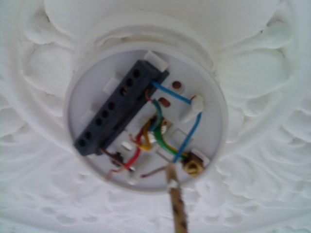

At the ceiling rose there is a single 3-core and earth cable, colours as above. There's also the usual blue and brown 2 core cable down to the actual bulb. The red and yellow are in the same connector block as the blue to the bulb, i.e all connected switched live. The blue is on the brown connector block, i.e. the neutral side.

it worries me that you think that brown is the neutral side...

Thanks folks - ColJack - sorry about the typo in the text - you're absolutely right - a pic is worth a 1000 words and it doesn't help when I get my colours wrong!
Hope these help the diagnosis.

Your bulb is wired backwards for a start. The convention is brown for live and blue for neutral. I know it makes no difference to a light bulb but it's thoroughly bad practice and a source of confusion you, and also we, can do without. It doesn't take much effort to get two wires the right way round. :cool: :cool: :cool:
