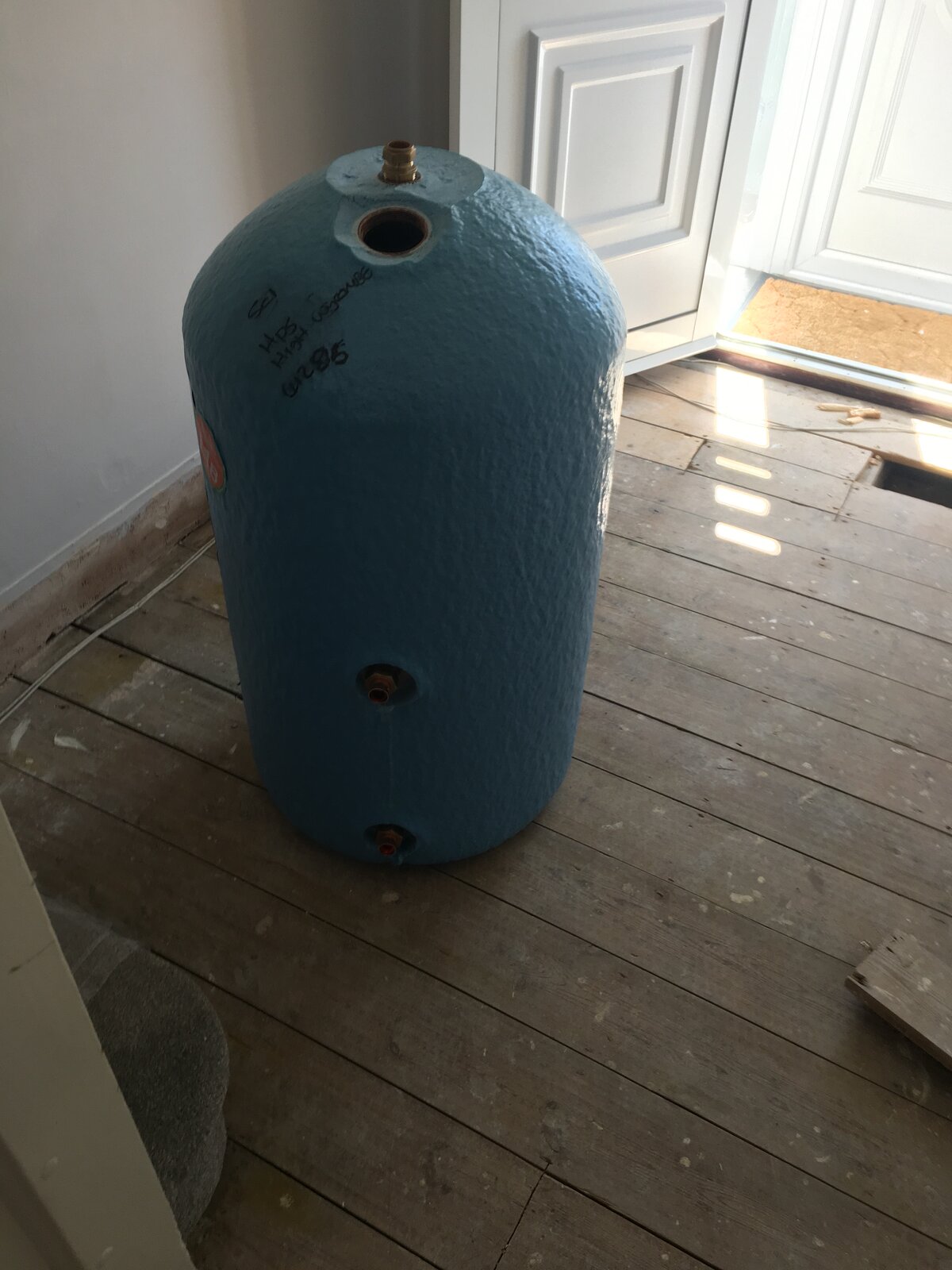

I just had a new blue cylinder fitted, the system has a expansion vessel so is pressurised unvented i think

Just had the blue water cylinder installed Friday expansion vessel is red, so what’s the difference between 100w and 200w ?

You are getting very confused...the new blue cylinder is a traditional vented cylinder.
It's cold inlet will be gravity fed from the large water cistern in the roof.
In case of overheating steam is allowed to boil off by a vent pipe that rises from cylinder top connection, vertically up and loops over the cistern where the pipe end just dips below the cistern lid.
Your taps (normally except the kitchen cold) are at low pressure governed by the height from tap outlets to cistern water level....hence shower pumps are often required.
I hope the cylinder immersion heater has been installed and can be operated if the boiler is out of action.

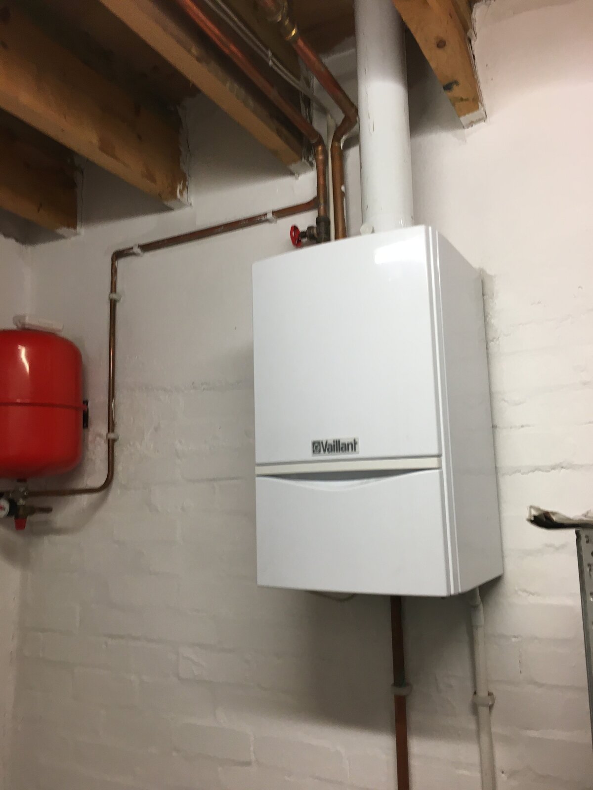

Your boiler system is presurised and hence you have the red expansion vessel..the compressed air inside the vessel creates a static pressure in the system (to allow you to bleed air from the system) and (since air is compressible) accommodates the small extra volume of water when the system is up to temperature and the water expands by a few %.
I strongly advise you not to get a system boiler. With your size of property (and no doubt poorly insulated and a highish heat load) I would advise a regular (aka heat only) boiler.
This allows you to add a more appropriate sized expansion vessel. You are also not tied to the boiler manufactures choice of pump (and often exhorbitant cost of replacement).
System boilers are more suited to new build properties with small heat loads...where the expansion vessels only need to be of small volume.

With that cylinder you may only need to allow a few kW to heat it as the calorifier (the coiled tube inside that dissipates the heat from the boiler water) is relatively small (compared to high recovery cylinders/unvented cylinders).
See if the coil rating is written on the side. There's no sense in putting a larger than necessary boiler in.
