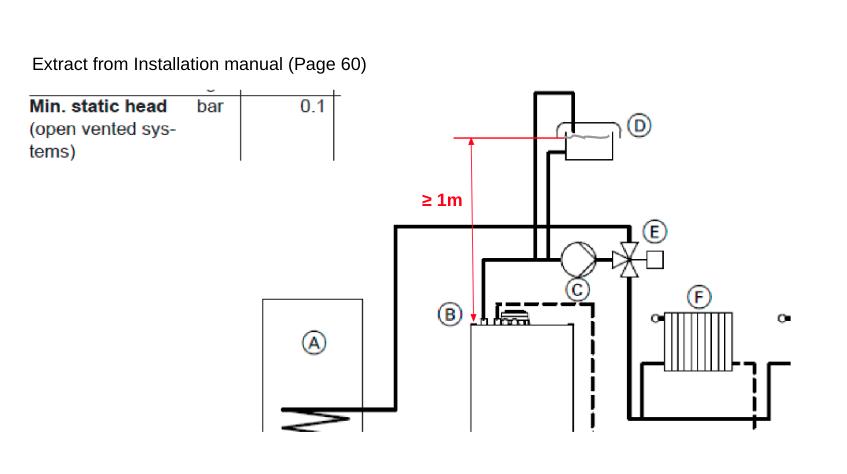

I had space constraint where I wanted to install the boiler. The actual static head required for boiler to work is 1m as opposed to what is stated in manual, I got confirmation from Viessmann UK and is working brilliantly at 1m head. You can search for my posts on OV installation here. Your installation will be done by professional so it should be least of your worries.

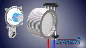

Vaillant stopped doing stainless steel open vent as well a few years ago. I think now it is just Viessmann and Alpha. I think @Gasguru posted something which might help explain it earlier in this thread. I think he was saying that the SS HX used by several manufacturers (Vaillant, Ideal, Baxi?) is very tight and easily gets blocked. I can see that might mean it is not a good idea for open vent which apparently is more prone to sludge. Also, I remember another poster also said there was a potential issue with some SS HX with venting and that meant they weren't suitable for open vent. Admittedly, I didn't actually understand that point! The Viessmann SS HX claims to be more free flowing.
Something made me think that the Viessmann HEX design was a continuous coil of round tubing (a very poor description,I'm sure) and appeared to be free flowing. I may well be wrong. I'm not committed as we speak and am all ears.
That's certainly what it looks like. Whether it's more complex inside is above my pay grade!
I think all SS HX are coils. And then a radial burner, attached to the combustion chamber door, sits inside them.

Your Viessmann guy will be able to explain it a lot better than me. I'm not trying to put you off. They definitely claim to use a wider coil.
I am also planning to stay with open vent and that is why I quite like the look of Intergas. Their heat exchanger is unique and has wide copper waterways. But two things put me off a bit. The modulation on the open vent model is a bit rubbish. Also, there is only a relatively small installer base.

I am a home user and not a pro and would like to clarify as a user that I did check with Viessmann UK and they confirmed and it is written in MI as well that OV boiler can be used in a pressurised or seal system too.
