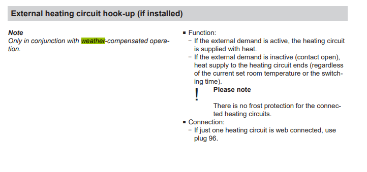

Read thread with interest as I've just had a Viessmann 050-w 30KW combi installed. I'm considering WC and as i understand it from the supplied manual, you can have an on/off stat connected too (not opentherm). So as @tech749 describes, this external hookup can be used to override what WC is trying to achieve by switching CH on or off based on a limiting indoor temperature.
I was wondering - do you need on/off stat because this boiler has only 'Standard WC" controls?
Reading this WC PDF from Viessmann, it seems to suggest Night Set-back is only available with 'Advanced WC' Can anyone with an 050 confirm. I've not been able to find a thread or video of anyone showing WC options on this boiler. If it isn't available, i can understand why you're using the on/off stat, and just considering if i'd do same. ta

Hi John
I think the PDF you are looking at is a bit out of date, I was a bit confused by this document after mine was installed. The 050 range does have a limited Advanced WC, in that you can now adjust the curve as shown in the lower diagram by using the Vicare app, instead of being a fixed curve, which makes it a lot more efficient in my view. The things that aren't included are the ' Further Benefits ' as listed at the bottom of that page.
I use the controller to basically switch it off remotely by adjusting the temperatures day and night to suit my requirement. I was told that it is best to have the heating on at all times in the winter totally controlled by the WC, and it seems to work very well for me. In the latest cold spell the overnight heating did come on at about 0400hrs because the temp in that room dipped below 18 deg, it then regulated at that temp using the controller. We found that too warm in the bedrooms because they are warmer, so reduced it to 17 deg. I didn't want to go too low, as with WC it would take a while for the downstairs to reach room temp again, there isn't a boost function unless you want to ramp up the boiler set temp each time. But at 17 deg it doesn't come on overnight. I did reprogram it to come on 1 hour earlier to give it chance to heat up before we got up in case its lower than 18 deg. All working great now. Got my heating on all the time (both retirees) and still using less than my old system which was only on a total of 8 hrs, so really happy.:giggle: Just had new loft insulation too which really helped keeping the house warm.
To answer your question I don't think there's a timer/temp set function on my boiler as far as I'm aware, which is why I wanted the wifi controller, which I can also use when we go away etc. Feel free to ask me any questions, I have a good understanding of the system now, I don't mind. Viessmann customer service email are also pretty good, usually get reply almost straight away. Hope this helped anyway.
Hi - yep, i think you've confirmed that there's no set-back function with this boiler's implementation of WC and what you've done with the controller is clever. It does seem bizarre to me that this isn't available. I'll consider WC now as i can set up the same 'dead switch' style arrangement with my nest wired in on/off mode. It may even be best option for me as our boiler is below our bedroom and our house is old with solid walls, so would definitely fire many times during the night if left to WC control, which may be too noisy for a light sleeper like me :)
