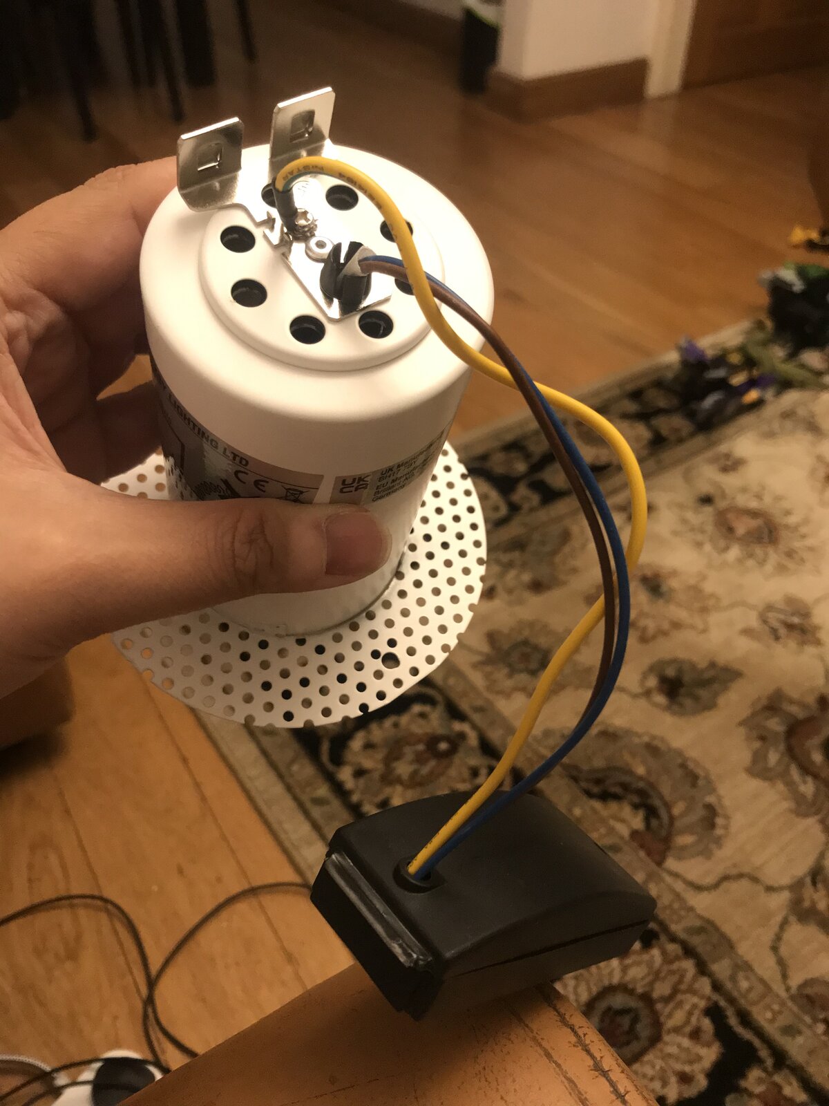

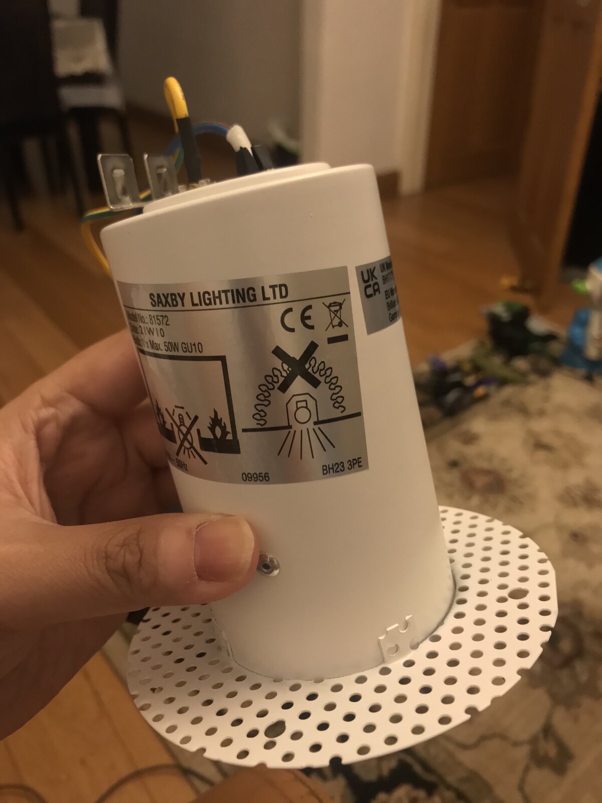

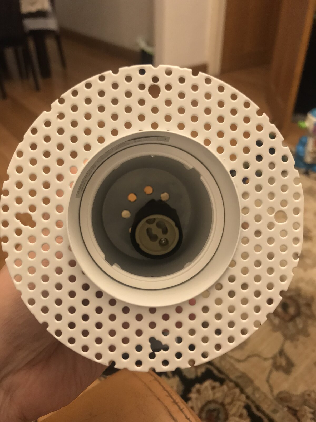

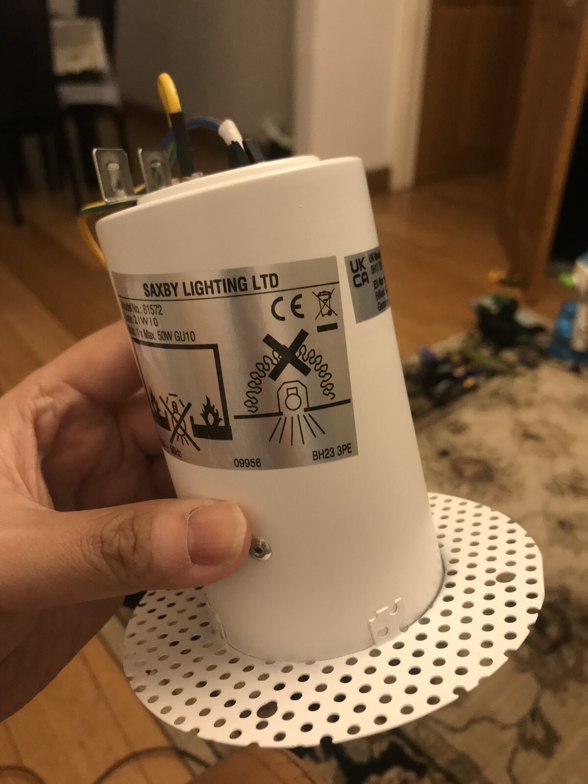

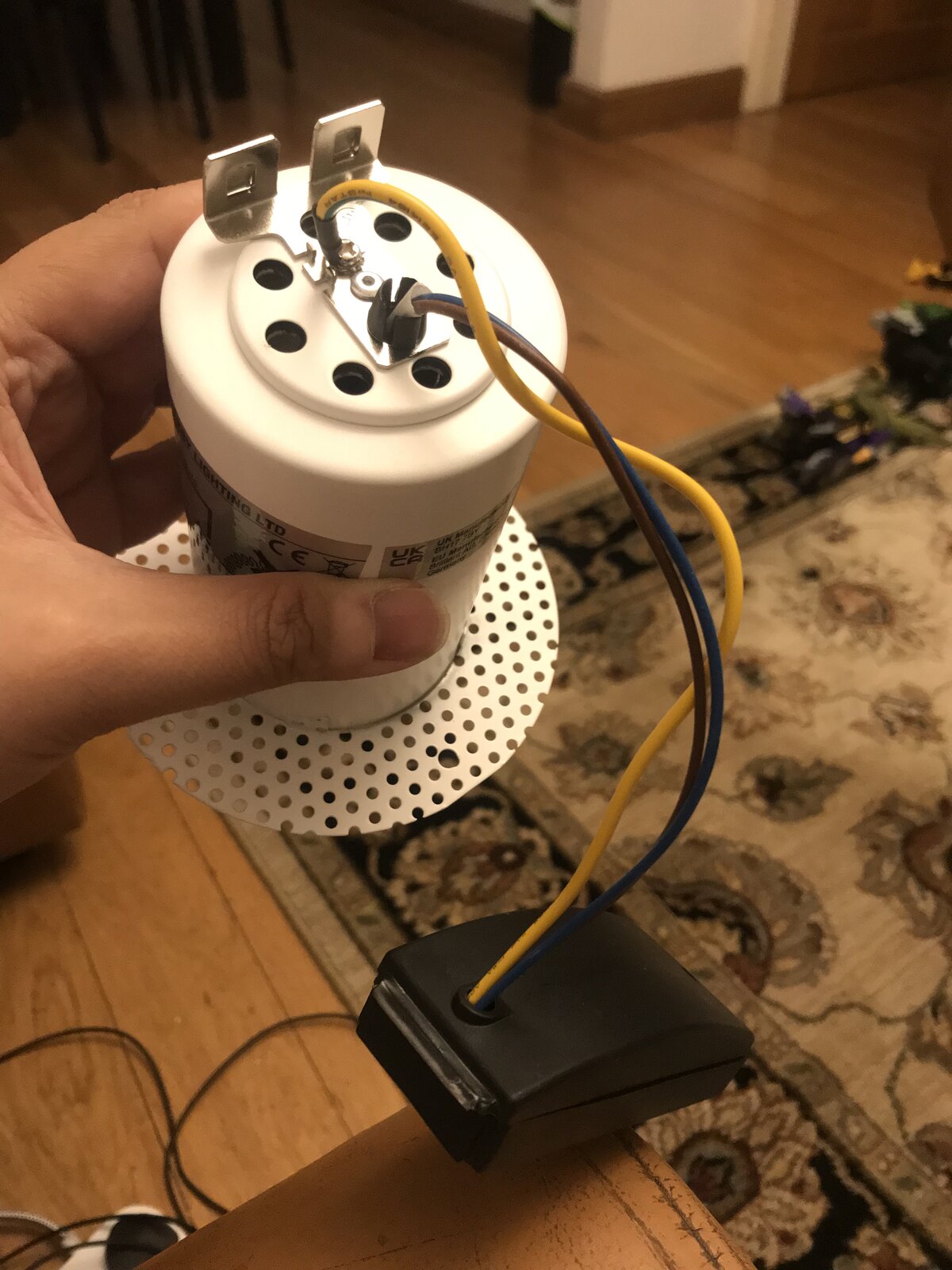

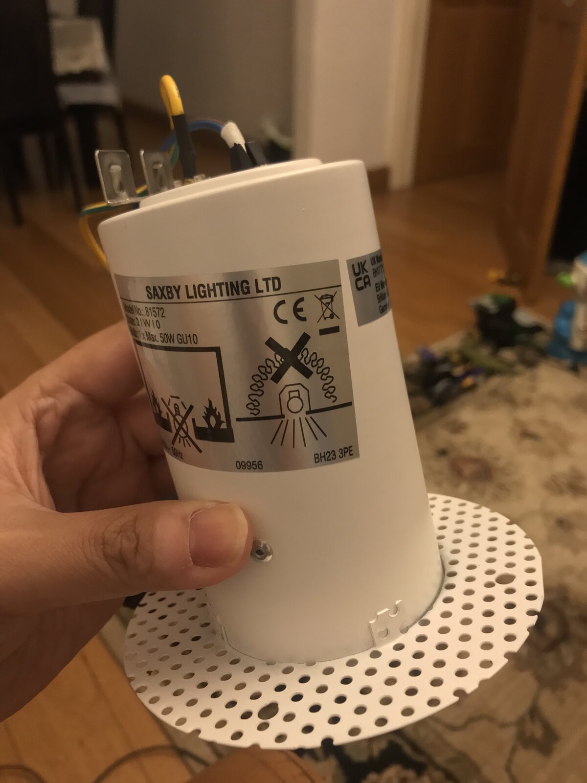

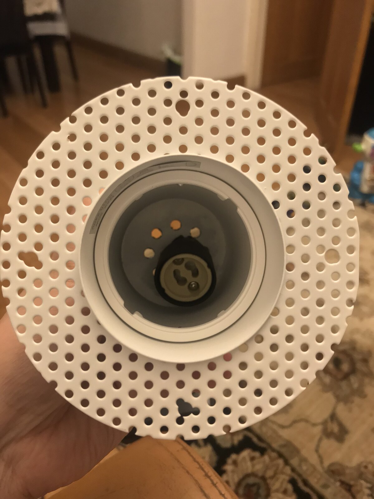

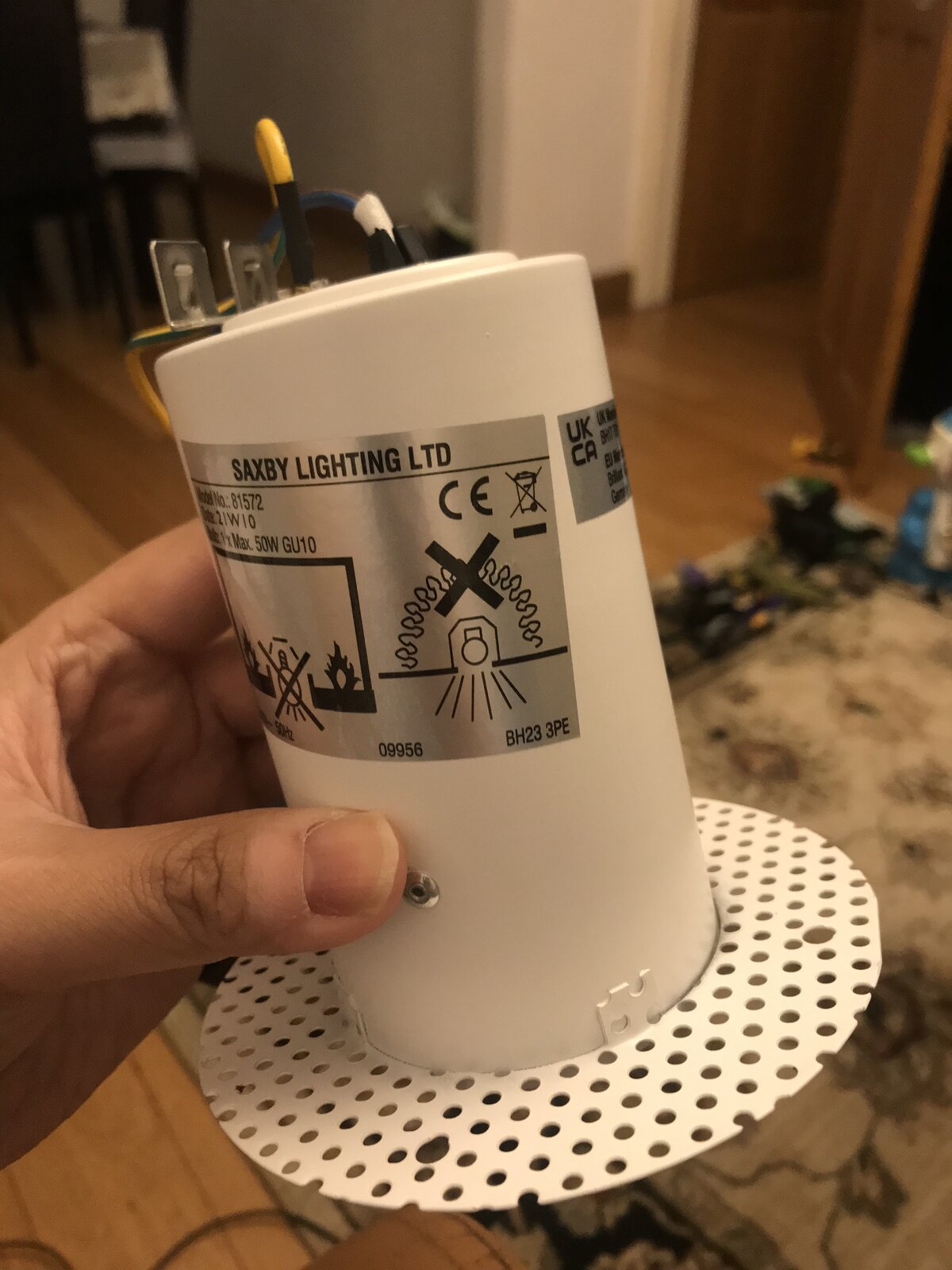

Most units will allow the bulb to be removed otherwise there would be an obvious problem for this type of plastered in light fitting. But what about if the electronic parts fail or you need to replace the whole unit, are you saying you can do that without damaging the plaster?
Can you tell from the description of this item on Amazon or from the following photos I attached, whether it is similar installation to the one you describe from All LED i.e. can change the parts if something is faulty? Are they all done this way?

The type I linked to you can remove the whole fitting. Get the driver out, and any junction box ( Correctly sized for the hole.)
These do not have a lamp like a GU10 which can be replaced, but are a self enclosed LED . If it fails you need to replace the unit.
Some have built in drivers, some separate drivers.

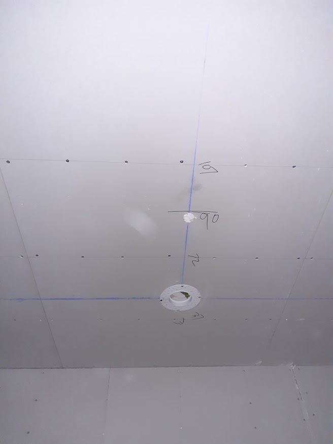

This is a picture of the 'trimless kit', before plaster.
The lip is not that deep so I generally. do not use the screws supplied, as they protruded to much, and will not have a decent plaster covering. I generally countersink a few holes in the plate so a flat head screw sits flush, and grip fill the plate to the ceiling so it does not move, and crack the plaster at some point down the line, if you need to replace the fitting.
you can just about see the cables poking out, so all connections can be done after plastering.
Those pictured look like the fitting it self is plastered in, an will not be able to be removed. You would be able to change the bulb. But if you needed to change the lamp holder, or there was a problem with the electrical connection, you would be in a bit of trouble.
