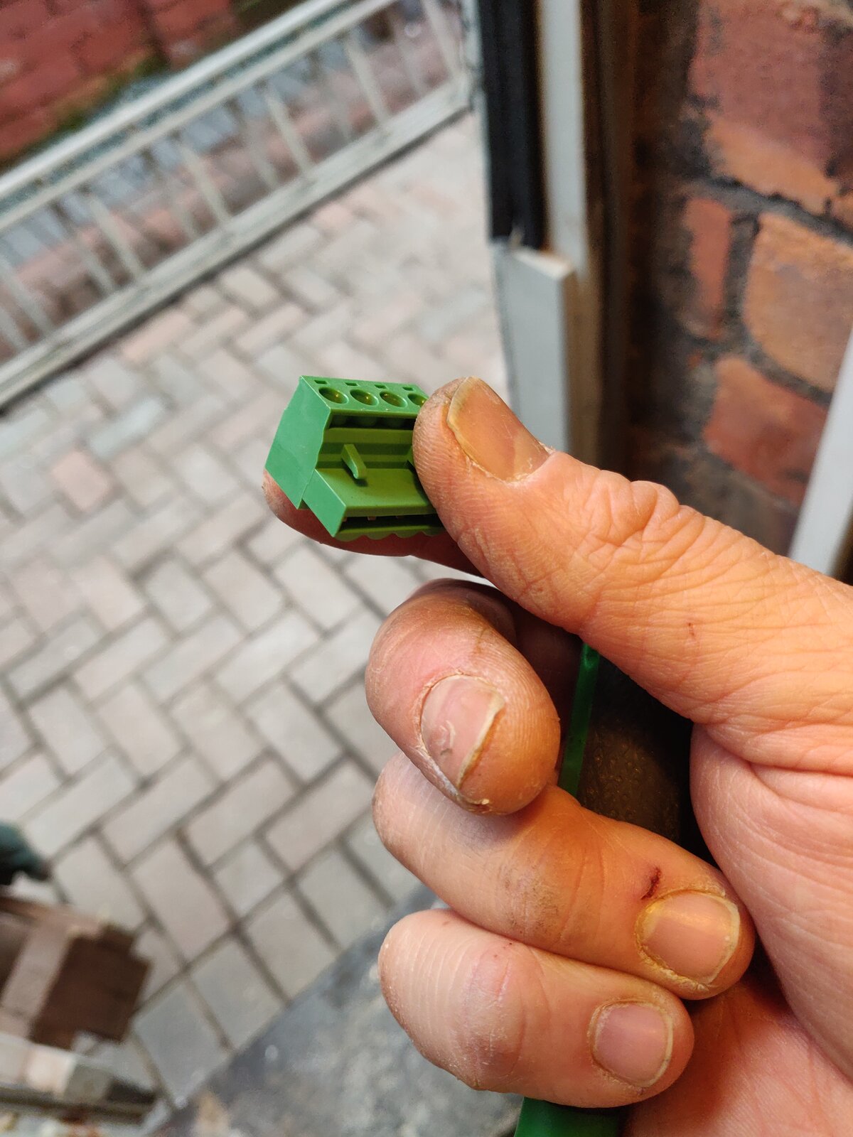

This is the interface plug to be able to use opentherm and/or weather compensation if your model isn't opentherm native.
This is what a £20 plug looks like
The cn5 on off needs to be linked for opentherm to run I think.

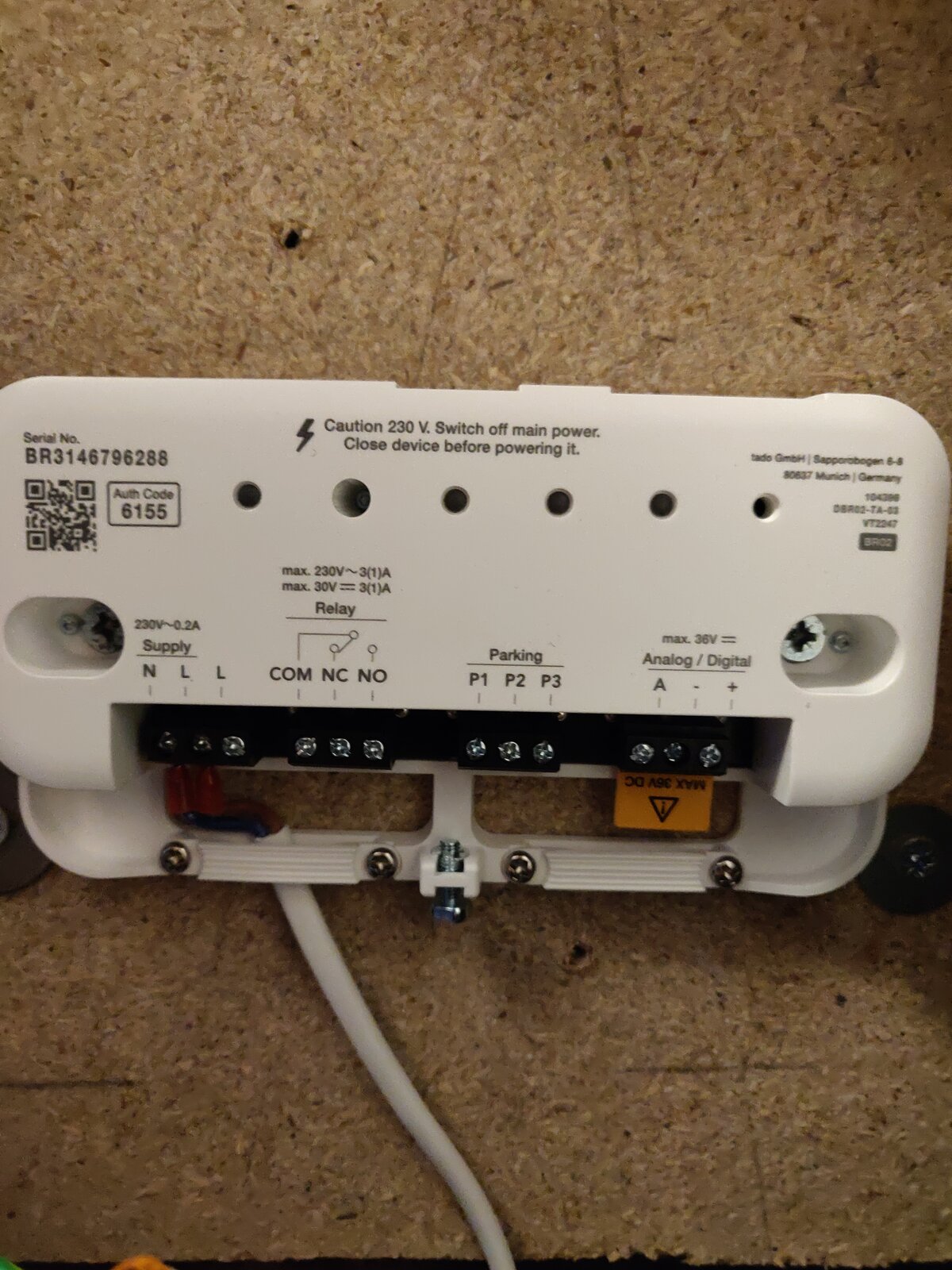

Also here's the tado EU receiver wiring.
Excellent, thank you. As TADO aim is to be all things to all boilers it's not surprising some information is limited however it's looking for a Unica but is actually on an Excel.
This will help Monday as I am trying to compact the connection procedure and operational structure for our new app and control at the moment. It's far more comprehensive than BeSMART but writing a quick got to guide is the hardest thing I think I've ever done. You can get to mnany areas from many routes so a tree structure doesn't work.
