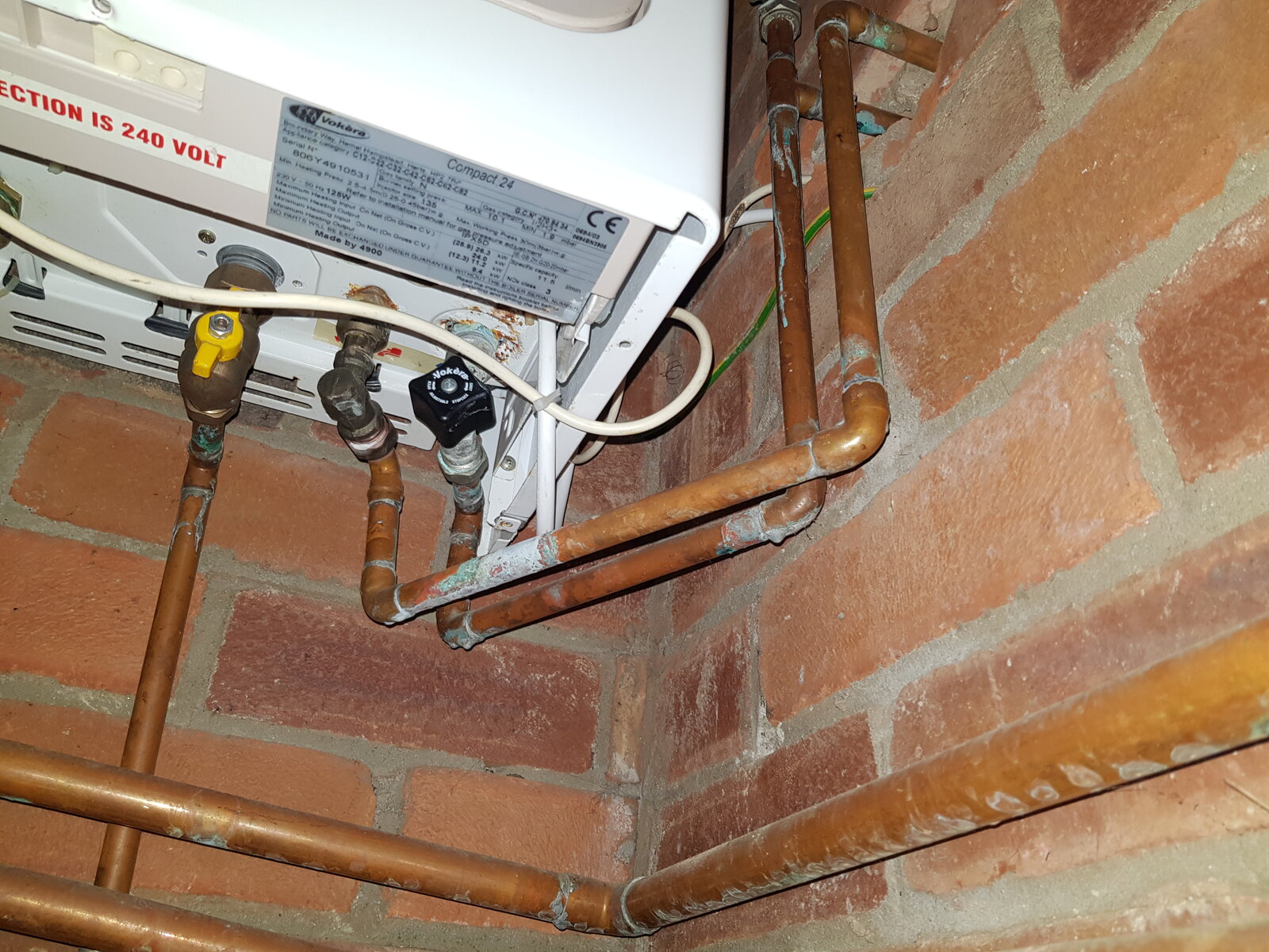

I was planning on fitting in the boiler cupboard, but it is quite tight. Looking at cutting a section of the piping out for the cold mains feed to the DHW input on the boiler. Cleaning it up and trying to get BOTH the Pressure Reducing Valve and Mini Expansion vessel in there. Might have to put the PRV on the vertical section and the Mini Expansion Vessel on the horizontal section just below the black flow control knob.

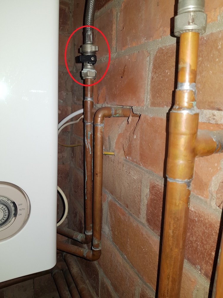

Ok, thanks. I can't access the area around the mains stop cock to fit a pressure reducing valve there as suggested by @Gasguru , I am also concerned that if I fitted it just after the stop cock it would affect for example my garden hose etc. The piping for which is all behind a kitchen cabinet.
I could however fit it just before the cold DHW feed to the boiler along with the mini expansion vessel (I assume in the following order on the cold feed: Pressure Reducing Valve > Mini Expansion Vessel > Boiler DHW Cold Input).

Thanks everyone. Just tested the pressure at just after midnight and still 5 bar. Got someone to run a tap and shut it off quickly and the pressure quickly spiked at 7 bars before the gauge settled back to 5 bar a few seconds later. I assume it is these spikes that a mini expansion vessel absorbs.
I am thinking the simplest thing would be to remove the compression fitting used for the central heating filling loop on the mains cold supply to the boilers DHW inlet as circled in red in the photo. Replace this with a 15mm to 15mm Tee that also has a 1/2 female connector for the mini expansion vessel. Then a small length of 15mm copper pipe coming out the tee and re-instate the filling loop connector. I think this is easiest and from what I can ascertain there the mini expansion vessel doesn't have to be in the line of water flow, it just needs to absorb the temporary expansion (spike in pressure). From what I read you inflate the mini expansion vessel to your water pressure plus half a bar so that it only comes into effect when the pressure rises over half a bar more than your designated pressure.
