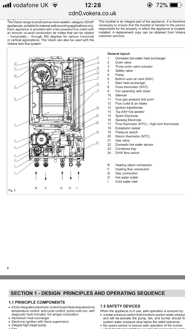

Are you referring to the three way valve beneath the pump?
Neither. Possibly a blocked plate heat exchanger. Set the boiler for heating and hot water then run the hot water and watch the display. When running hot turn the three way isolating cock below the boiler to off as quickly as possible while watching the display. The display will change from showing the DHW temperature to the primary flow temperature. If this rises quickly to over 82-85 degrees = blocked plate.
Not often I disagree with @vulcancontinental but I have never seen the three way valve on a vision, all the ones I have seen just have the water throttle shut off cock
That's weird Ian, I've never seen the throttle type valve on a vision. It's always been the 3 way type.
