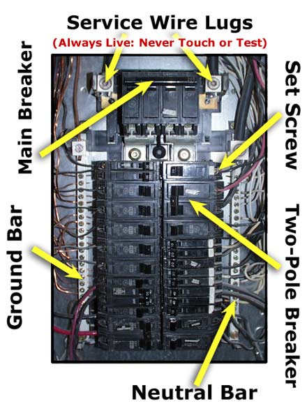

FWL_Engineer said:
My personal feelings about these is that they are sh*te. I would stop them manufacturing consumer units and circuit protection equipment if it was my choice.
If I remember correctly you said that when you worked in the US you didn't do domestic?
Compare this to Wylex:
