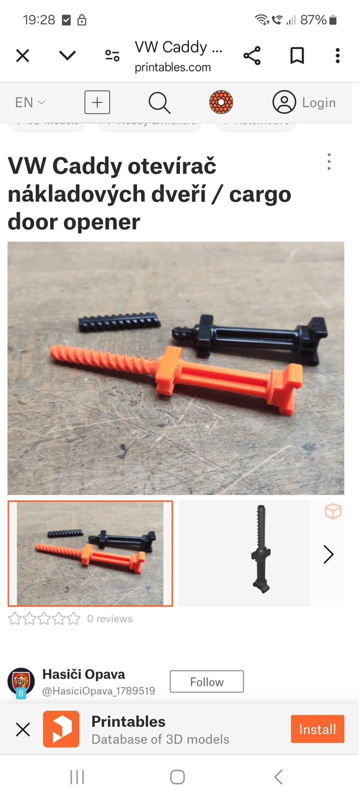

To replace the actuator I would have to buy the whole mechanism £350 plus postage from somewhere on the continent.
Today I rang a 3D Printing company, they helped me find the file on line they could use to print the actuator, actuator printed, I fitted it in the mechanism, bobs your uncle the lock is fixed...Cost me £40
