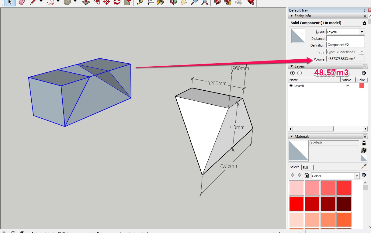

sketchup, which will tell you the volume
Already started that to check my maths (note that I corrected my mistake in that I only added on one side). :<
Shows 17m³
Hang on. The triangle is double the base so doesn't need to be halved. So I'm going back to 21m³

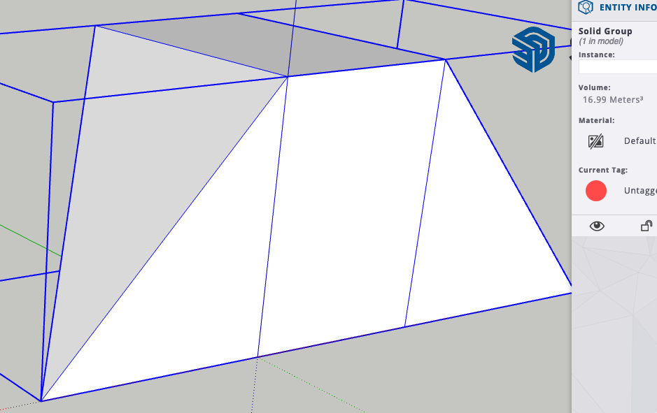

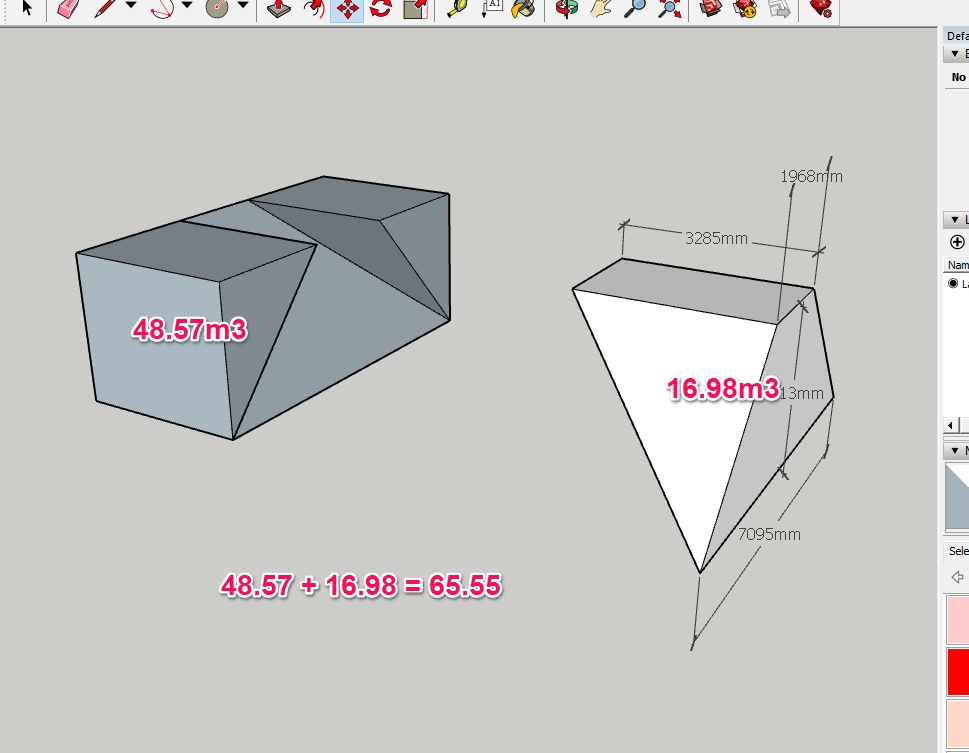

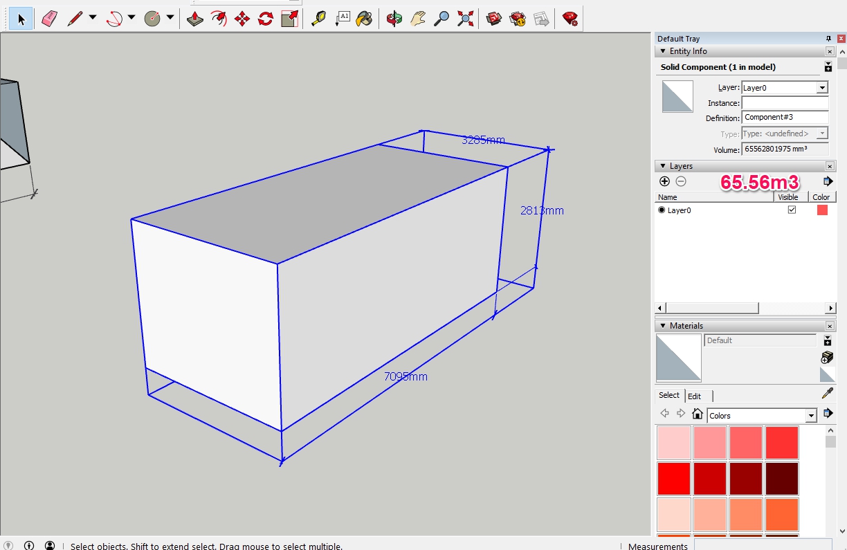

It's just half a cuboid plus 2 triangular-based pyramids.
  • Handwritten_2021-09-06_120550(1).pdf
Presumably this is concerned with Permitted Development rights?
FMT's figure of 16.9 m³ is correct, but OP should not go to the trouble of trying to prove this to the council.
