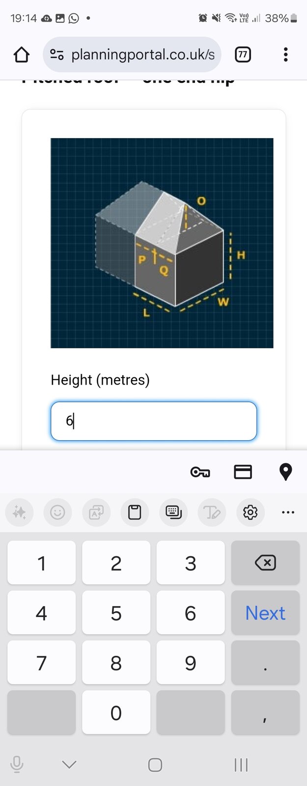

What measurements do P and Q relate to
P is the length of the ridge but you shouldn't need that figure for a hip to gable.
Q is the length of the hipped section of roof.
There are 2 calculations for the hip to gable volume, using the strange annotations on that drawing -
(O x Q x W)/6 or 1/3 ( Base x Height) Where Base = ½ (O x W) and Height = Q Both using the external dimensions.
EDIT: Sorry I made a mistake, the letters on that drawing are really confusing, now corrected.
EDIT 2 in red

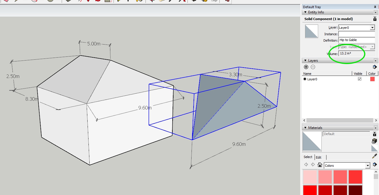

my measurements are
house width 8300mm
house depth 9600mm
house ridge length 5000mm
house hip to (outside of proposed gable wall) 3.3m
internally in the loft the height from top of 1st floor ceiling joists to ridge is 2.5m
im looking for an online calculator to try work this out, would I need any other measurements
I make it 13.2m³
I spotted another mistake on my previous formula, it should be 1/3 (Base x Height) not ½
EDIT: Great minds think alike!
EDIT 2: It makes you wonder what the hell this so called "architect" is doing?
