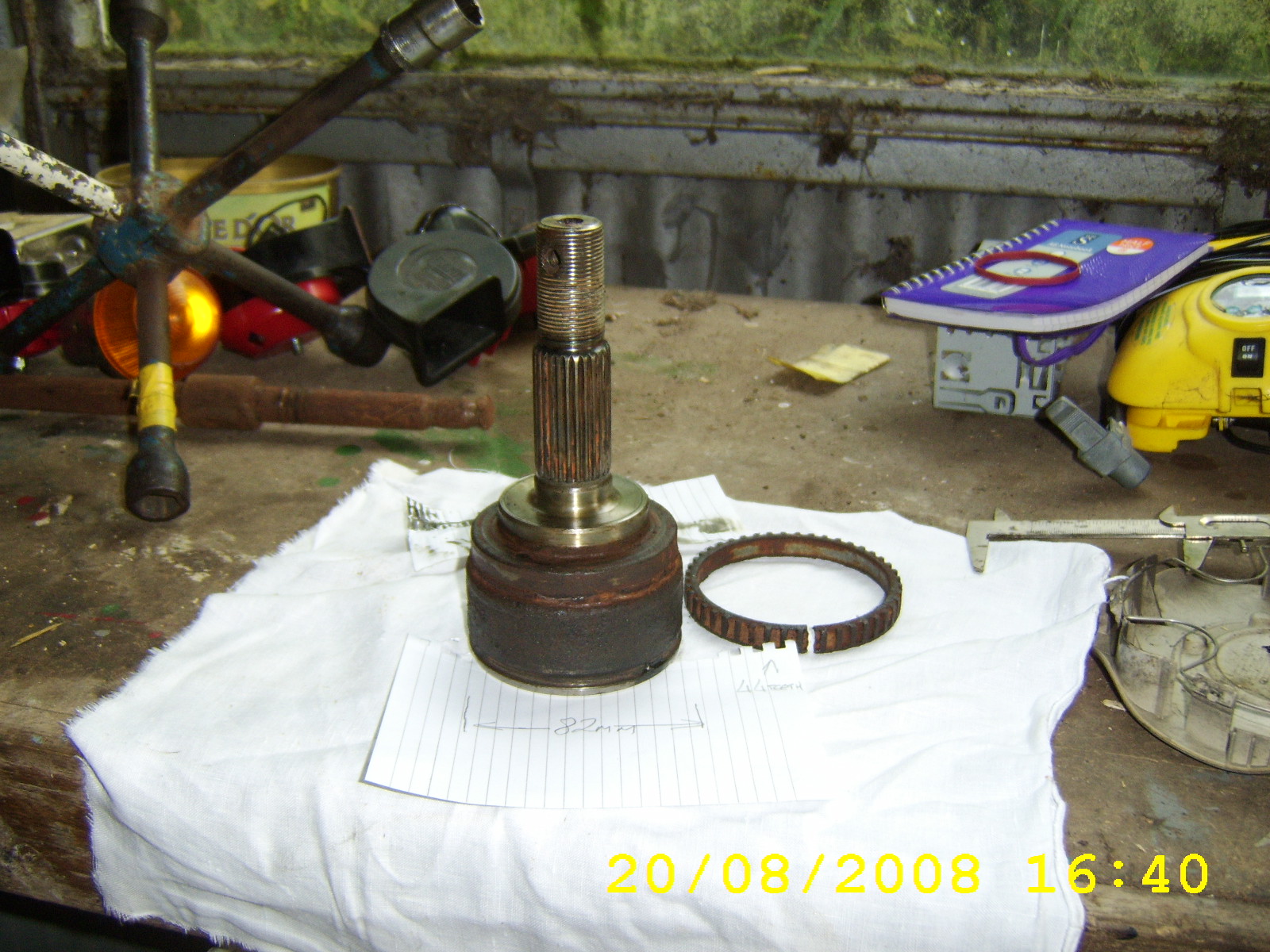

I've had ABS deploying under normal braking, it was a 2001 Primera with a split reluctor. Because of the location of the reluctor and the fact that there was a bit of corrosion, it was very
difficult to see until the hub was pulled of the shaft. I can't believe that I still have the picture after 12 years.
Same here Stivino with a Rover 45TD. Early on when I got the car, the ABS was deploying all the time. First port of call was to an auto sparky for a system check but all was clear. He said it must be the rings. I looked, saw both the front were split, got new ones, fitted them and all was well.
