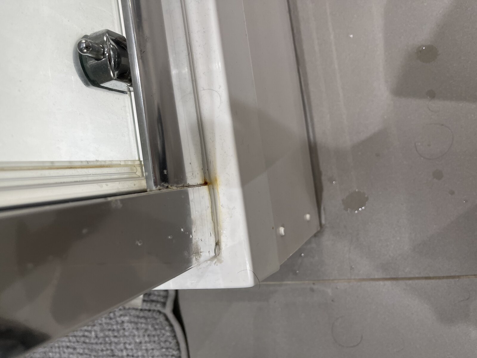

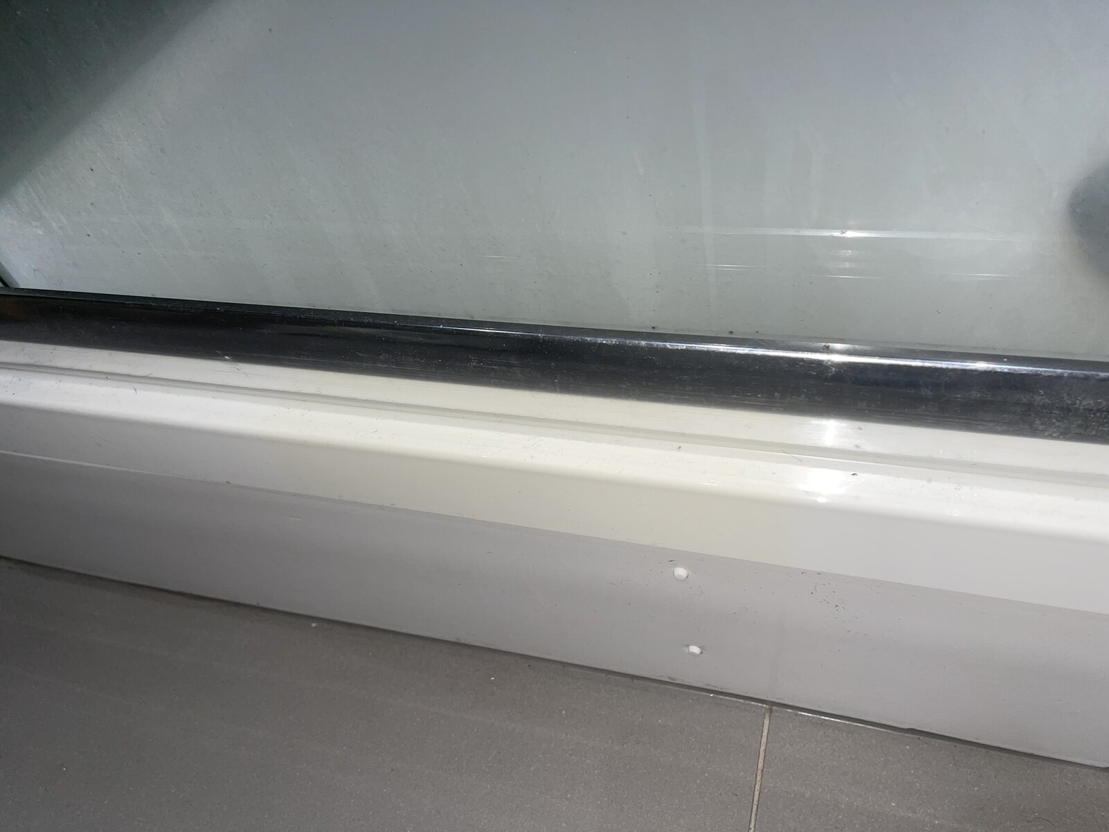

Hi there. How come part of my walk in shower base has got a yellow stain on it. Is the material that was used on it cheap? Also the same yellow stain is on my toilet seat
some white plastics do go yellow, and I don't believe there is anything you can do about it. Sometimes sunlight accelerates it.
Bleach can cause yellow stain. That's probably the cause on the WC seat.
So can cigarette smoke, though unlikely in a shower.
the mark at the bottom of the shower door might be a rust stain, from screws used on assembly. BZP will rust if kept damp. If you can get a pure phosphoric acid rust remover (Jenolite liquid used to be, but I believe is discontinued) and tape cotton wool or kitchen roll against the stain, wetted with acid, it will clean it off. But you will also need to remove the rusty screws and replace with stainless.
I have attached pictures. There is also rust coming out from the corner.

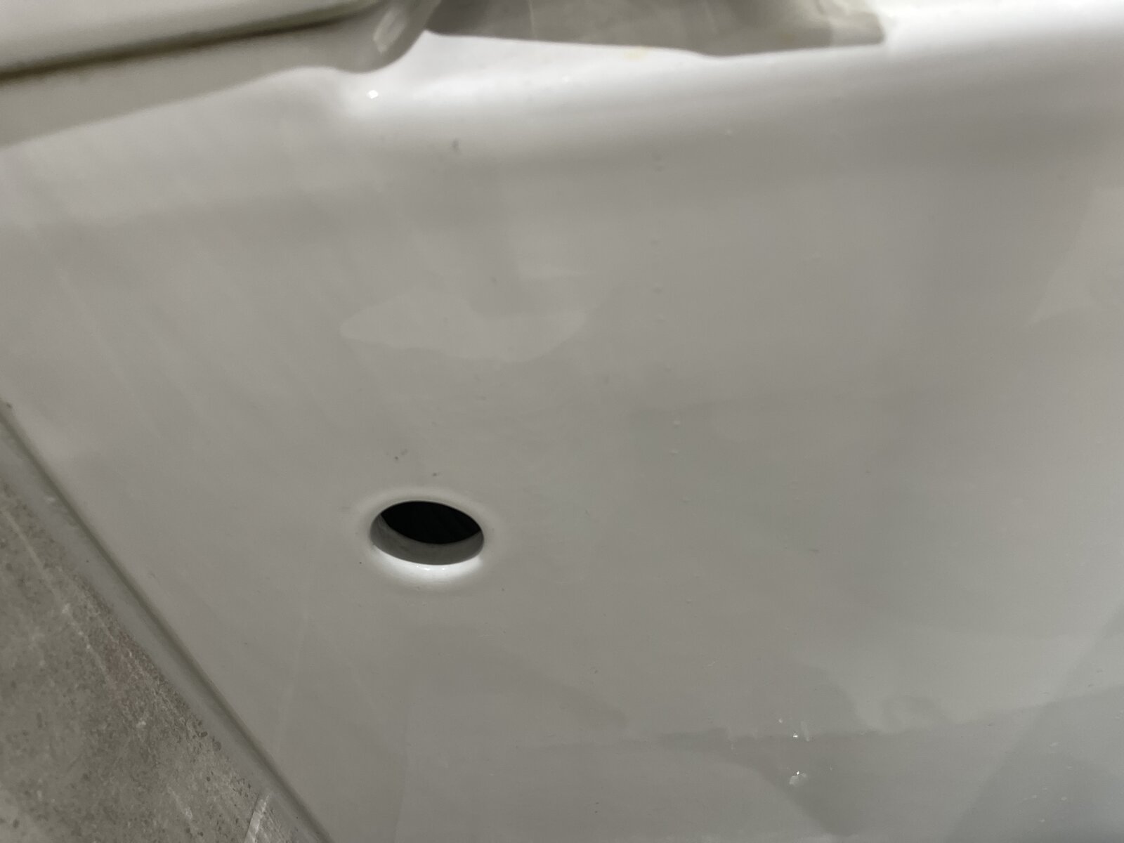

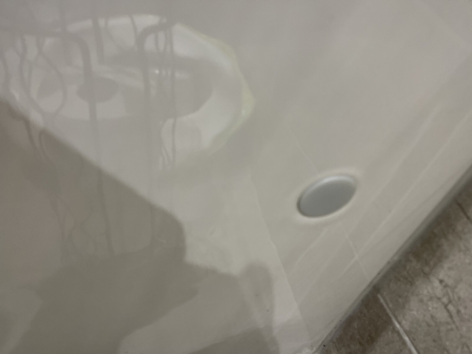

What are these holes for on my toilet on the side? One side is open and the other side there is a plastic cover on it. Its strange
...the mark at the bottom of the shower door might be a rust stain, from screws used on assembly. BZP will rust if kept damp. If you can get a pure phosphoric acid rust remover (Jenolite liquid used to be, but I believe is discontinued) and tape cotton wool or kitchen roll against the stain, wetted with acid, it will clean it off. But you will also need to remove the rusty screws and replace with stainless.
I had a look on ebay, and there are a number of people selling phosphoric acid, possibly for use on food equipment.
