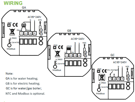

I'm rewiring an extension. having 4 x 3kw panel heaters. individually wired to the consumer unit.
the customer wants an independent timer/stat on the wall to turn all 4 heaters on and off.
Is this possible will be drawing 52amps?? or please advice if this can be done via contactor?
A contactor could be used, but a better option would be heaters designed to be linked together and work with external controls.

The lower the droop the more switching is required, and I know with commercial heaters the contactors had a very short life when trying to maintain temperature within a small range, and we had to move to semi-conductor type contactors and of course semi-conductor fuses to stop the contactors burning out.
But type of heater matters, the whole idea of the oil filled radiator is the switching can be less frequent and still maintain an output. One does not want to let heaters get cold, as then the thermals stop, unless using a fan of some type.
There are thermostats which have versions for electric heating 1710060548712.png The BTH 002 series do one for electric heating rated at 16 amp, I am sure there are others, in the main designed for under floor heating, but often they don't need to use the sensor. The problem arises when replaced with wrong version. But as said it depends on switching rate, the under floor heating mats store even more heat to the oil filled radiators, so the switching is not that frequent.
So room design and heater type will change what control devices will work.
