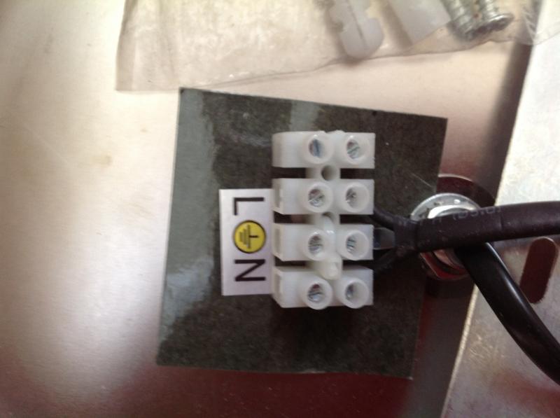

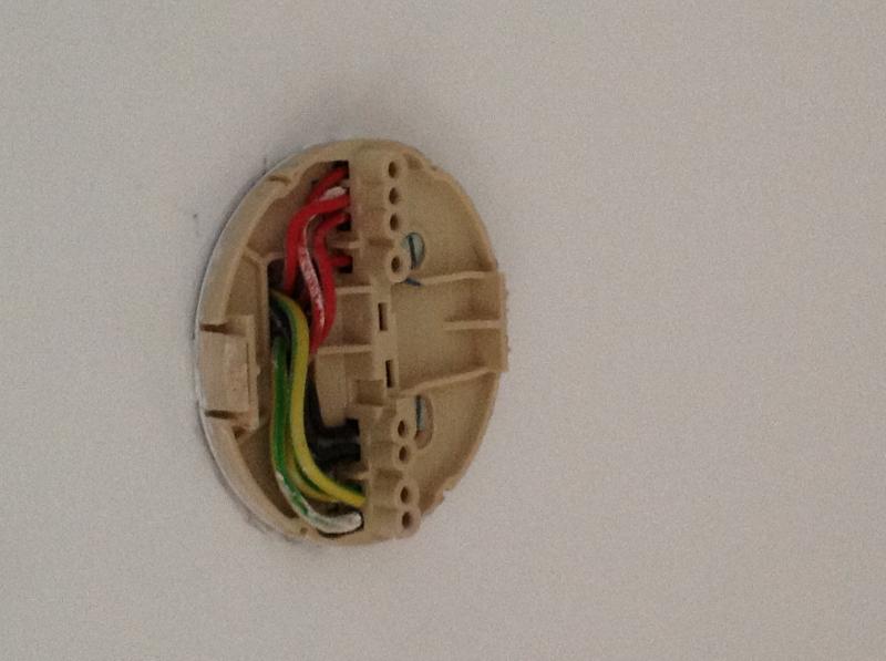

Hi, help to go from old ceiling rose to new light fitting. Have not got any testers, where do the wires go in the new box?. Many thanks.

Notice on the old ceiling rose the red wire nearest the centre is separate to the other three red wires.
The red wire on it's own goes to the L terminal.
The blacks go to the N terminal.
The remaining group of reds go to the empty unmarked terminal.
The green and yellow earth wires go to the earth terminal which is marked with the earth symbol.
Make a very careful note of how each cable is connected at the moment in case there is a mix up. If you study the wiring carefully, you will realise you are simply copying it.

The red which is on it's own as talked about before (lowest red one in the pic) goes to the L terminal on your new fitting.
The other four reds to the terminal without anything else connected to it.
The three blacks to neutral terminal.
All the earths to the earth terminal. (edit - Can't see if there's three or four, at a guess there should be four)
I would advise you to have some sort of tester to make sure the power is off before you start work.
As said above. Hard to count how many wires they are. But keep that red on it's own separate!
