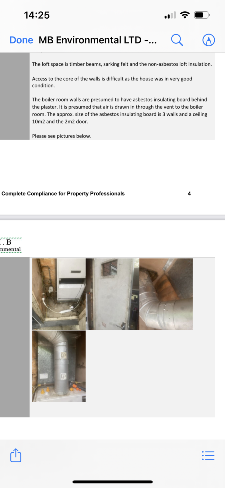

I asked for some clarity on where the visually Identified asbestos is and to me it reads that actually the asbestos is within the cupboard only and not across the whole ducting work which would make things easier as we could have the asbestos removed and then just block in all the ducting and leave it where it is and get a new heating system put in. We can always have the ducting in the loft removed if we wanted at some point.
See picture for section of the report that adds more detail as to where asbestos is and also some pictures they hadn’t put on the original report.
Im afraid the survey you paid for could have been written by someone reading a book, your flue is not asbestos, you have no asbestos in your attic that has anything to do with the heating, I have installed and worked on many hundreds of WAUs and never have I heard of asbestos sheeting behind plaster, many compartments are asbestos lined , but this is simply cutting asbestos boards and lining the cupboard enclosure befor the WAU is then installed, none of the ducting will be asbestos
Yes the ducting isn’t asbestos and it’s only confirmed in the door (from testing). I just meant. Getting the ducting taken out at some point so it’s not just dead weight and taking up space that could be used for storage.
No there are some ducts I’m assuming in the loft space as the vents for the warm air system are in the ceilings upstairs rather than the floors. There will be a flue but I don’t think that’s asbestos.
Neither the flue or the ducts are asbestos, only the enclosure , so remove it if you want , the enclosure lining is a different thing, if that has been confirmed as asbestos , that needs to be removed and disposed of properly, you cant DIY it
