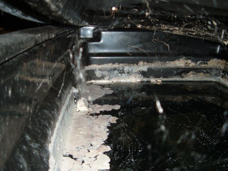

we clean our teeth with the cold water from the bathroom tap....This morning I turn on the cold tap in the bathroom (which gets its feed from the cold water storage tank in the loft not from the mains)
So you are cleaning your teeth with water that has been stored in a tank in the loft :eek: Unless it's a relatively new property with a Water Bylaw 30 kit installed, I wouldn't like the sound (or should I say taste) of that.
for 47 years of me life have always washed my teeth from water from the cold storage tank up in the loft which goes to basin in the bathroom - we have only ever had cold mains at the kitchen sinks in all the houses i have lived in - yeah but admittedly there are dead flies and scum and god knows what else in the tank up in the tank up in the loft when I've been up there and had a look inside em! :)
