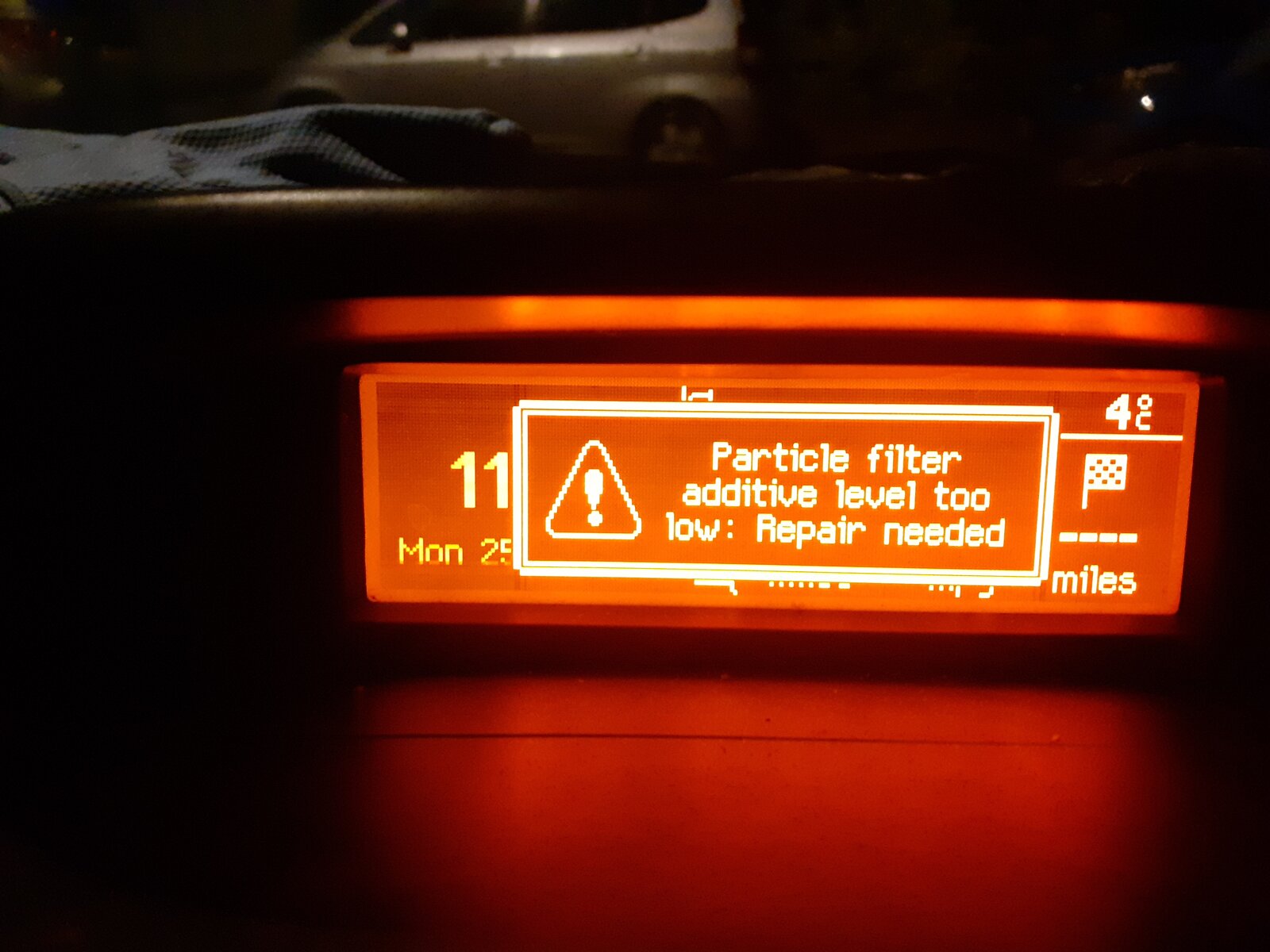

Warning flashing up on car screen

So gotta drive for 30 mins. Is this serious?

Both yesterday and today been getting this flash up when start van upView attachment 267363
You can continue to drive, but if you run out of additive (which is not add blue) then the DPF (diesel particulate filter) will clog up and the engine won't run.
It's much cheaper to get the fluid topped up (i believe this is a dealer job) than replace the DPF when it gets clogged and the engine won't run.
If you've only just started getting the warning, you're probably ok for 500 miles or so.

I'll call Peugeot or my mechanic and get it sorted next week, don't wanna have to replace DPF

The car may use Eolys or adblue.....if it’s a blue line engine then its adblue you need. You must have the correct one!

Only the Eolys stuff - adblue can be filled to the tank by anyone. As an example, consider using 1 litre of adblue per thousand miles......Eolys one tankful every 70,000 miles maybe.
Eolys is claimed to be highly toxic, but I haven't a clue about that one! Both have a shelf life.
The Eolys fluid often comes in it's own tank where it it is introduced to the fuel by a graduated amount - access isn't good and the delivery method has to be reset.
I have come across a vehicle where the Eolys was in it's own pouch...a Peugeot I think but I can't remember which model that was. The pouch was starting to degrade though!

2013 Peugeot expert van. Thought the bloke on phone said ad blue, but if sign says needs repair should get it looked at. Trying to book it in next week with mechanic
