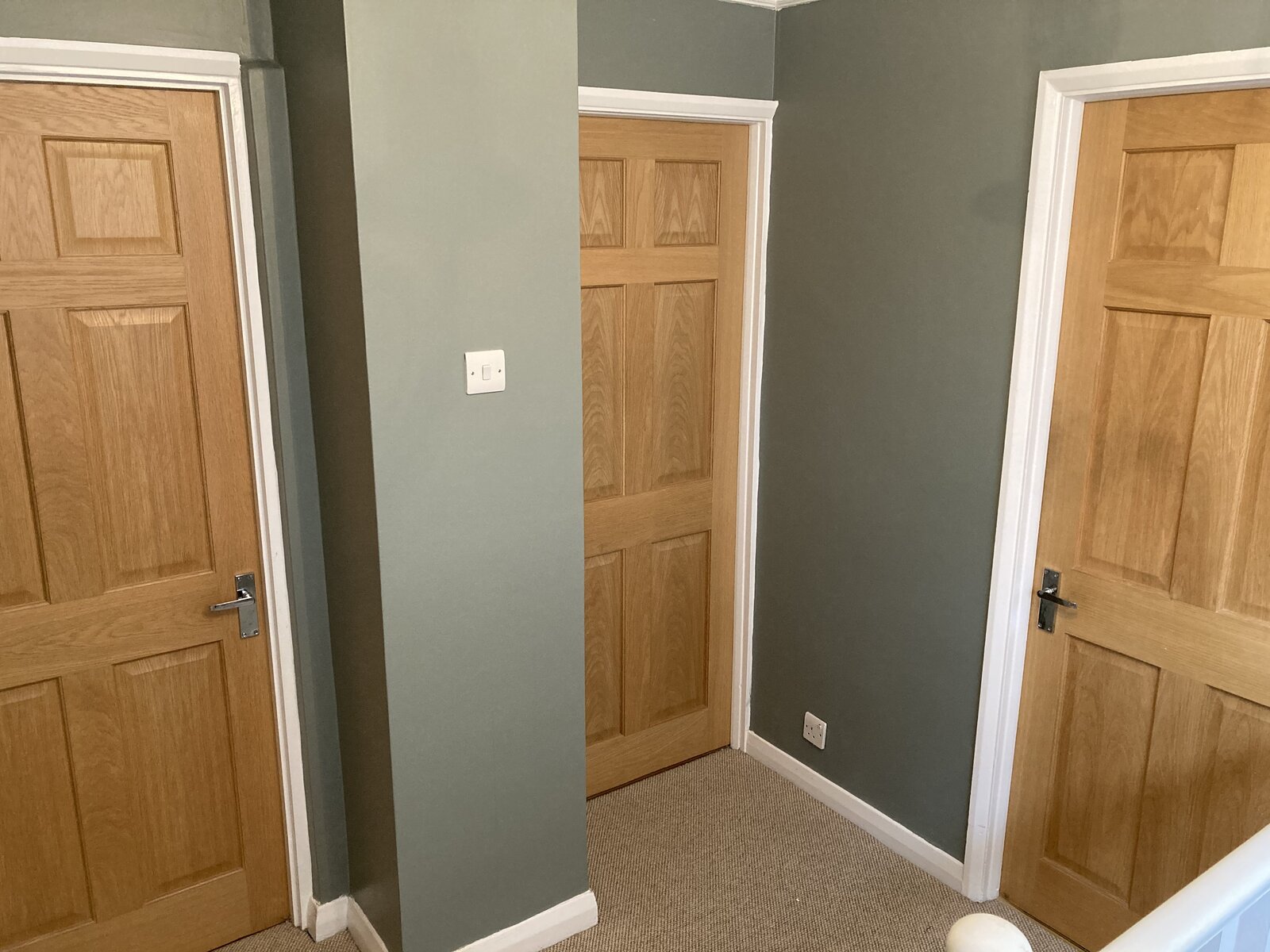

I took away the bottom of my chimney in the ground floor. I also took the section that went from the upstairs ceiling, through the loft and out of the roof. Just left the middle bit hanging in the landing. It was on,y for tge original floor mounted boiler tgat was originally fitted in the kitchen. It’s been there for 30 years so far. Will I have trouble if and when I come to sell?
