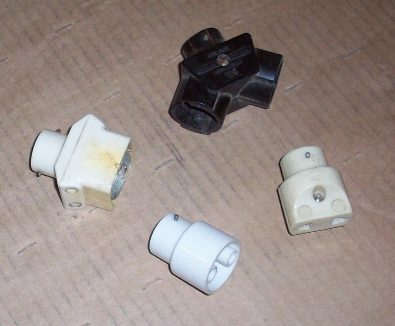

The www.flameport.com website shown on the above fitting has some wonderful electrical apparatus from yesteryear
That 2-way adapter has the switch on the inline socket, the one with the screwed shank for a fitted lamp-shade. The branch socket was permanently live - after all you wouldn't want to switch your iron off or on - just unplug the lead when finished.

The one on the left (this specimen clearly 'well used'!) is the type I remember most - you could have two irons and still have a bulb as well!

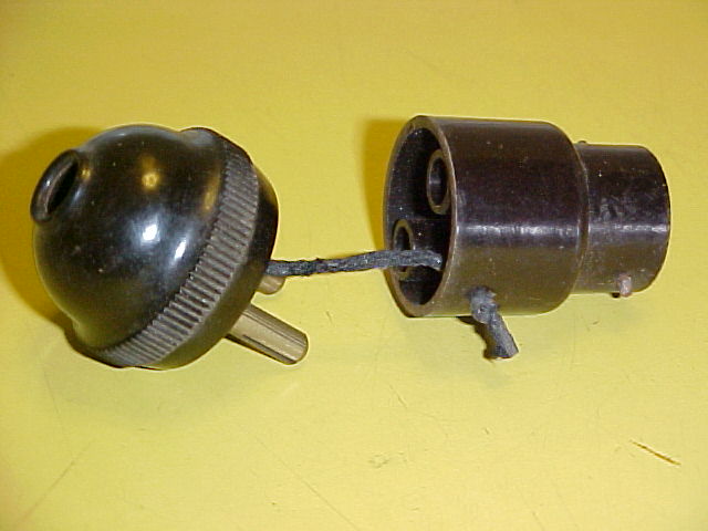

There were BC/2-pin adapters sold as a combination with the adapter tethered, to enable easy use in a regular 2-pin 5A socket or in a BC lampholder:

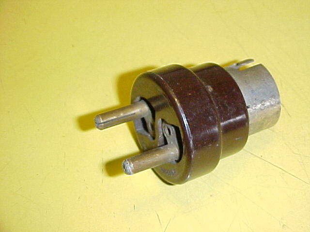

And then for items which had already been fitted with a BC plug, there was the reverse adapter to allow use in a regular 5A socket. This particular one has adjustable pins so that it would fit in either a 2-pin or a 3-pin socket:
