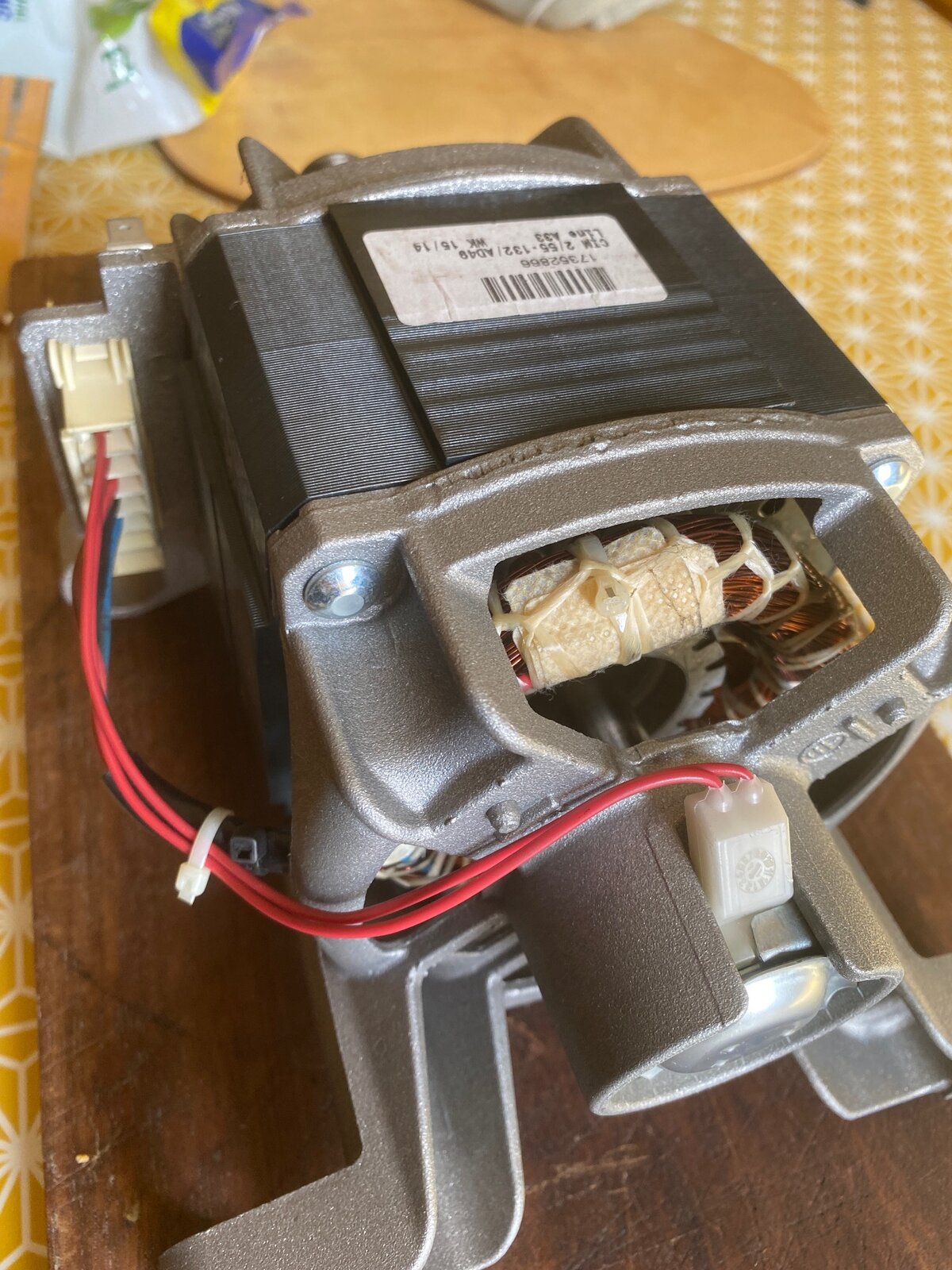

I suspect the 2 red wires go to the sensor, try disconnect the plug at the motor.
When w
The 2 red on the motor? The clip itself on the end is moulded and not detachable.

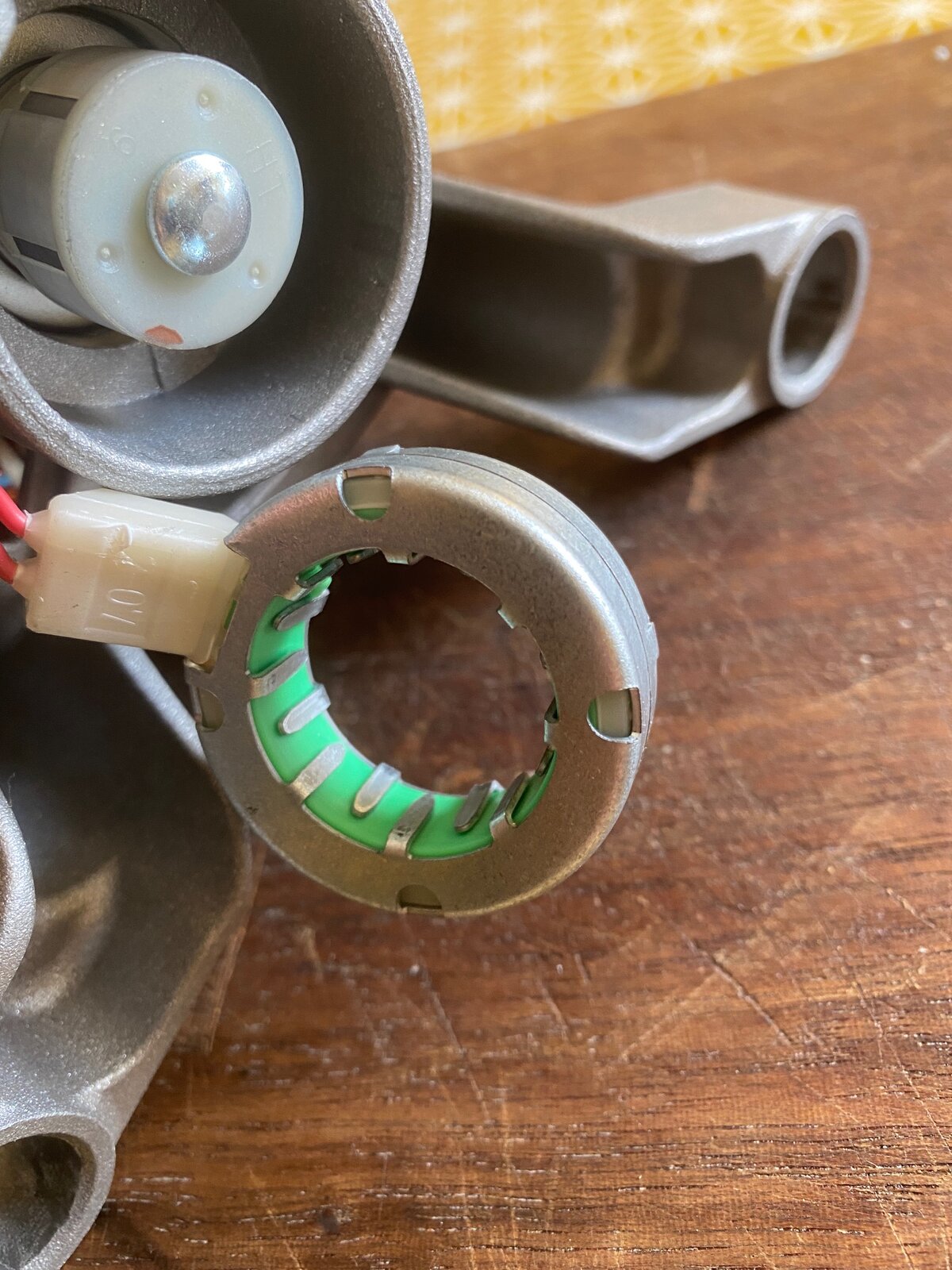

Just googled it and it seems that is the tacho coil on the end with the 2 red wires going to it. I will take that off
this part is speed sensor I believe - will give machine a go later with this disconnected. (although a faulty one of these wouldn't make me think it would short circuit, it would just not change drum speeds? But having said that, my knowledge is very very limited)
I suspect you are probably correct, it probably just generates pulses that can be measured by the pcb. so unlikely to be supplied with mains voltage. You asked if you could test the coils with a multi meter & a resistance test on each of the other 3 wires to the motor body will rule out a short to earth. You should get a reading between pairs of the other 3 wires across the coils though again not sure what sort of reading you should get, not a short circuit though. Perhaps as you say one of the many vids on youtube will provide those sort of answers.
The motor gives good readings, as does the tacho/speed sensor, no shorts.
So, guessing pcb , which almost certainly rules out a fix from me, and in terms of costs it doesn't make it an attractive option.
