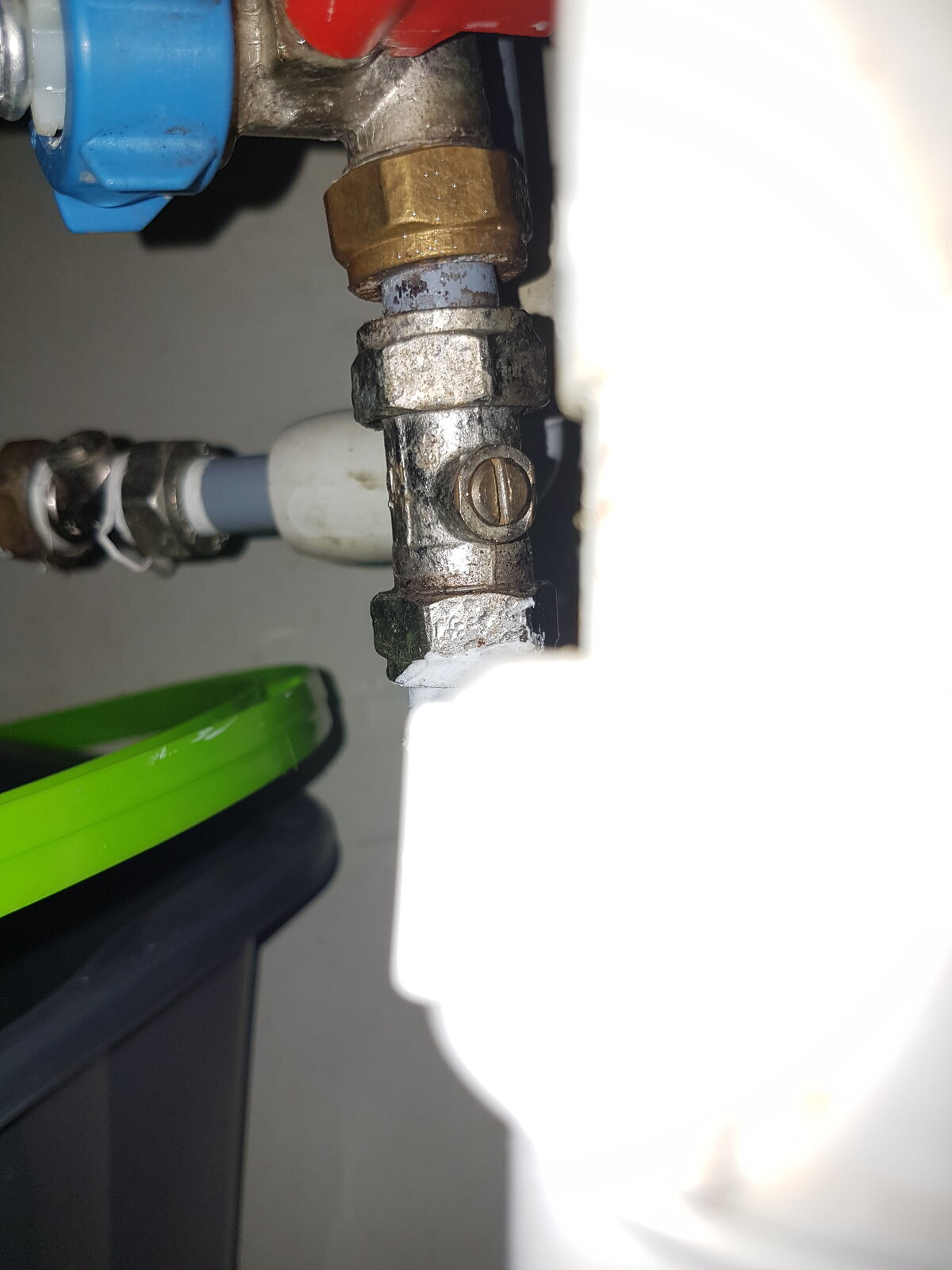

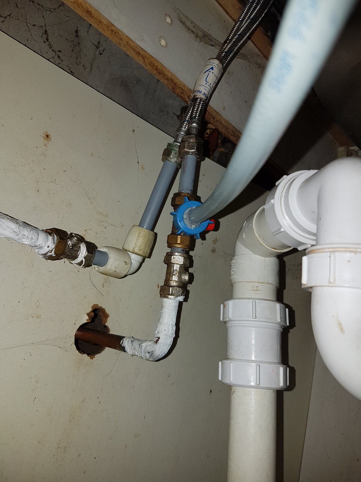

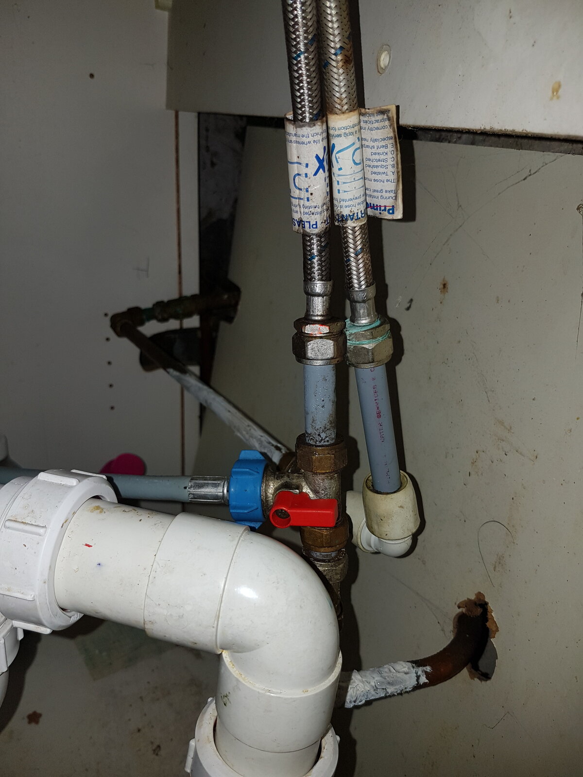

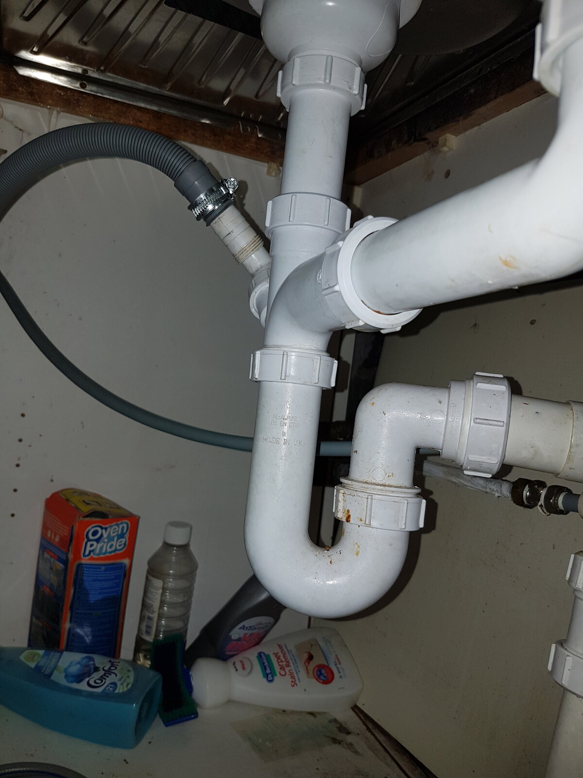

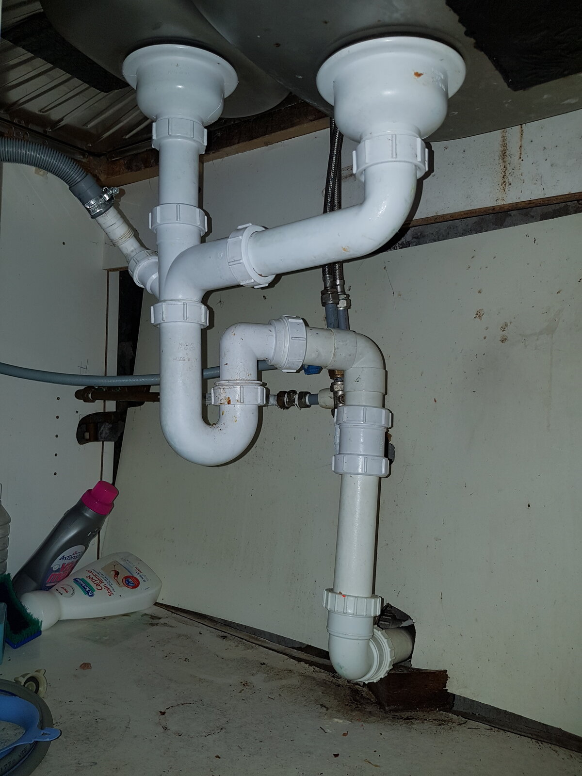

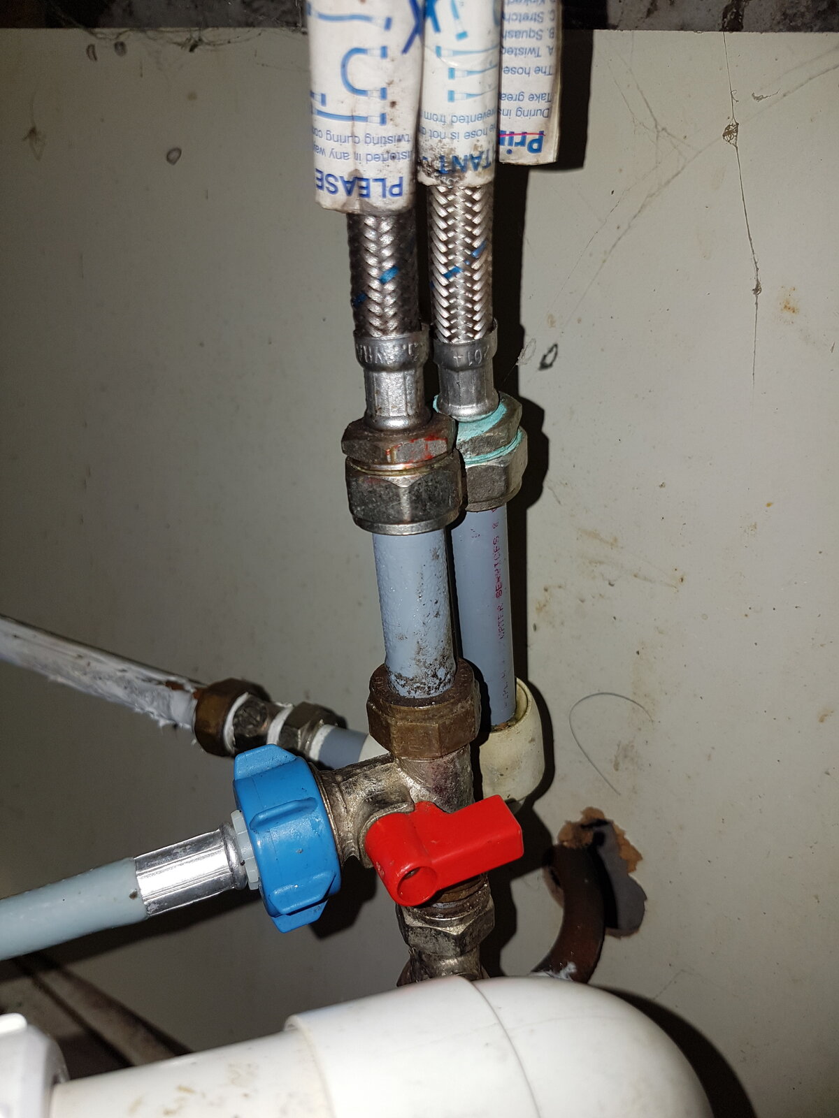

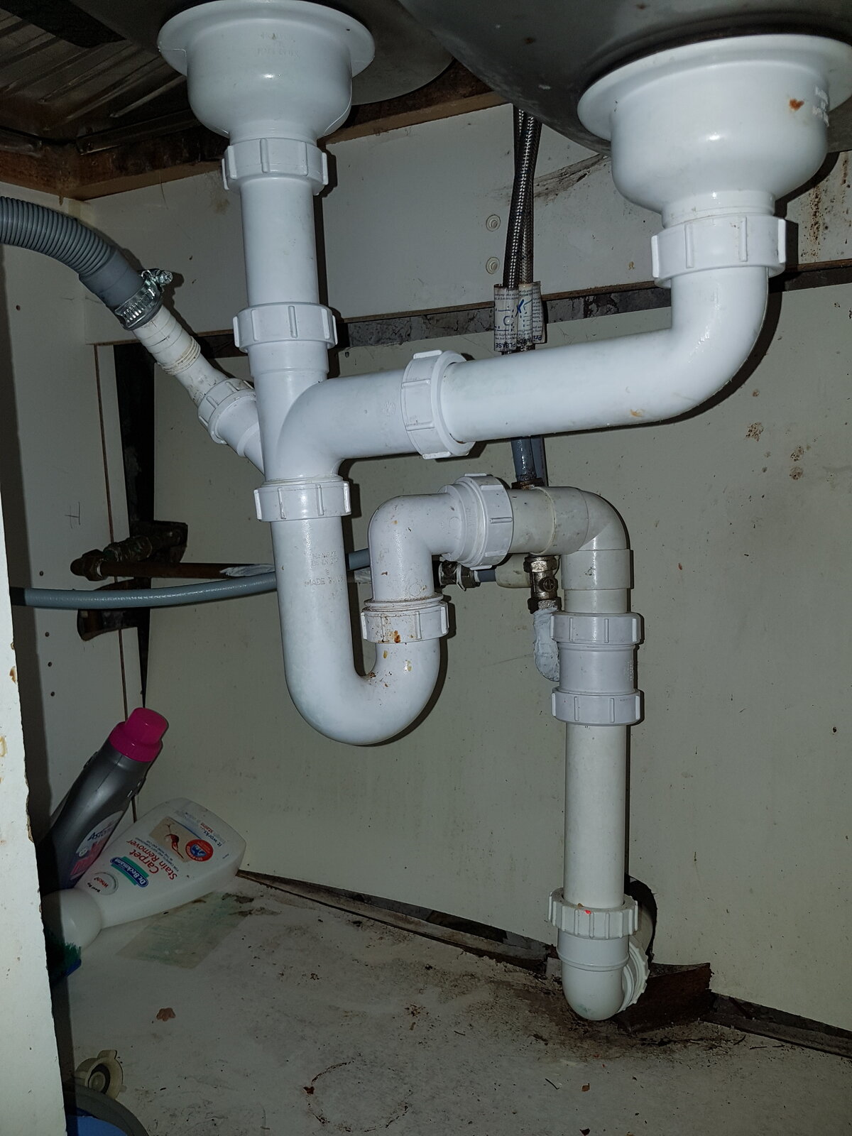

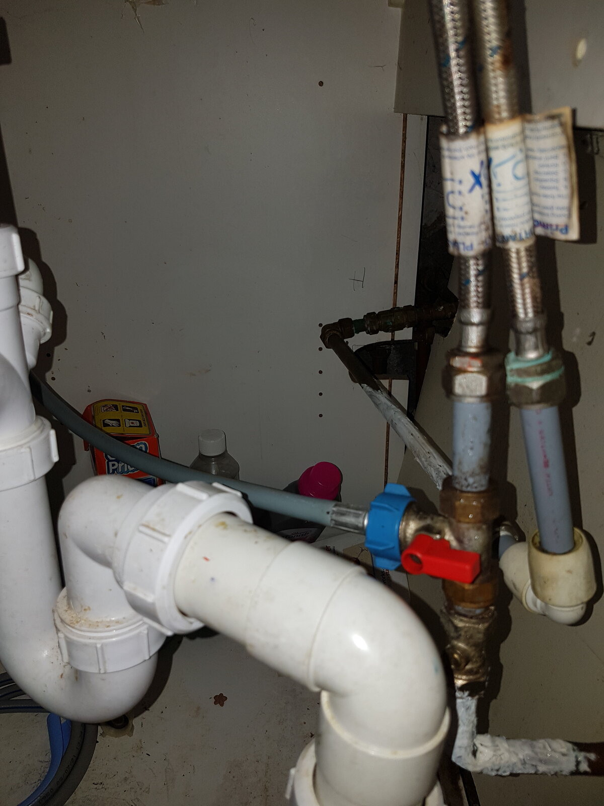

Here's the pics under kitchen sick also showing the connections to the washing machine.
There is an isolator valve (chromed) just below were the washer T's into that copper pipe, the screw you can see is to turn it on and off. Is the slot in the screw vertical? It should be for maximum flow.#

Do you mean If the the red lever is vertical? The red lever only goes either vertical downwards cloxkwise which I thought it meant the water to washer was turned off or as it is right now which is horizontal which I presumed means the water supply to the washer is fully on as this is the position it's always been and how the installers left it. The installer said "where's your cold water for your washer? Ohh this is it, it's a red lever rather than a blue lever for the cold"
The red lever position is fine as in the photo, no below that is an isolator which turns water off to both machine and kitchen cold supply. Look at that, there is a screw for a flat screw driver - the screw slot needs to be set vertical, if it is not already. Horizontal is off, vertical is full on.
