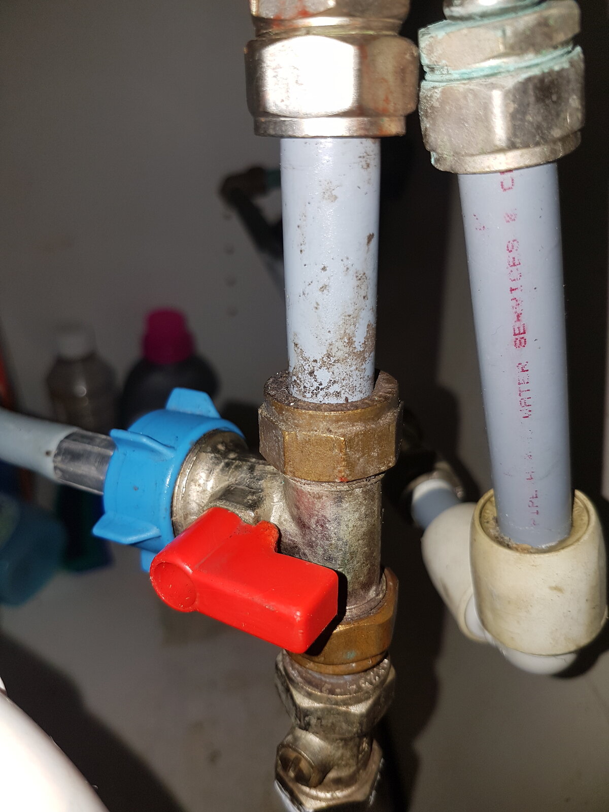

Cold water flow very poor as you can see from pic and no pressure. If I can somehow increase the flow of the cold water coming from this cold tap in kitchen might it stop my washing machine constantly stopping with the error code of not enough water or not enough water pressure?
We have a water tank in the loft.
As it's an old flat, it's probably had many years of poor-quality plumbing work done
Looking under the valve, you'll see a long term leak has left limescale on the pipe, and I think there is an old brass valve there probably constricting the flow.
A good tip is to use better quality full-bore valves, which do not constrict. They are more expensive. Observe that the body is much fatter on these Peglers.
And here is a good-quality washing machine valve.
If you can follow the pipes back, you will probably find a 90-year old iron or lead pipe nailed into a corner, and if you can replumb from there, removing old joints, elbows and valves, there is a good chance you will get better flow. If you are really lucky it will be one-inch iron.

take a closer pic of the valve (?) where the leak is, and any other valves you can find. They may be in cupboards and corners, or in the loft. Look for a main stopcock shaped like this. Note the slope on one side.
It may be that replacing them will do the trick and not a major job. you will not want to pay for a comprehensive replumb of a rental, and the landlord might not care.
If it was me, I think I would pay for a full-bore to replace the leaking one, and ask the plumber to fit it. Otherwise he might just replace with another cheap one.

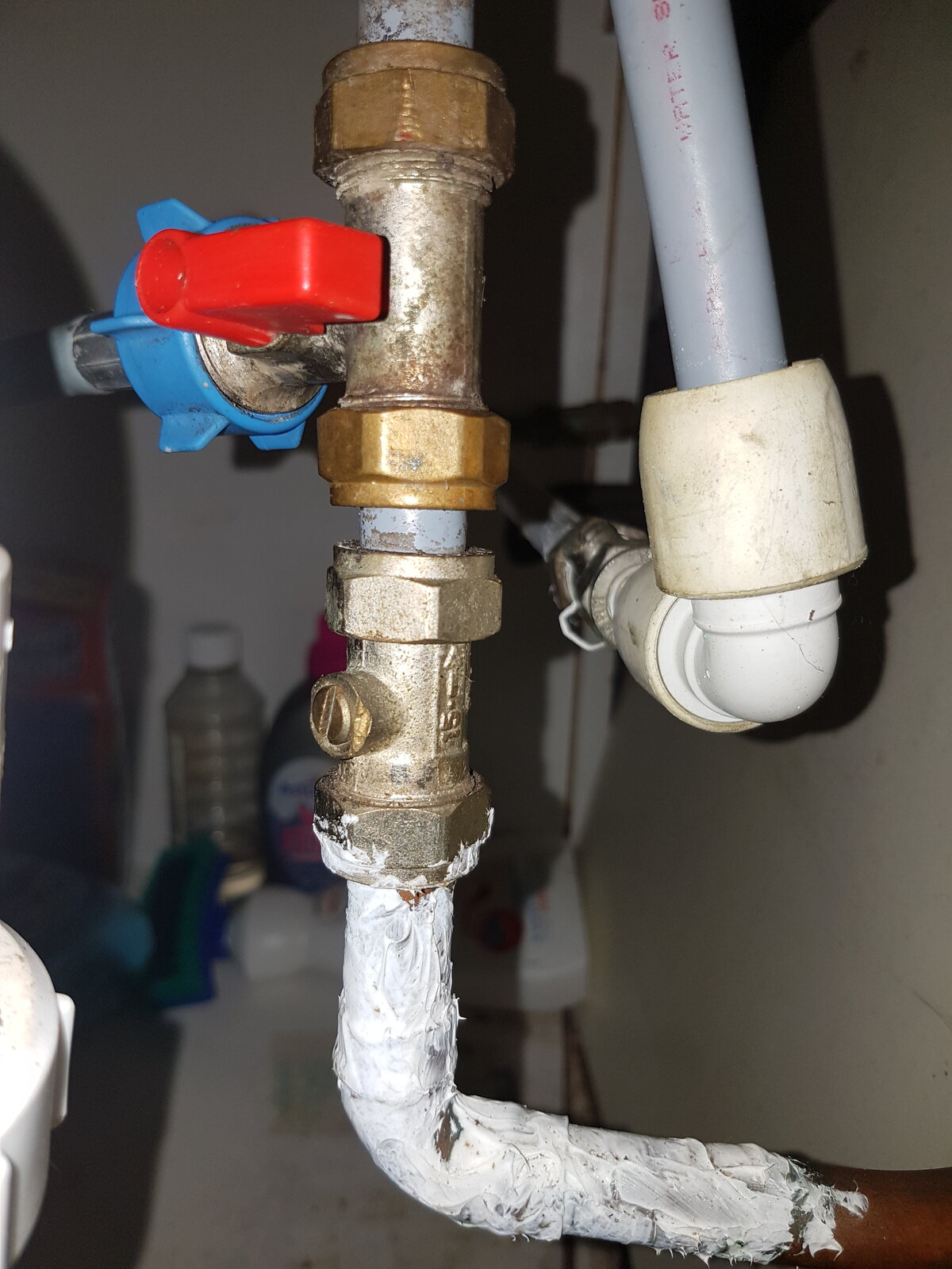

Where do you think the leak is? Under the isolation valve? What colour is the limescale on the pics? The white area on the pipes appears to be some kind of coating applied at some point before I moved in.

It's probably the joint to the copper pipe, but, if it is a valve, it may be the operating spindle worn.
Take some closer pics
Ok I shall take some closer pics in a few mins. I noticed that the pipes are wet? Is this normal? Condensation maybe? Or a sign there's a slow leak?

On the hose connections or, on the connection to the machine itself, there is usually a gauze filter. Unscrew the hoses (with the valves OFF!) and check that some crud hasn't blocked the filter. Also check to see if a pressure reducer has been left in incorrectly (they look like a little red pen top)
Cold pipes will condense water on them, until the match the room temperature. Dry them last thing at night, then check if they are dry next morning.
The white material appears to be white silicone sealant, clumsily applied, presumably a poor quality attempt to repair a leak, not limescale. It is probably still leaking.
The slot in the valve is not quite upright
As expected, it is a poor quality valve, badly fitted.
