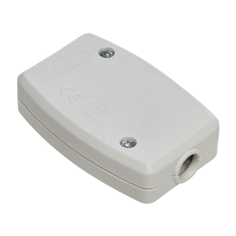

I'm moving the washing machine a few cupboards up so just want a single 4m 13amp extension lead from the single socket so I can still utilise the grid switch. All other electrics are done and in place.
Not sure how hard it would be to add a socket but had trouble getting people over for small jobs.
...the other alternative for a slightly more permanent install, is to use an in-line connector block:
It does mean some DIY wiring, but there are fewer contacts, so less additional resistance, and the cable can be the exact length you need.
