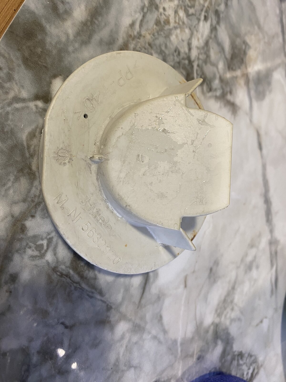

I soaked the part which was caked in limescale in 1 part white vinegar to 2 parts water for around 18 hours and the limescale just brushed off (pic attached). Looking on eBay, most of these parts from used machines had thick limescale on them. I'm not in a hard water area (North West) so the majority of this limescale was likely to be there already. I dont think Calgon going forward will be of much benefit for me.
It's of no benefit to anyone.
While it may extend the life of a machine due to reducing limescale, paying for Calgon every wash over a 3-4 year period is the same as buying a new washing machine.

Will look to use Calgon once the smell from the rubber parts is gone
I wouldn’t waste your money on calgon , washing machines only get tiny amounts of Limescale , never enough to cause failure .
