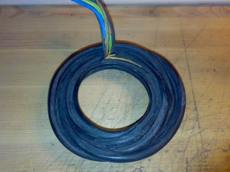

This was from an extension lead that was not overloaded and witch had a thermal cut out on it. Not one of mine i may add it's one that failed a PAT test.
p.s. the pic doesn't quite show what a melted mess it really is.
