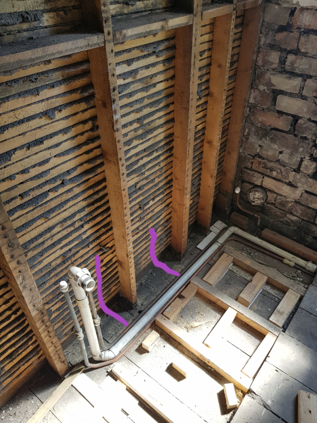

I'm running my water feeds for toilet and sink into the wall cavity. Then I plan to pop them out of the wall to connect. I will be using plastic push fit 15mm pipes inside the wall.
What should I do when coming out of the wall. I guess I will need an isolating valve as soon as it comes through the plasterboard, then Flexi pipes to the Somme and toilet?
But how do you secure these on the plasterboard so they don't move in and out? I was wondering if you can get some sort of grommet for plasterboard and 15mm pipe?
Photo attached, purple lines show the general idea
Try not to put joins in inaccessible areas, couple of years down the line you will be smashing the lath and plaster trying to get to leaks, best practise is to have copper with bends in the wall and soldered joins on the outside of the wall BUT does anyone take any notice... do they f*** :D
My plumber seems to think the speedfit stuff is reliable. I know it's not the same as a copper soldered joint, but I'm doing it myself for the first time! I did uncover some push fit stuff that must be 20 years old, and hasn't slipped or moved. I'll still replace it with new fittings just to be safe!
But what about when coming out of the wall, did you see the last part of my question? This is the bit I need to work out
I normally put a baton between the uprights and then use pipe clips screwed baton to secure pipes.
And then just pop them through and out isolating valves one before going to sinks or toilet etc?

If you are doing it yourself and you cant use copper and solder then push fit is the next best thing I guess. You just need to be very careful that the pipe is prepared properly (deburred/sharp edges removed) and a proper insert used if needed, before pushing into fitting.
Also mark the pipe to ensure the pipe is fully inserted. If it's speedfit then always remember to screw the fitting closed.

@robodelfy, when you then come out of the wall leave enough length so it can bend upwards before the valve and then add a pipe clip at that point then an ISO valve and then add another clip above it so you are clipping and supporting the valve and the pipe above and below.
