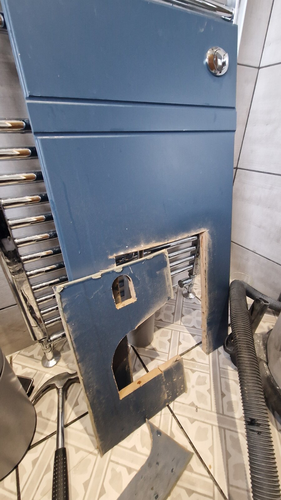

I had a better look behind the toilet yesterday as it's a concealed cistern and it looks like waters originating there. It is pooling in front of the toilet too.
I'll remove the cabinet and get a better look. I imagine it's the water feed pipe not sealing into the toilet bowl. I hope anyway! Easy fix.
Annoyingly when the cabinet was fitted the waste pipe and inlet was fed through holes instead of a slot in the cabinet front. When I changed the cistern it meant getting it as tight as possible blindly, which clearly wasn't that tight.
This time I had to either remove the waste, or cut the cabinet. I cut the cabinet.
Found that the seal for the inlet wasn't in properly and had bunched up on the seal into the toilet. I also was able to get the nuts tighter into the cistern itself.
Did this last night and the floors drying up already so I'm hoping this was the issue!
