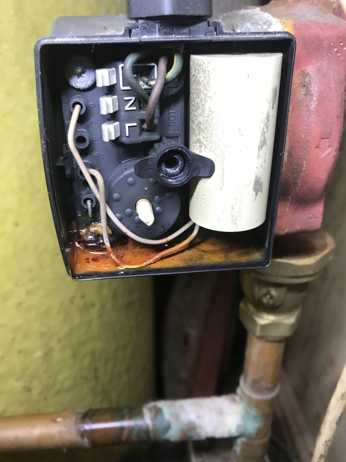

Hey all, few days ago my boiler stopped working, checked it today and found it had blown fuse on the wall, changed it, boiler turns on but shuts down 30 seconds later. I felt the pump to see if it was turning and nothing, opened the screw to check if it’s jammed and it’s not. Thought maybe the pump fuse is also blown, opened the electric housing and a bit of water came out! I’m almost sure there should not be water in here but have a look please as I may be wrong. before getting a boiler guy out is this fixable? Don’t want to get shafted in to a new pump if it can be fixed.
Shouldn't be water in the connection box...how come you had a secondhand boiler pump fitted to an old back casing?
Something's been leaking for a while given the colour on the pipe in the back of that pic and the colour of the water in that box, surprised it's hasn't blown before now.
As @flameport suggest, new pump time.

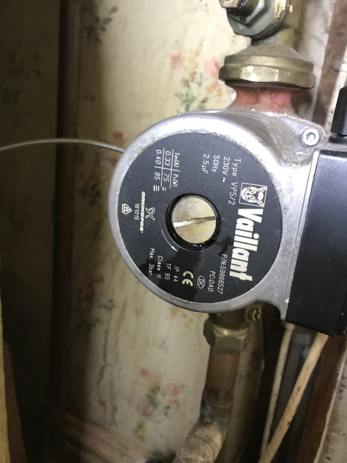

My boiler is an old Glowworm Ultimate 40 FF and the guy that fitted the pump said you can’t get pumps for them anymore or my fittings were different, and the pump was supposedly a reconditioned pump.......
That looks like a head from one that fits into a Vaillant Combi. Looking at it I’d say you just need a new modern Grundfos or similar. The distance between the 2 valves should be 130mm.
All lies.
Your boiler doesn't have a pump in it, your pump is a separate item just connected between two pieces of copper pipe. Boiler is unrelated.
What you have got now is a pump made by Grundfos but branded Vaillant, and would originally have been part of a Vaillant boiler that had the pump inside it.
Theoretically might be reconditioned, rather more likely it was just taken out of an old boiler.
Nah it's impossible to recondition these types of pumps...the parts aren't available.
So many flogging secondhand boiler parts on ebay are now claiming reconditioned.
Standard efficiency pumps haven't been available legally for some time and were initially much more expensive...clearly the cowboy had an old pump on the van.
