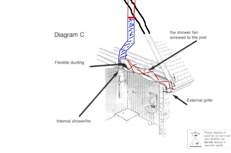

hi i have a similar problem , in couple years i have replaced 3 extractor fans, one just stopped spinning, latest one got condensation on the connected wires, and I'm looking of getting a new fan but thought maybe you can advise me which one etc.
I have inlcuded the image of my situation, as the ducting goes nearly straight above the fan, not at the side of the roof,
this is ex council flat so the loft and roof belongs to the council and can not do any changes,
so there is a three 'chimneys' in my loft , one-my neighbour from below uses, another- from my kitchen chimney, and last one I have connected the shower extractor fan

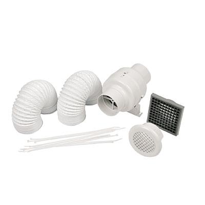

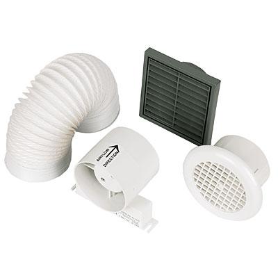

here the fans I'm thinking of choosing from:

if you mean you are getting condensation in that flexi trunk, flop loft insulation over it to stop it getting cold.
I will wrap arount the insulation on Ducting Hose, I will connect 100MM 4” CONDENSATION TRAP, between the hoses, nearer the fan , but maybe somenone could sugget me which fan I should choose:
the cheapest with timer or something like:
the second picture looks like a better one
generally go for a Centrifugal fan if you can afford it, they are quieter and more powerful than equivalent Axial fans

the horizontal trunking route will IMO be less troublesome than putting it through the roof
you say you have a 4meter run now iv never had this prob before but i belive the max duct you should run is 3 meters well so say the manufactures manuals.
Rigid duct is far more efficient than flexi, and also makes trapping condensate easier. You can use a short length of flexi for the final drop through the soffit if needed.
ok, I see, at the momebt I have a rigid duct, so I will get that trap and a a short flexi duct
