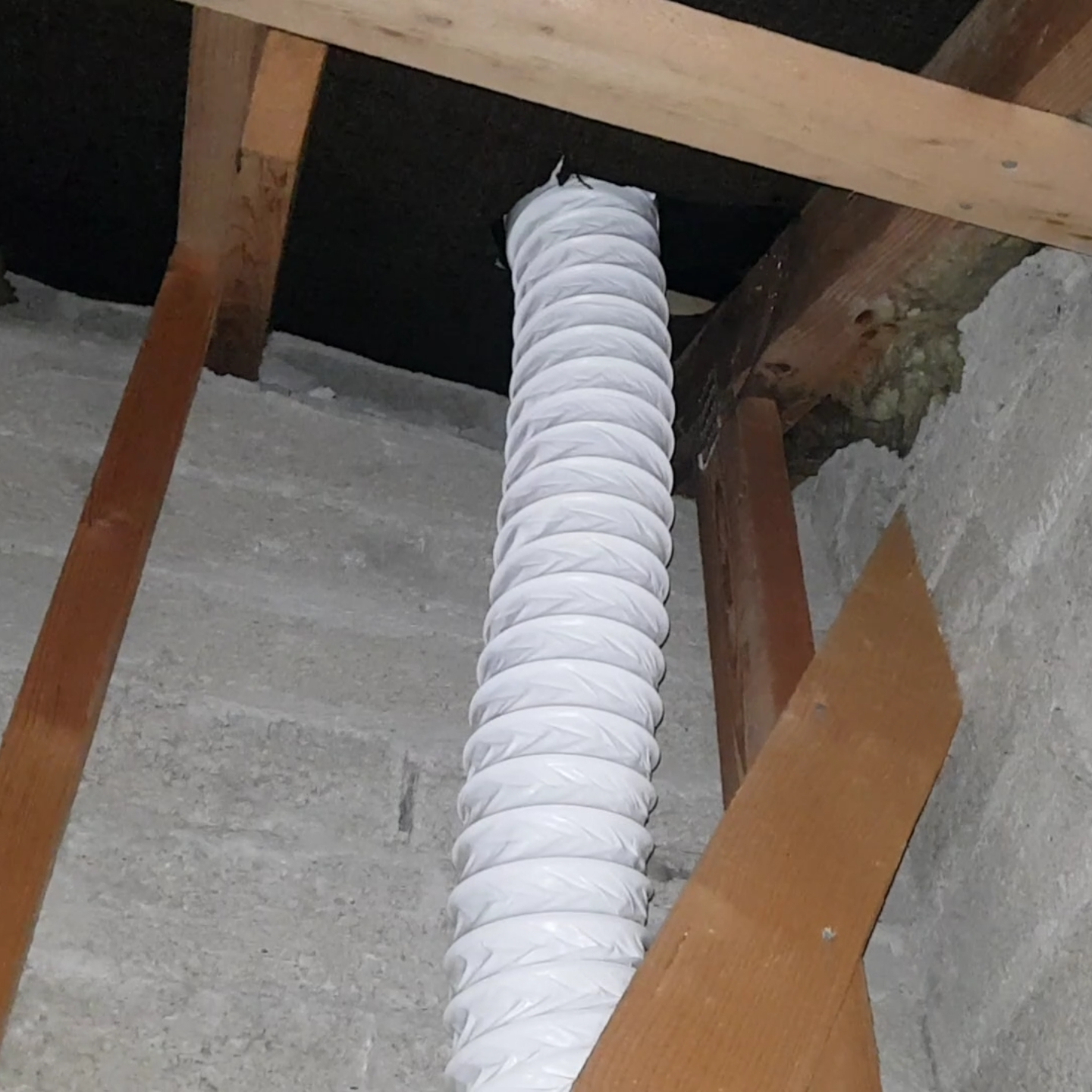

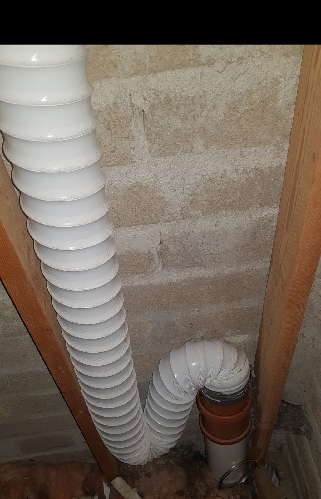

Similar situation, I've got an extractor fan in the ceiling of the ensuite in an apartment. Since winter I've been getting water dripping back down through the fan. I climbed into the roofspace (it's a top floor apartment) and found that the ducting (flexible, sorry) wasn't even connected. It came out of the fan, over a beam and then draped into a big U bend which unsurprisingly was full of stale water, and then was just draped over another beam! So whatever steam was making it beyond the U bend was just wafting out into the roofspace!
Anyway I got a guy to connect the end of the ducting up to the connection in the external roof, (couldn't do it myself at the time as it's about a 15ft gap from the ceiling to the external roof) so now the duct is vertical, but I'm still getting drips. Not as much, but still there.
Should I just pull the lot down and replace it with insulated flexible duct? It's not quite a vertical run but I suppose I could just put the last metre flexible. Or would I be better to put in a condensation trap in the lower part of the duct, it is solid for the first foot or so out of the fan.

This is how I found it, just above the picture the duct was hung over another beam.
And this is it now where it exits the roof.
