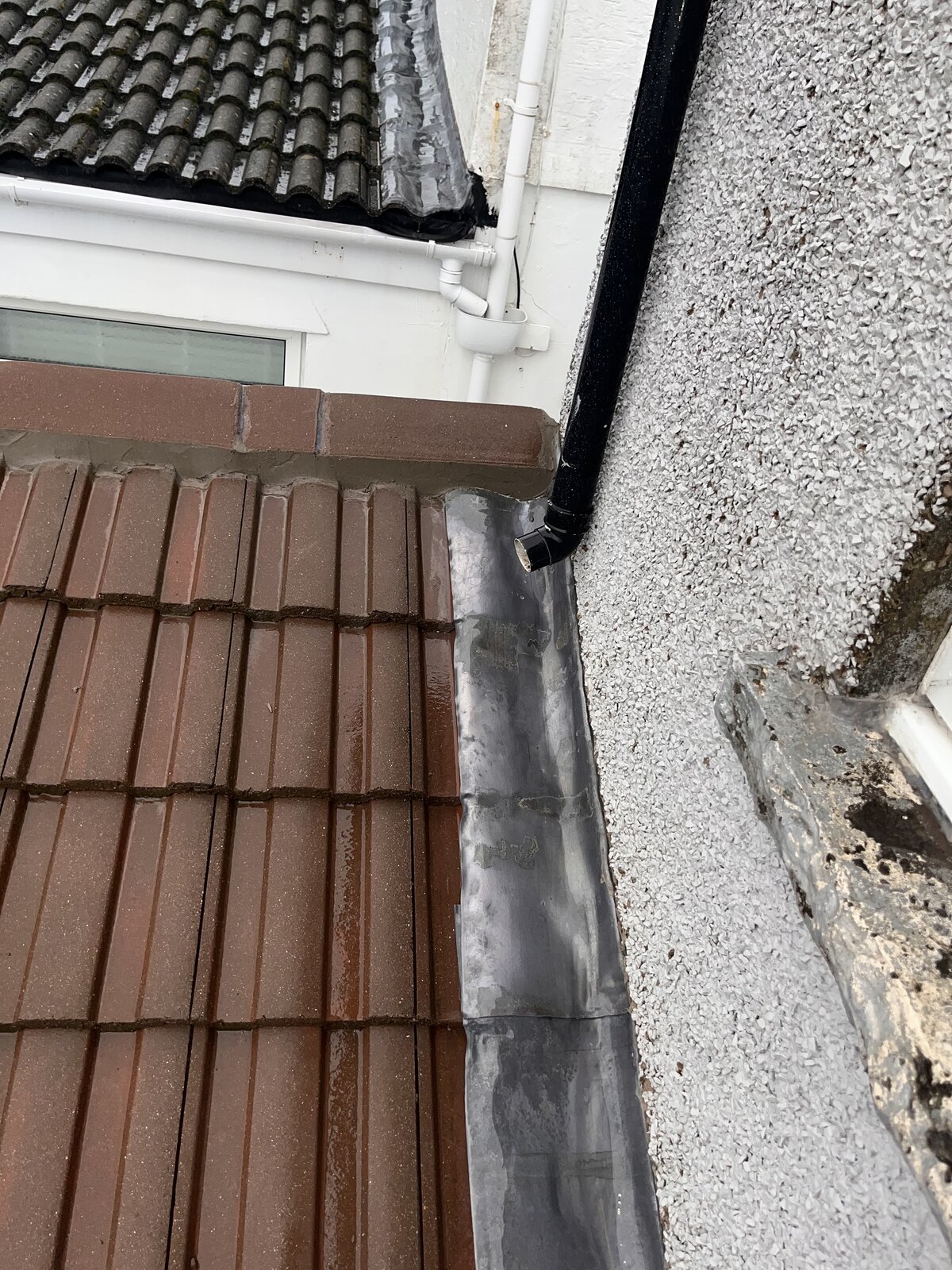

Nine times out of ten (assuming the lean-to roof flashing is sound?) this will be water penetration around the window. Penetrating water through masonry is very, very rare, and I've only really seen it where masonry is completely saturated by high levels of running water from gutters etc. over a long period of time. In such case it would be obvious - the masonry would be heavily stained with algae.
This assumes the lean-to is sound and a decent flashing depth - a photo of the rainwater outlet and flashing over the lean-to would be useful.

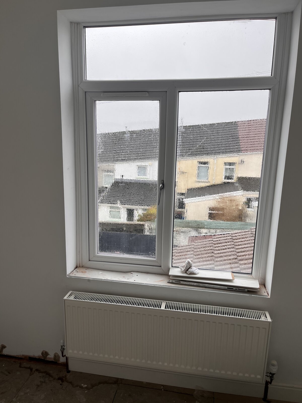

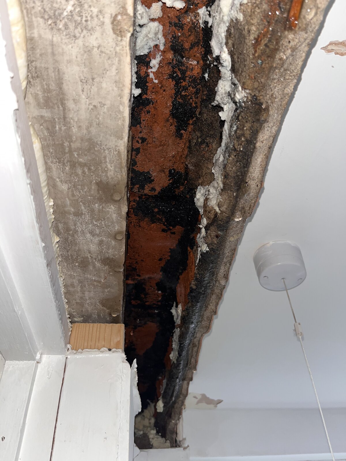

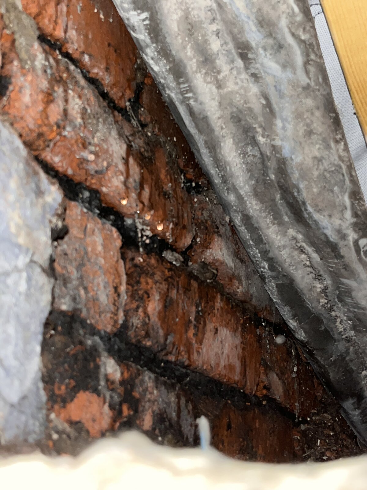

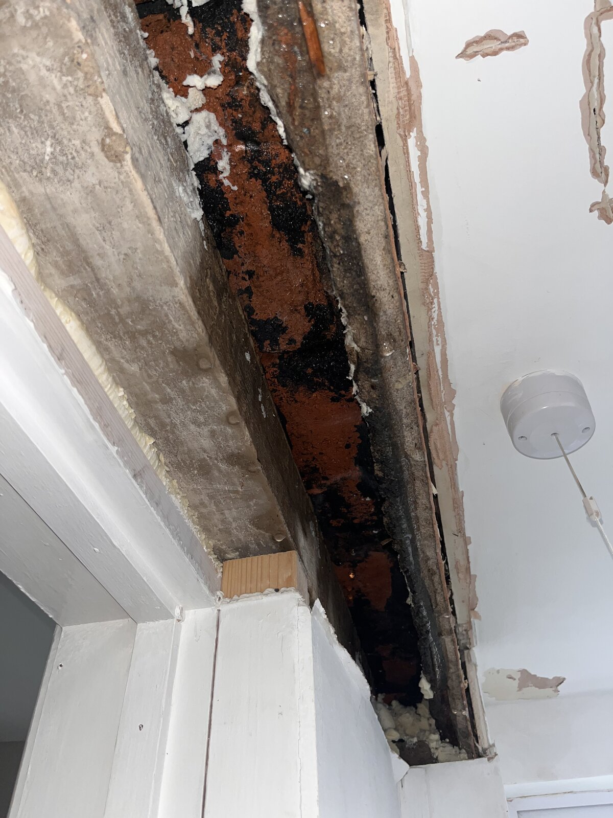

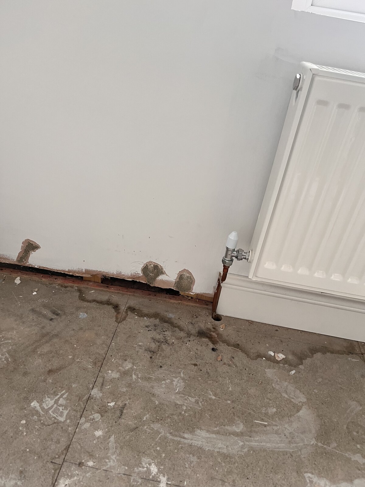

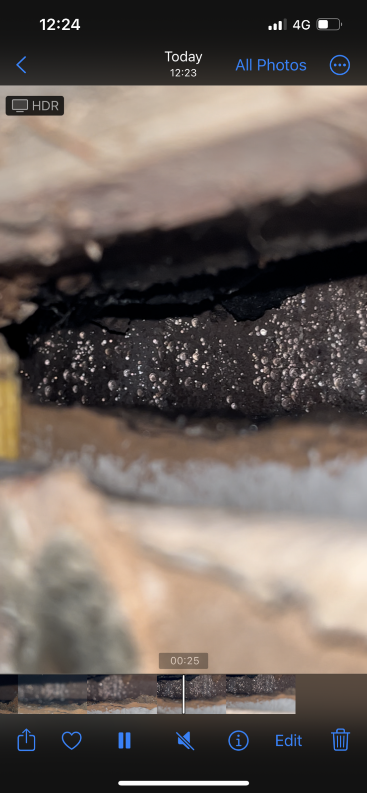

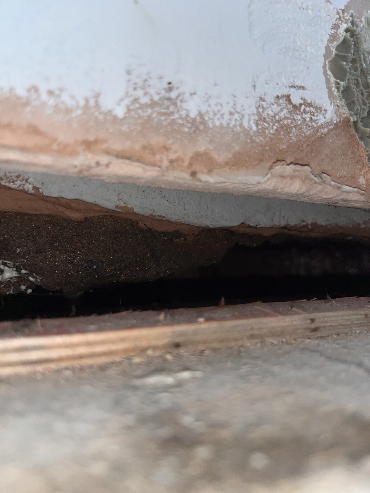

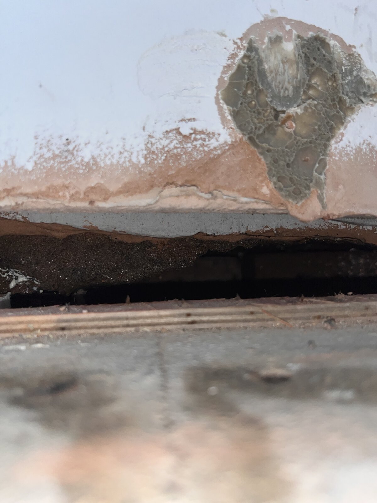

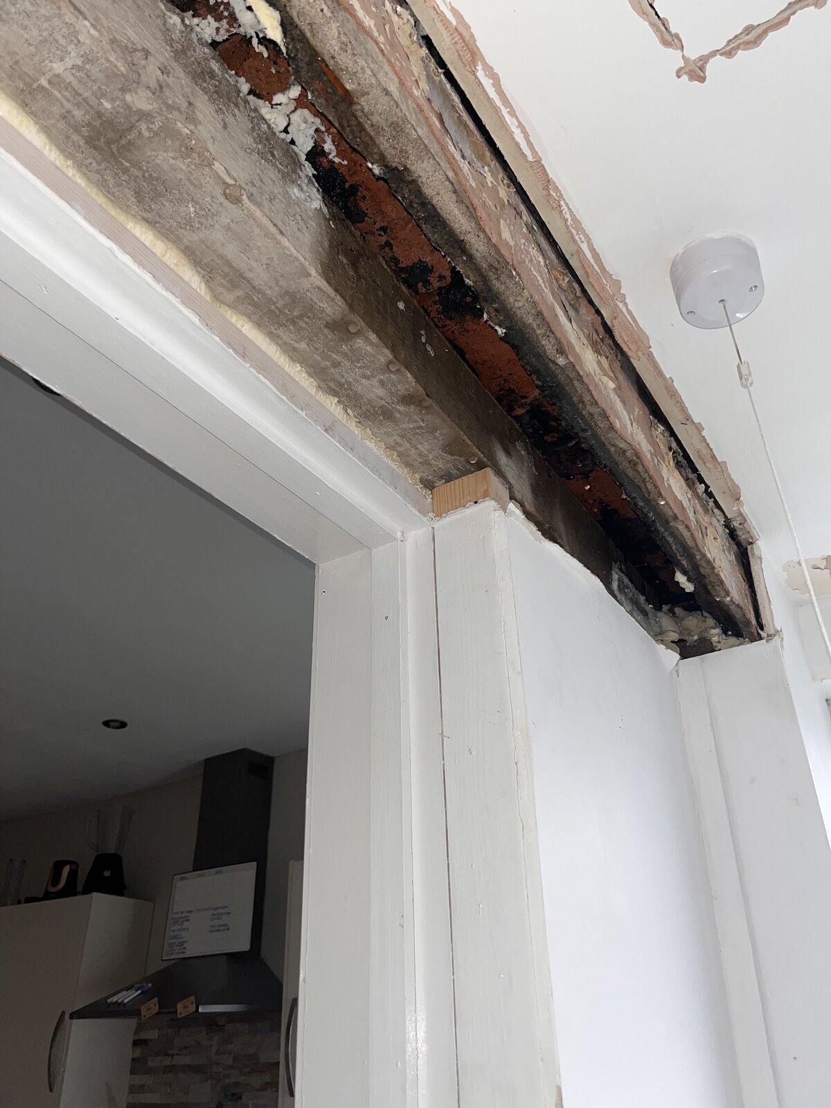

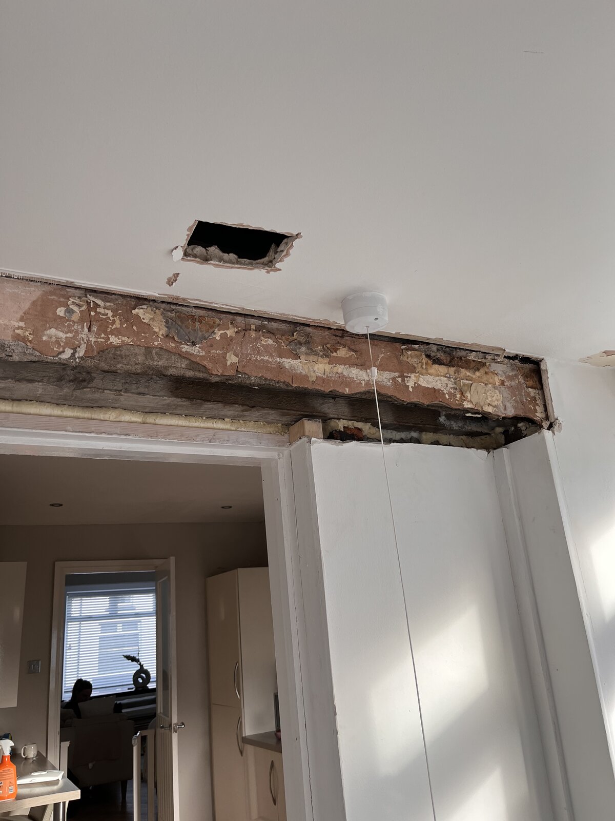

Hi mate, iv attached several photos. The cleared cavity downstairs is where the leak is. And iv also taken photos of the upstairs box room window, as you can see there’s an old damp patch on the floor from around 10 days ago. This started drying out, but now we’ve have more heavy rain today the internal wall has started to get wet again. Iv attached photos so you can see. The photo showing water droplets are the external skin of the upstairs wall.

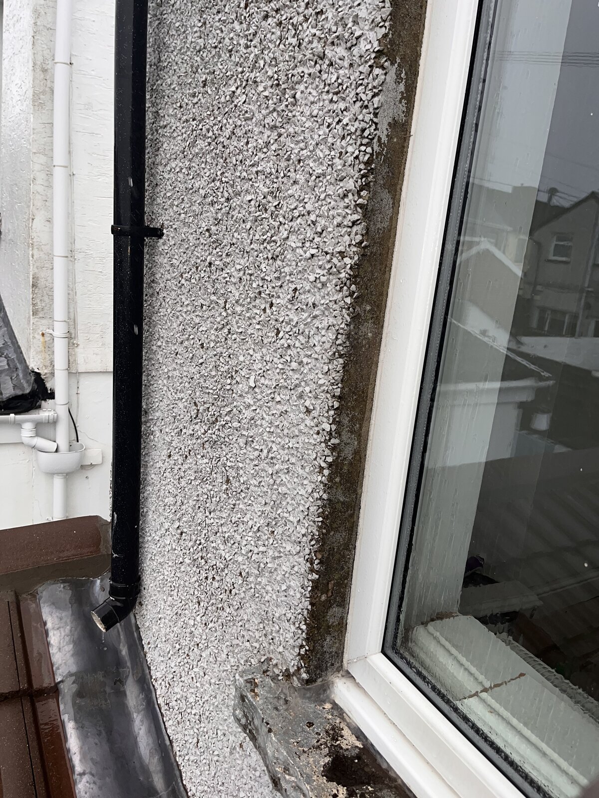

The upstairs window isn’t directly inline with the downstairs door where we have the leak, so iv taken a photo of the Downpipe which is directly above our door. If you need any more photos please ask!

You mention cavity - is it a cavity wall?
You say it is dry beneath the flashing. Does that include the small section of wall below the flashing but above the roof?
This is what is confusing me, upstairs as you can see from the photos it looks like a cavity wall because I can see the inner and out leafy brick work. But when I come downstairs I can’t see the cavity because there’s bricks over the lintel?

If you lift the flashing on the lean-to roof, there is a small strip of wall immediately beneath the flashing. Is this wall dry?
It’s hard to see, it’s very tight. But iv cut a hole in the ceiling which is below the lead line and the wall has drips? Iv also just been on the roof and there’s a hairline crack going from the window cil down to the lead, do you think this could be the issue? And also could it lead to that much water coming into the house?

The only sure way to eliminate the flashing 100% is to lift it when it's wet and see what the condition is beneath. Wet or dry?
