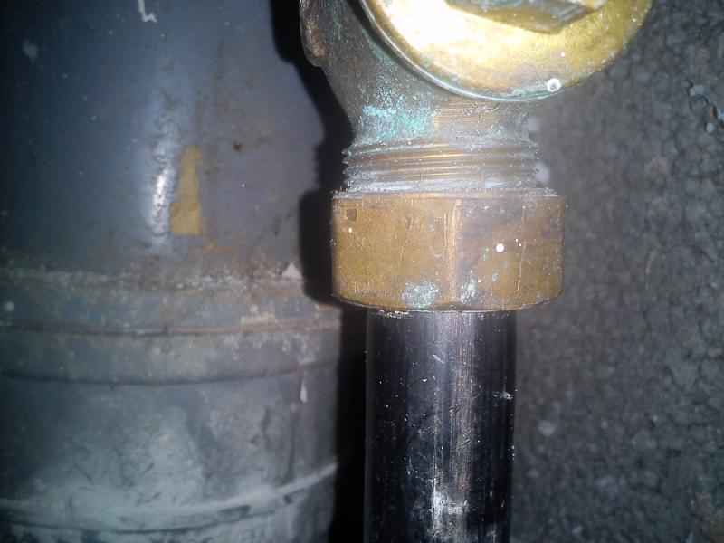

I glanced at the plastic service pipe yesterday, looked in the plumbing fittings catalogue and they only do 20 or 25mm, well it's thicker than 20 so I bought the 25mm stopcock. It's way too big! I got the caliper out and it's measuring an OD of 21mm.....strange. Is this right? It's an estate house built in 1976.

20 or 25 pipe is usually blue. You've got old alcathene pipe which is imperial, and I doubt you'll get a stopcock which will give you a direct connection without needing additional adaptors.
By taking the existing tap apart and using some releasing fluid and brute force you should get it free. Replace the washer and check the seat whilst you're there.
Next time you open the tap, turn it 1/4 turn back once it's reach the end of travel. That will stop is siezing.

MDPE pipe will have writing on the side and include "ClassC" or "ClassD" (blue writing is Class C and green is Class D)

Saying that the stopcock only wants a service, if the OP slackens the packing gland and squirts a load of WD40 in the space the shaft should move quite easy, put some grease in the gap and screw the packing gland back in. job done.
I didn't say you couldn't connect onto the imperial pipe, I said you wouldn't be able to do it without adaptors, and unless you know what you're asking for at the merchants then it can be a confusing time for the DIYer (as the OP's discovered already so far). I've not seen a direct imperial to copper stop cock in ages.

I'm confused. The black service pipe has an OD of 21mm measured with my calipers. Can anyone tell me what size pipe I have? 21 doesn't translate to any round imperial figure unless the imperial is rated by ID? :cry:
Imperial pipe is always rated by ID, metric by OD.
Hence with copper pipe, 1/2" ≠ 15mm, 3/4" ≠ 22mm, yet they're the 'equivalent' modern sizes.
What stop cock have you bought? The likes of philmac do a plastic stopcock which will fit easily on the 1/2" plastic and then you need a copper adapter at the other end. Problem is they cost about 3x as much as a brass stopcock.
Therefore trying to free the old one is the best option IMHO.

I've just donwloaded a table, it says that 'imperial BS3505' water pipe with an OD of 21.2mm is a 1/2in nominal size. The OD of this matches my measurement...so I'm guessing I have a 1/2in imperial service pipe?

You don't need to dismantle anything, turn the water off and unscrew the packing nut as above, you can free the handle and put it back.
You should post a pic showing all the valve and the pipe coming out the other end.
plus an insert for class C or D when/if the OP tells us what it is.
I'm with Doitall on this one, service what you have already got.
Trying to fit a new stopcock for a DIYER will only end up in tears.
