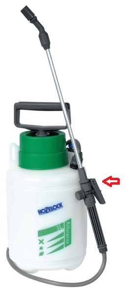

A old style Hozelock Killaspray will withstand about 1 bar of pressure. Not sure about the modern ones though.
Very easy to connect a flexible hose to the handle after the wand has been removed ( I recall a standard threaded coupler fitted ).
