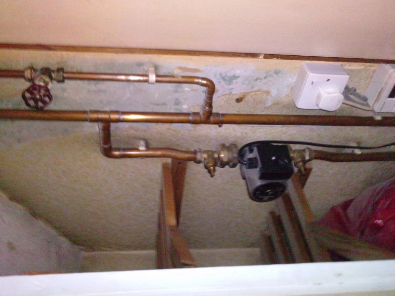

water pump. causing header tank to overflow?
i couldnt feel any differences. i presume you are talking about where the pipe splits just after where the pump is and one goes up to the vent for the header tank and the other goes down?

have you a 3 port valve like this after the pump ?
sorry i posted it sidewards but the two pipes leading up are the vent which is the pipe coming off the pump and the furthest right pipe with the valve on is the feed from the header/overflow tank bk into the system i presume??
run the magnet around the top tee, bottom tee and the vertical section in the middle, and the elbow above pump.
you not touched any valves either side of pump ?
is that gate valve fully open ?
that pump is pumping down isn't it ?
why is your cold feed and vent wrong way round ?
the pump is pumping upwards that was my main concern when i looked at it earlier.
the pipe between the two tee pieces is more magnetic than the rest of the pipe work.
also i am not 100% sure where the pipes go i presumed that was the correct places as far as i can see as the pipes go into my wall cavity in the loft i could try to find out which is which. what should the two pipes be that lead up there?

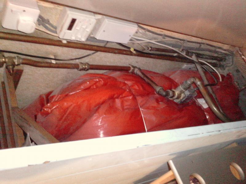

there are also 3 cold pipes that go into the loft behind my hot water tank
also of note both the pipes in the picture that lead up to the loft are very hot to the touch. if that helps atall?
that don't make sense your pumping towards the vent/cold feed.
looks like its pumping down to me.
have you checked the arrow on the casing ?
have you a pic lower down showing 3 port valve ?
crudded up and resticing flow.
ones probably feed to hw cylinder
then the others are probably feeds to bathroom etc. :idea:
i had never looked at the direction the pump was going until i saw a post about it being the wrong round but it is definately pumping up according to the arrow on the black casing.
the pump pipe goes downwards into the 3 port valve then that goes down again into the floor
the pump should pump towards the 3 port valve.
so the order from boiler is VENT- 150MM MAX - COLD FEED - PUMP - VALVE.
and the valves upside down. not recommended.
if they leak they leak onto the electrics.
so the pump needs turning around?
also is that the order it should be in or is that the order you think it is from the pictures i have given you?
if the pump was turned around would this correct the problem? is there an easy way to clean the pipe which has the build up in it?
yes.
should be - vent - cold feed - pump - valve.
yours is - cold feed - vent - pump (wrong way) - valve.
vent should be before pump if you pump to a vent its gonna go up it
rather than take a restricted route through rads,boiler etc.
as for cleaning i would cut it out and fit new section.
you can get cleaners like sentinel x400 - x800 but they won't shift hard crud only sludge.
thats a section of pipe thats gone hard with crud.
