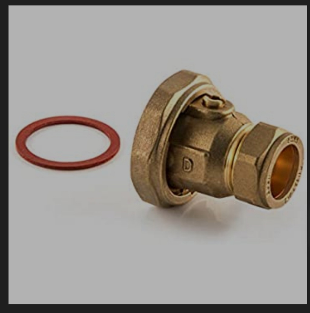

In looking at the valves I intend to buy (link in earlier posting):
I notice they include a washer but only for the larger 1.5" end. This makes me wonder about two things.
1) The pump comes with two washers for each of its (large) 1.5 inch ends. Won't that give me a total of 4 x 1.5" washers? How many do I need to do the job?
2) Their appears to be no 22 mm washers for the smaller (pipe) end of the valves included with the valves. Is this a problem, do I need to purchase additional washers?
Is this a serious question?
Yes, this is a serious question, do you know the answer? If you know the answer to my question 1) as well, I'd be grateful.

The 22mm ends of the pump valves use olives and not washers.
I would be removing old olives and nuts, cleaning up pipe ends and using new ones from replacement valves, along with some paste if pipe ends are indented.
Use rubber washers on pump unions instead of the fibre ones.

Let me give you a little tip, don't even bother trying to undo the big pump nuts, there is no point.
Instead make up the new pump with the two new pump valves using the rubber washers that come with the pump instead of the fibre washers that come with the valves.
Next take out the whole existing pump and valves in one piece by undoing the smaller nuts (with olives), put in the whole pre-assembled pump & valves replacing the nuts and olives if you need too (personally I would not) with a couple of turns of ptfe or smear of jointing paste covering the olive.
The above is of course assuming you have drained as you said you intend.
EDIT: Make sure you get it in the right way around, there is an arrow on the side of the pump, note the direction of the old one before removing it.
