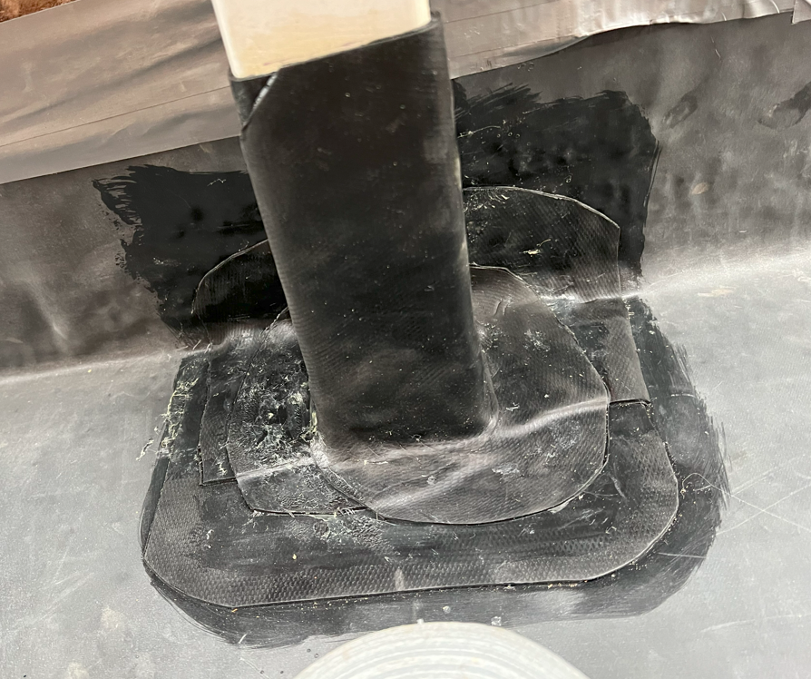

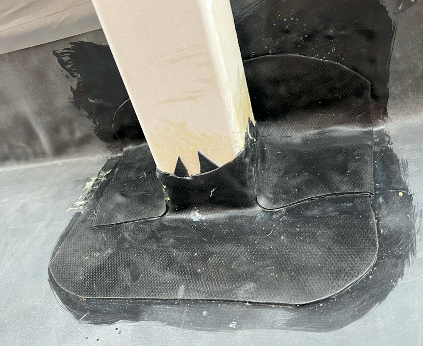

I've laid down a rubber roof for a shed and water-tightened this downpipe that goes through the shed (via its roof). Here are some pictures of that in case it's relevant:
I've also done two other soil pipes too. All of these were fine for the first two weeks and we had some rain over these two weeks but the above has now failed. Water is seeping through and I can feel it along the pipe inside the shed.

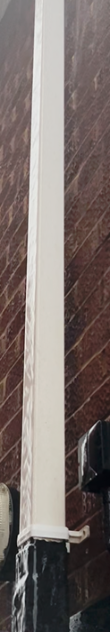

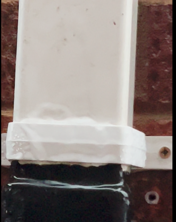

I have noticed that there is water seeping out of the top here, where it then flows along the side of the pipe and hence, hitting the top of the epdm tape all day long! I doubt its designed to take that level of hammering?
You can see the water trickling along the face of the pipe in the second picture. This is a large roof and there is along of water that is coming down from here. Presumably there is something wrong with this join? Also, what can I do to protect the roof in the meantime?

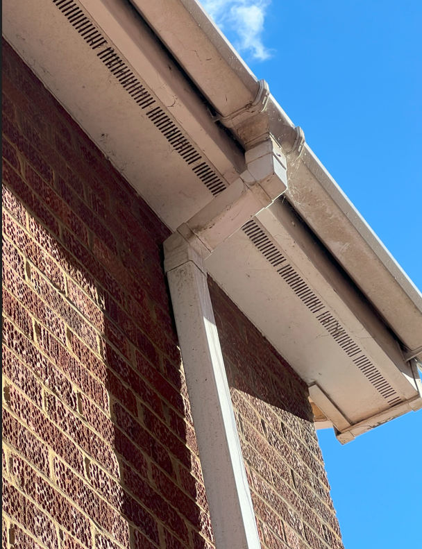

It looks as if that bottom 45 degree fitting, the lower one of the dog-leg back to the wall from the gutter, has been fitted upside down.
Your a genius! I compared this to the other side and your suggestion checks out.

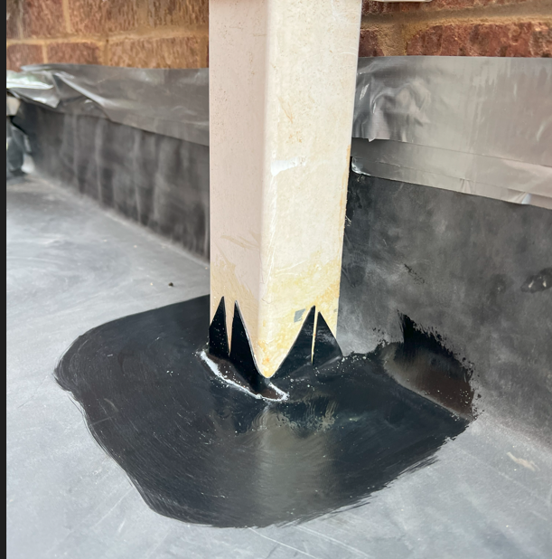

Would you expect the epdm uncured tape to fail under these conditions? There is a lot of water that is constantly hitting the top of the tape join but I'm unsure on how resilient they are supposed to be.
I got someone to switch that fitting around earlier. Hoping that stops the water trickling down the pipe and hitting the tape.
Should the tape have withstanded that?
Do I now need to repair this tape and what method should I use?

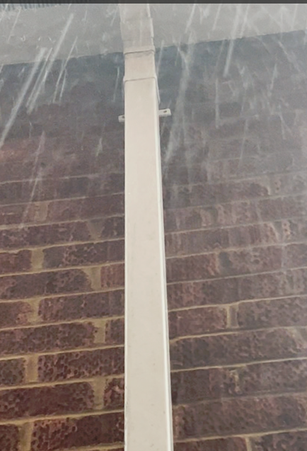

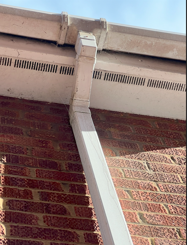

After re-fitting the join, I thought the issue was resolved but with all the recent rain, I noticed that I still have water running along the face of this downpipe. I think it's less than before but still have a steady flow. I've attached some images.

To be fair, with eyes on site, it ought to be obvious where the water is leaking out. Photos only allow us to make guesses.
Basically, with gutters feeding into fall pipes, the lower end of the part above is a male, which slots into a female socket of the part below it - rather like a funnel arrangement. That way there can be no leaks, unless a section becomes blocked.
You found some numpty had fitted one section of the dog-leg upside down. Perhaps the same numpty may have fitted the other section upside down - hence your continuing leak?

Fair point but as seen on the latest image, the fitting has been switched around and now has the correct ends slotting together. Water is still seeping down from here but only when it rains heavy now. This wasn't the case previously, it always seeped out of here when it rained. The fittings are not blocked as he has pulled the whole swan neck apart and shown me its clear. Where else could it be blocked?
On the other end of the pipe, I have a uncured epdm tape and lap sealant as it goes through a rubber roof.

Looking at your original photo again, where you had a lower fitting installed upside down. It looks like where gutter, joins the down pipe *called a gutter outlet), the fitting above the one which was originally upside down - That upper fitting, does not appear to meet the outlet properly, and might well be the source of the leak.
Another possibility, is that the gutter volumes are simply not adequate to cope with the amount of water, falling on your roof area, and so it overspills the gutter.

I can monitor this during the next bout of rain but I thought it was the lower fitting again. Almost certain about this and also, if it was the top most fitting, you’d see a drip straight down and not all the water trickling down the face of the pipe?
