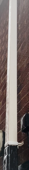

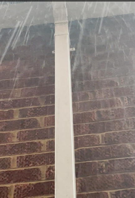

Water seeping along downpipe

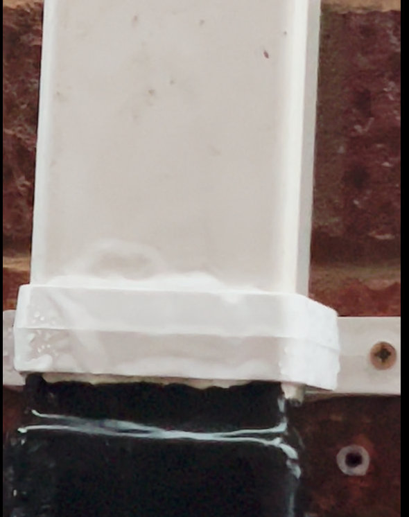

What more can I, or anyone say - it's a shockingly poor job. It needs someone with the very basic skills needed, to sort it out, it's not rocket science.
Aside from the stupid and obvious error of the fitting upside down, there should be a fixing bracket at the top of the fall pipe, near the fitting.
What’s shockingly poor or amateurish about where we are now? I don’t get this.
The most recent builder has corrected the fault with the fitting and fitted a bracket at the top. He’s also examined inside the downpipe. I’m unclear on why you keep saying that? You the. Go on to say it’s a basic job and not rocket science but then don’t offer any suggestions. What am I missing?

Your downpipe is blocked or the drain it goes into.
I think so too.
Given that the builder put a camera down the downpipe and a bit further as I understand it, and said it's all clear. I thought it may be an issue with the communal pipe for the rainwater. Called Thames Water and they said, they don't own it. Suggested I speak to the local authority. Called the council and they don't have any maps for this type of thing. It could be connected to the rain water line in the street (uncommon for newer properties apparently) or it could be going into a soakway. The latter would be my responsibility.
They will come and check their drains in the street but not be able to confirm if my rain water flows through to it.
I am tempted to get one of those CCTV "thingies" that connect to a phone and on a day with heavy rain and this water leaking out of this join, pop it up there where the downpipe is and see if it is full. If not, that suggests that the swan neck fitting has fault.
