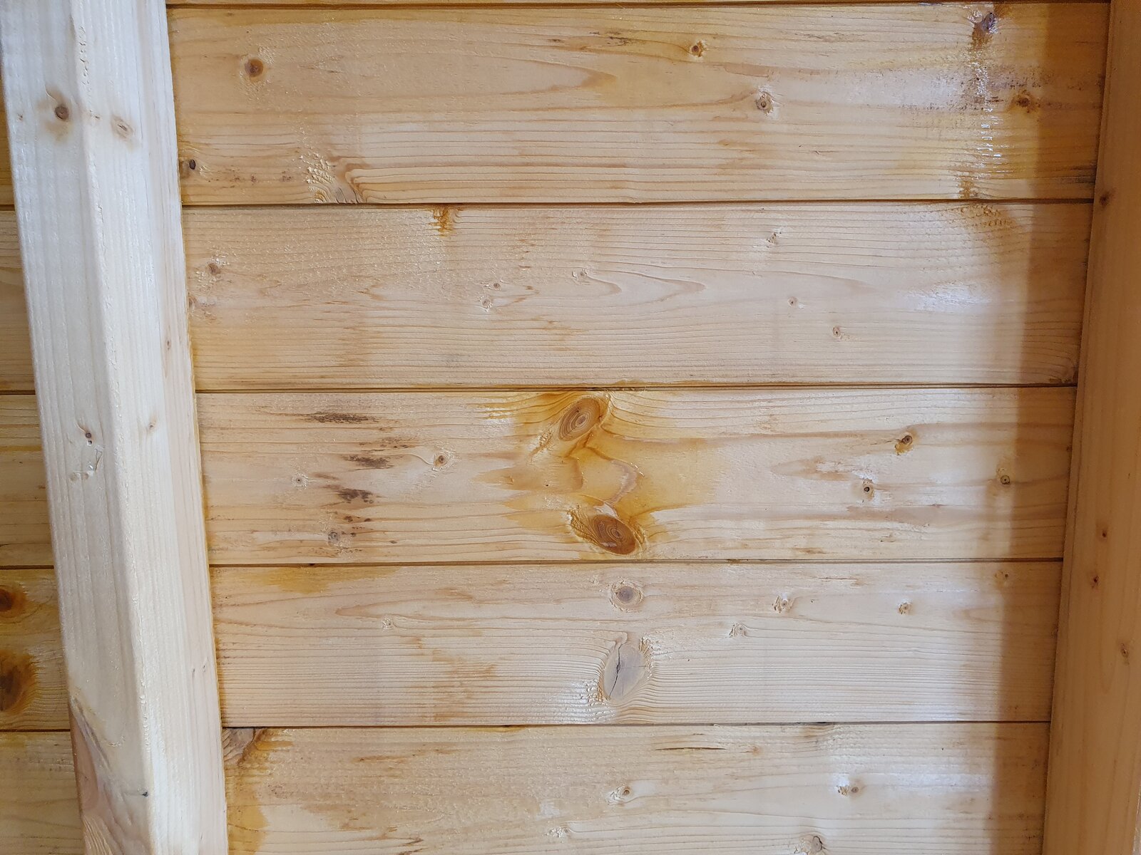

I have spent the best part of 10k on a summerhouse for the garden end of last year which I didn't use during the winter as I still had to furnish inside. I noticed a few months ago the bottom strip on the inside had turned black most of the way round which then revealed small pools of water every time it rained, the roof is fine as the water is coming through when I aim a hose at the side. Much of the tongue and groove isn't tight so assumed that was the issue so went round every gap with CT1 silicone, also filled every gap at the nails with Woodfiller.... still coming in.

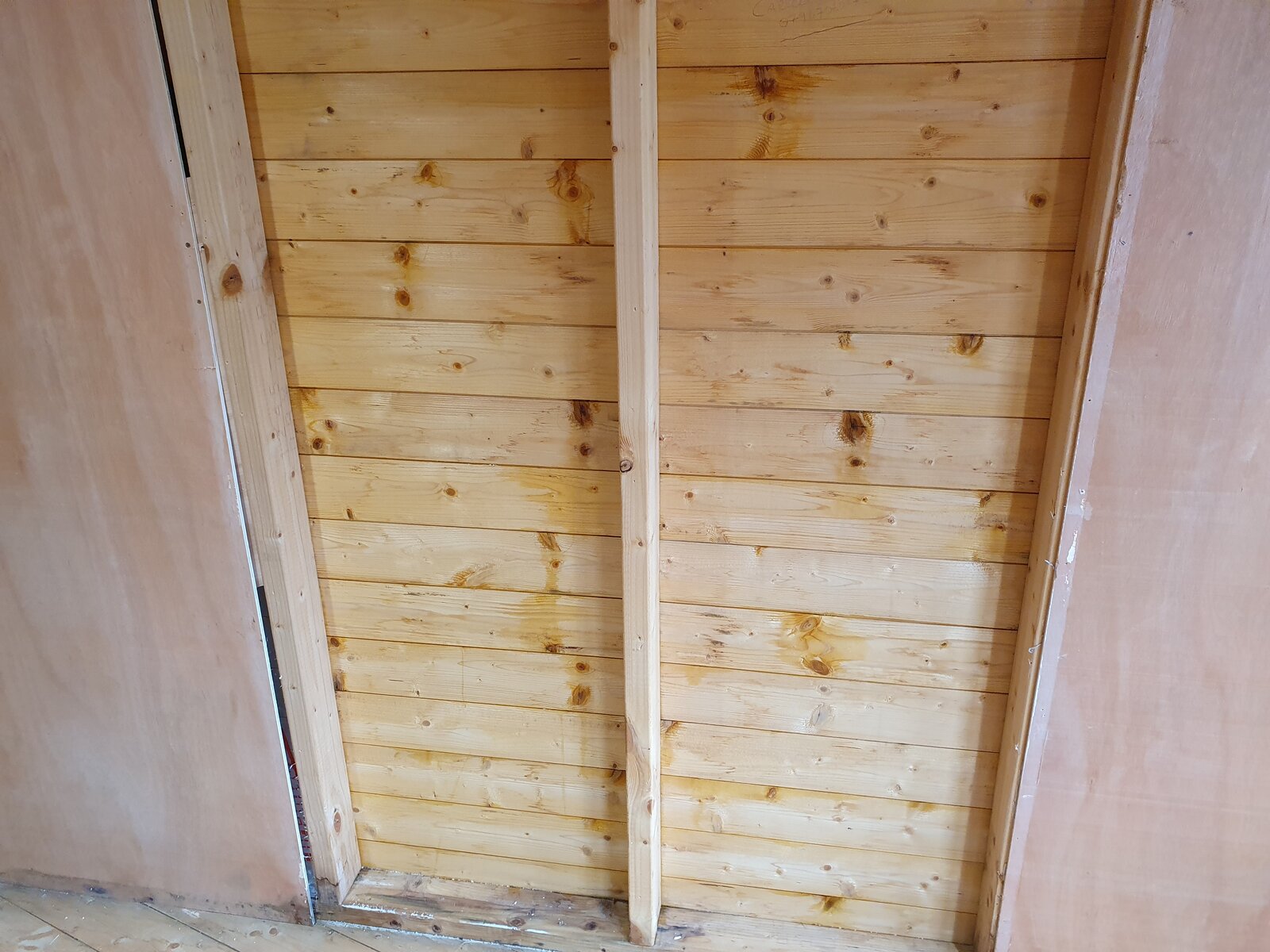

I have now removed 1 sheet of ply and the insulation from the inside to see where it was coming in and it is actually seeping through the knots, not just 1 but about 10 knots just in that small section alone.

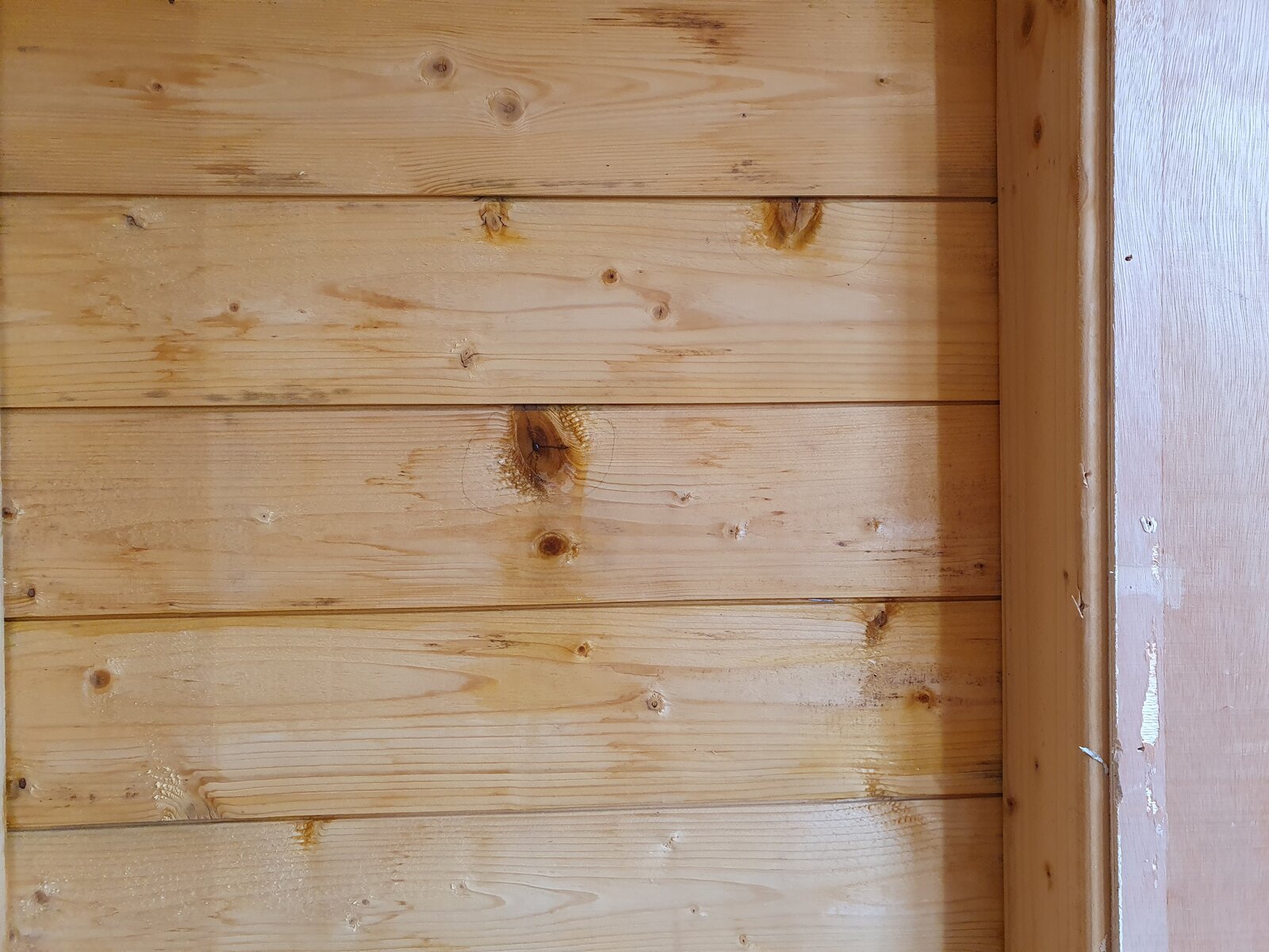

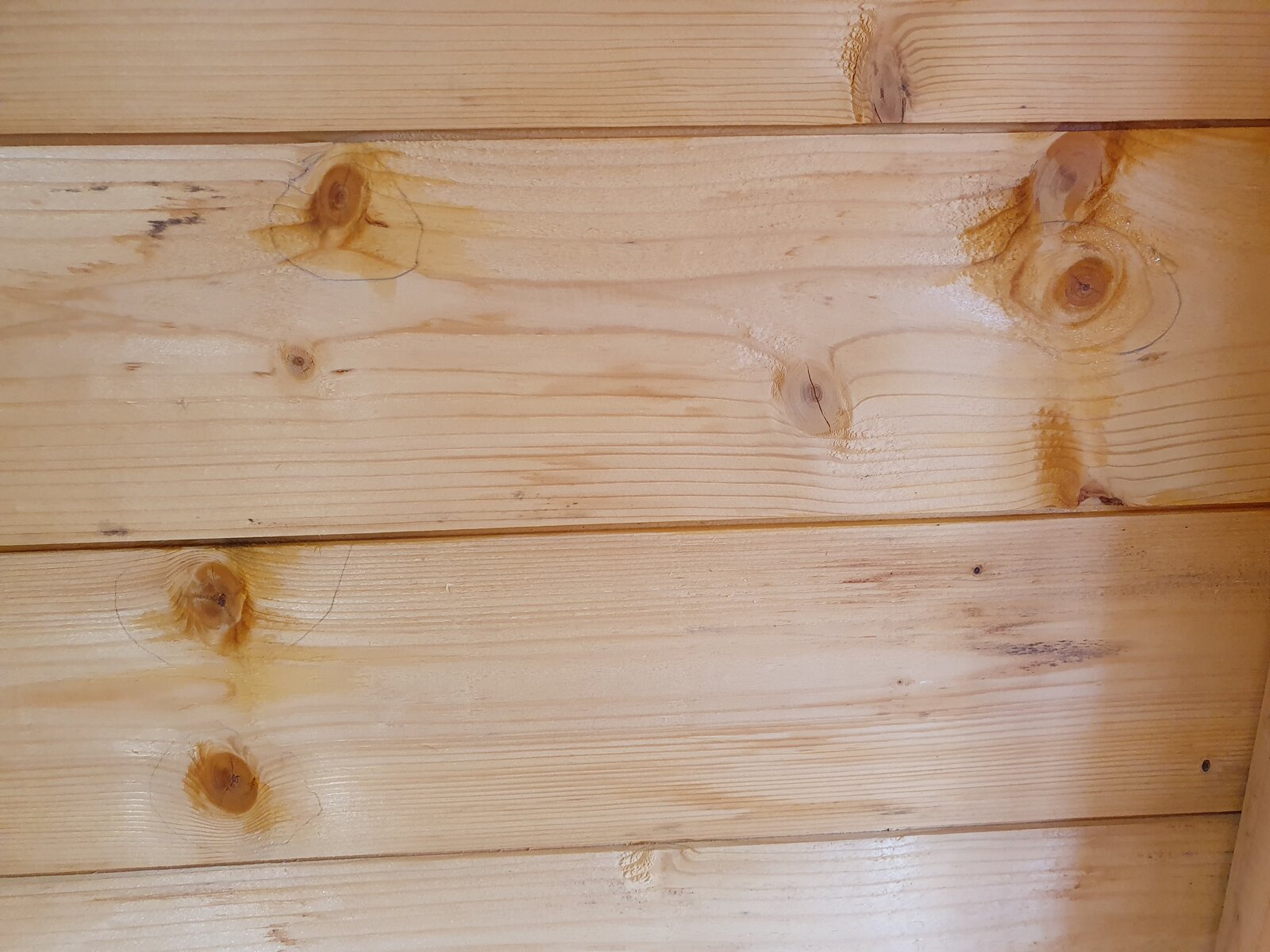

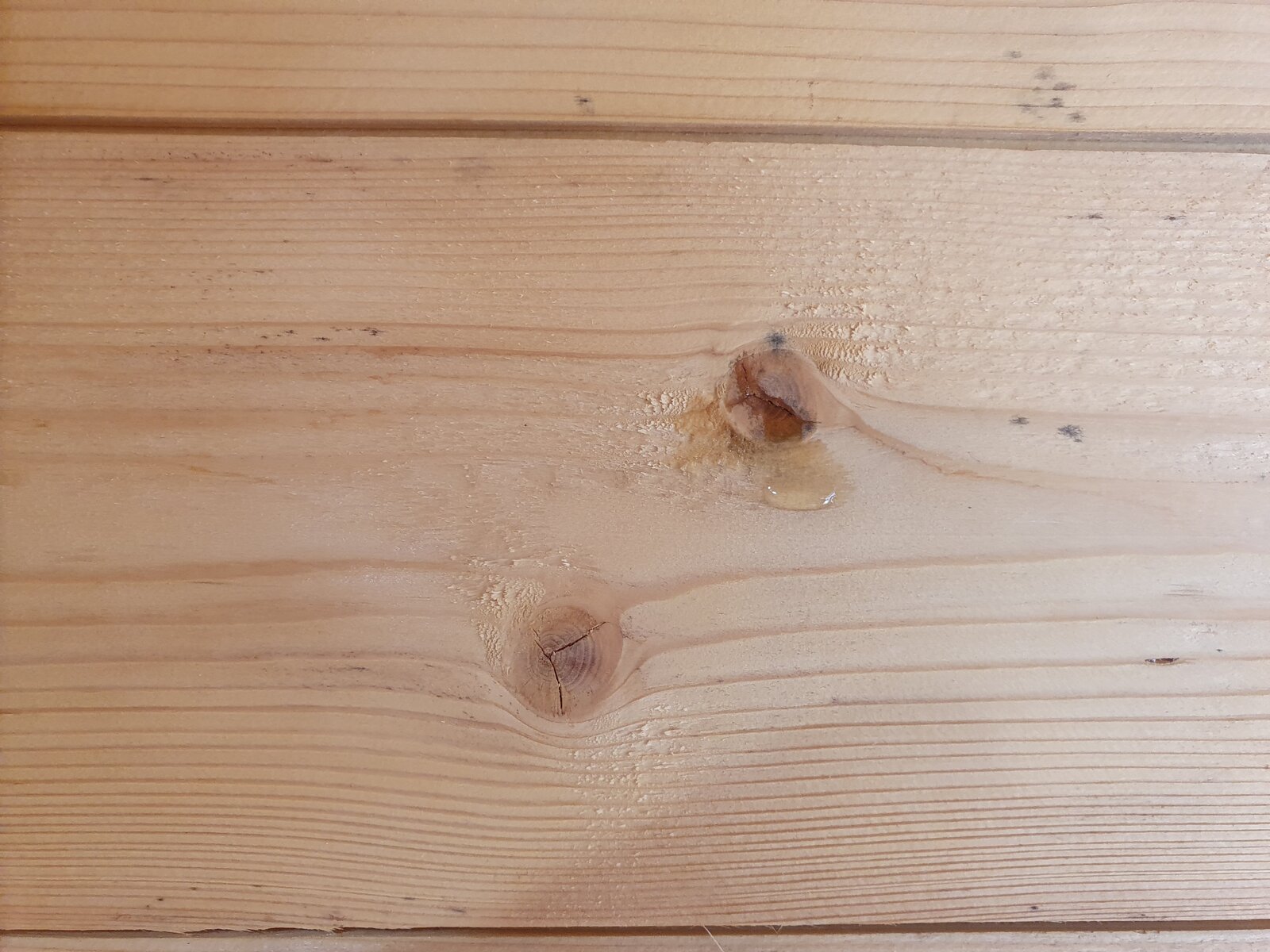

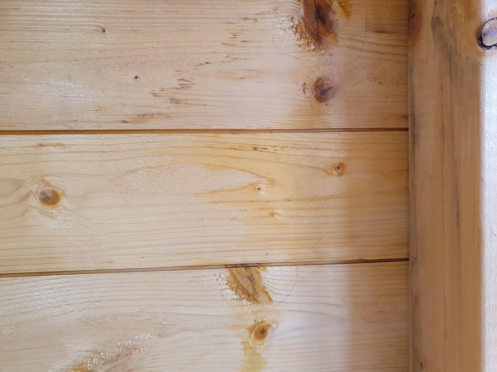

Its defo coming through the knots, there is 1 picture you can clearly see the drip forming just under the damp knot and its dry all around it so cant be coming from anywhere else.
The pools of water are forming as the water eventually runs down the inside to the bottom and you can see where the timber has turned black over time.
Yeah the t&g is facing upwards.

I don't believe the issue lies anywhere other than the knots as I have even tried aiming the hose on a few boards at a time and you can see the water seep thru instantly.
