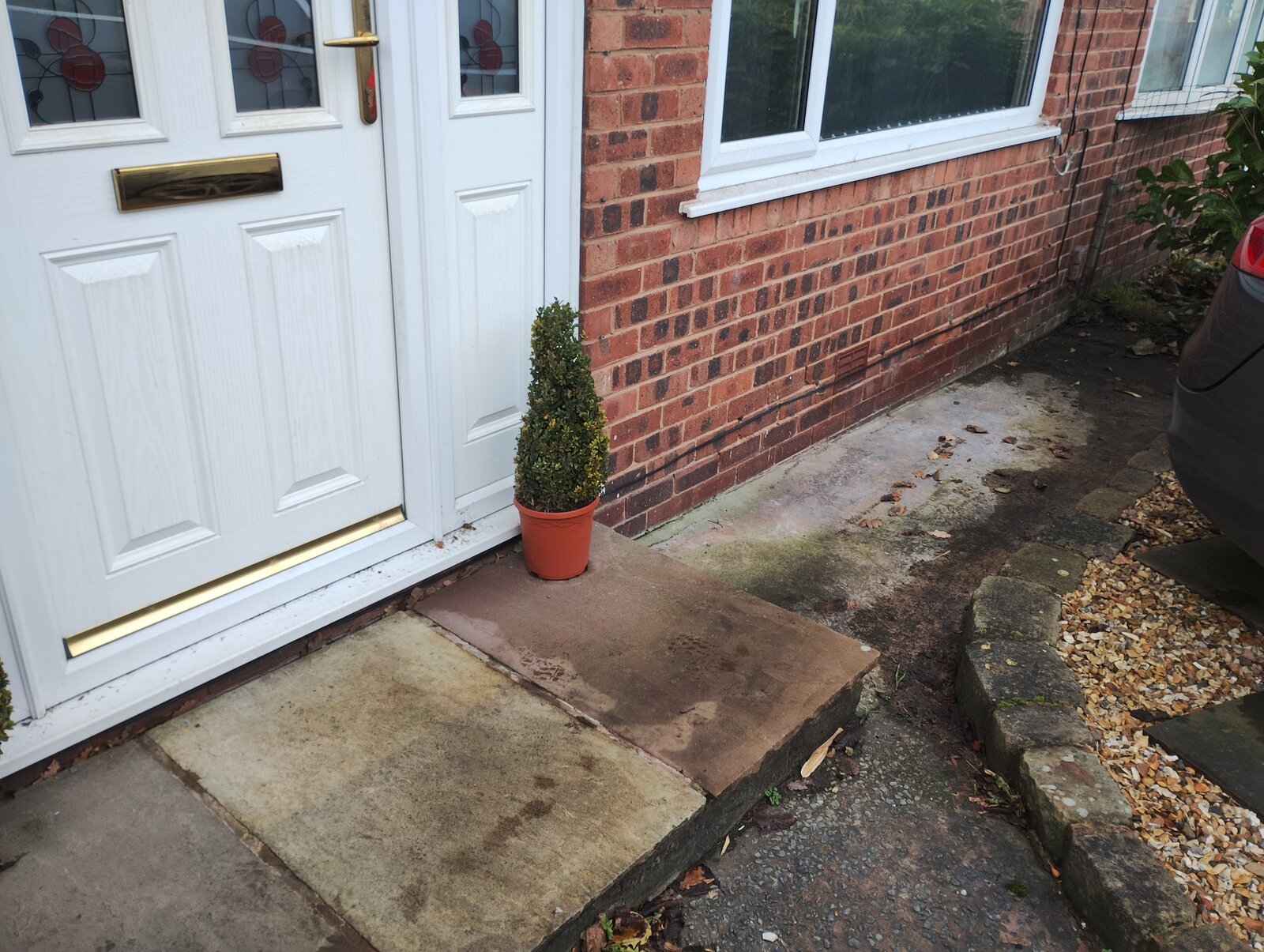

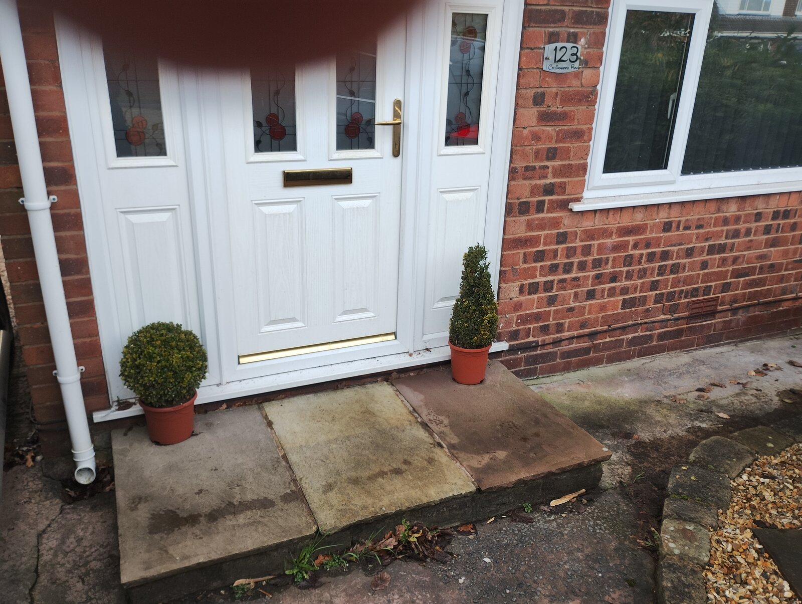

Hi, I'm looking for advice. I moved into my house around two years ago. When we have quite a bit of rain, the water just sits on the path, against the wall, under my living room window. In the picture you can see greenery from next door but this isn't what is stopping the water. I have cleared all of this and it still sits. My concern is the water causing damp in my living room. So far, there is no damp and I recently replaced the skirting and found the walls to be dry. Is there anything i can do to get the water to drain? Any information would be greatly appreciated.

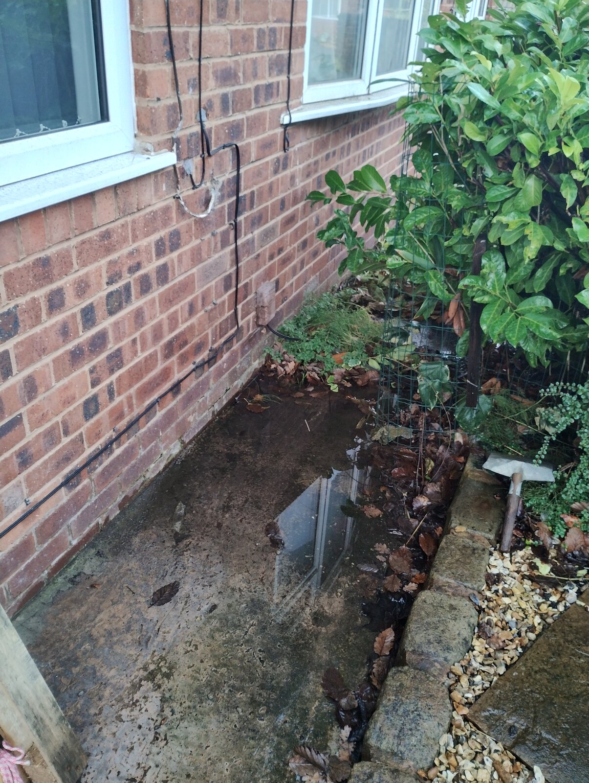

Where is the nearest drain? If there is one, you could relay the concrete with a slope towards that.

Where is the nearest rain-water pipe?

Better photos showing the wider area/context and where the boundary is would be helpful.
If I see it correctly, the dpc seems to be on the third course.
In that case, unless water goes over that level, it won't affect the enterior.
Given that everything has been built properly.
As a solution, as you have 3 courses showing, you could install paving and slope it away from the wall.

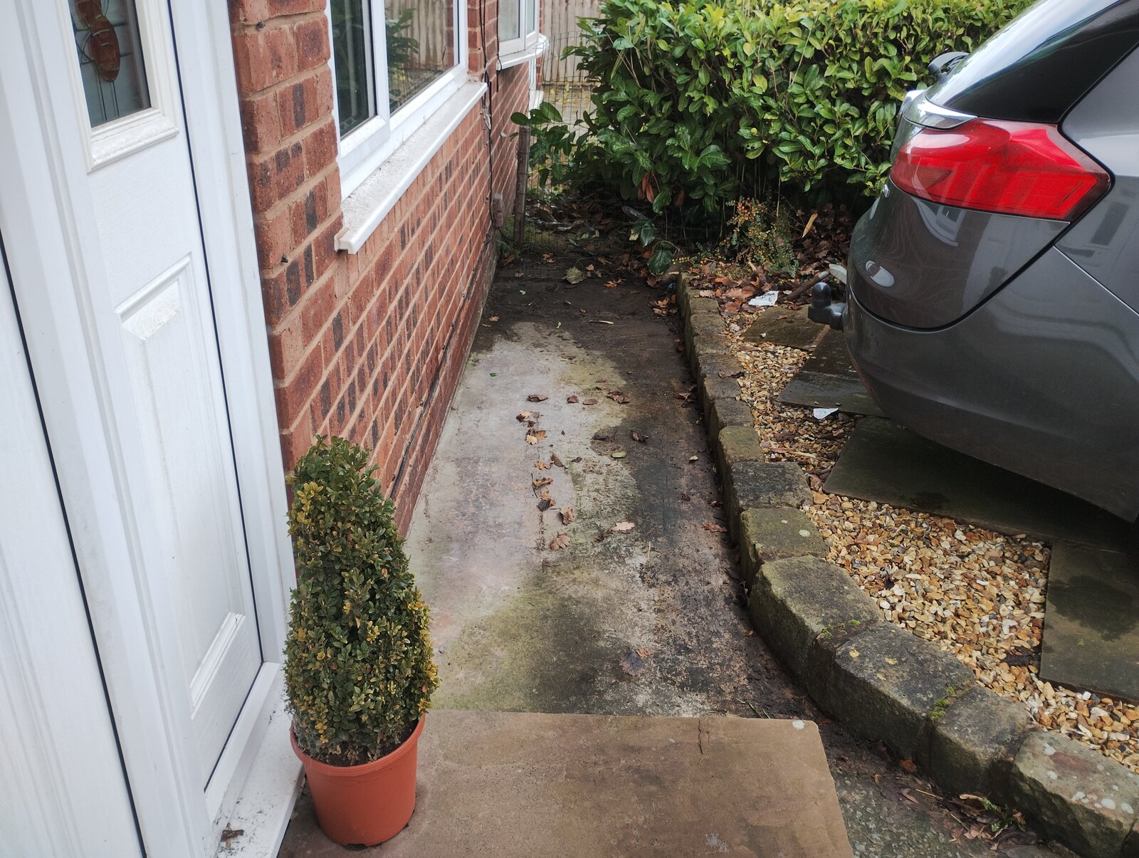

Thank you to everyone for all the info. Here are a few more pictures.
Looks like you have drainage on the left side of the photo. If you redo the concrete with a slope away from the wall and towards the left, the existing drainage should take care of it. Currently you have a slope towards the right.
