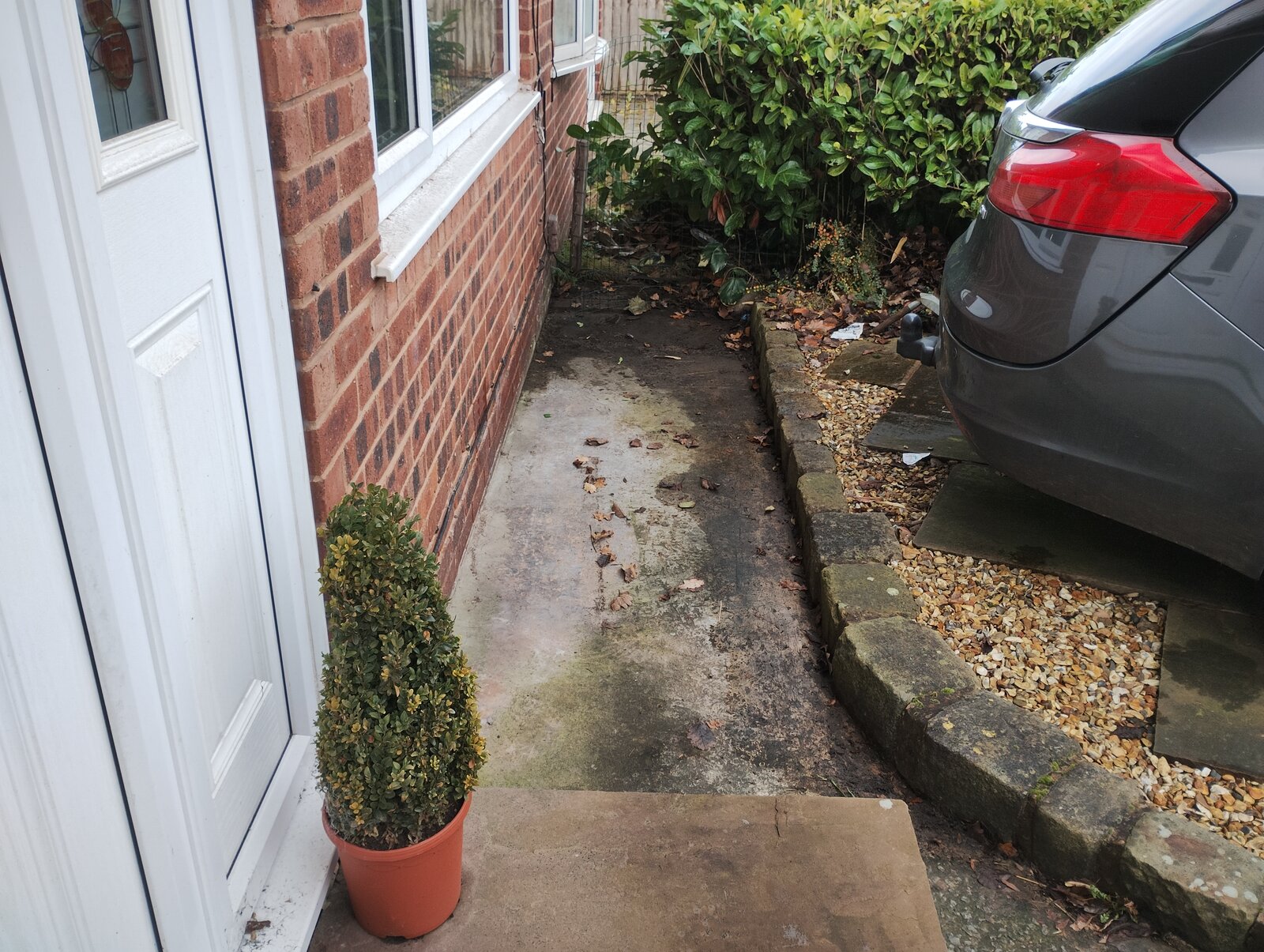

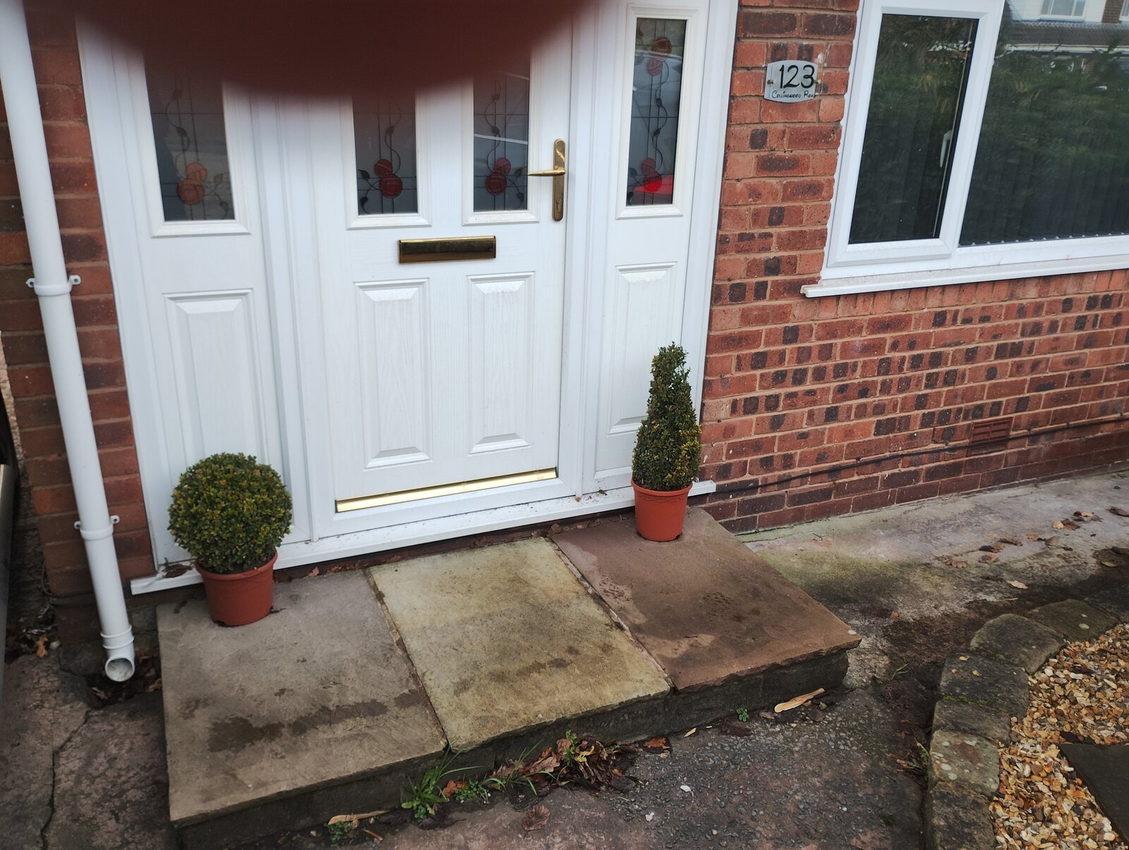

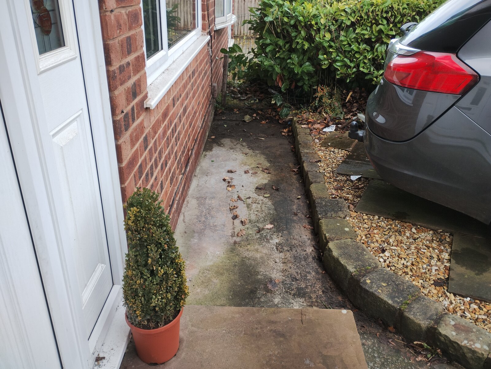

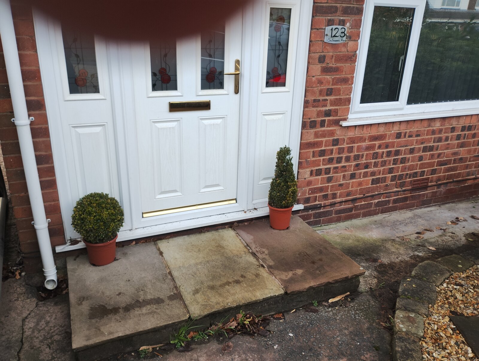

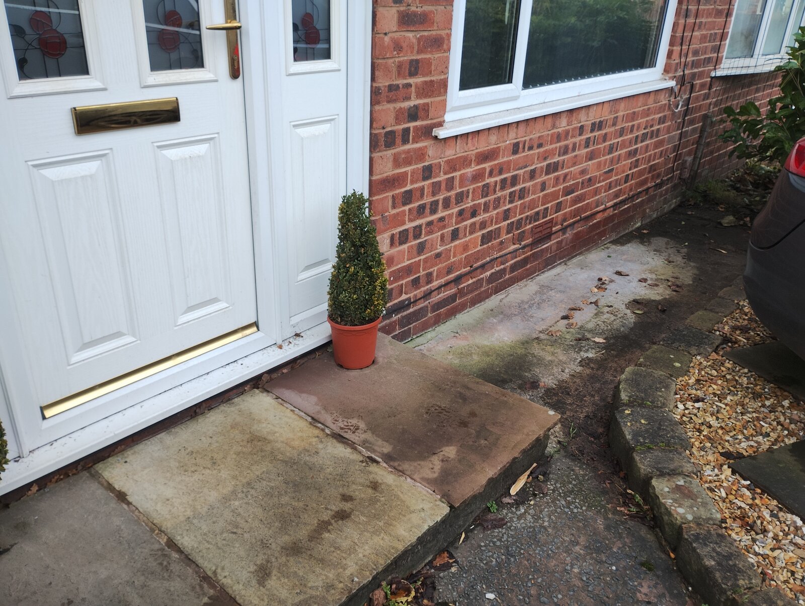

hank you to everyone for all the info. Here are a few more pictures.
Now, with a better idea of how and where the water is collecting, now we have the photos....
To me, it looks as if the concrete is levelled so it drains away from the house wall, but is being prevented, by that row of stone sets, between the concrete and the garden. Note in the first photo, that the concrete remains damp, alongside the stone sets. I would therefore suggest a quick fix would drill some weep holes, through the mortar joints, sloping down, through to the soil.
