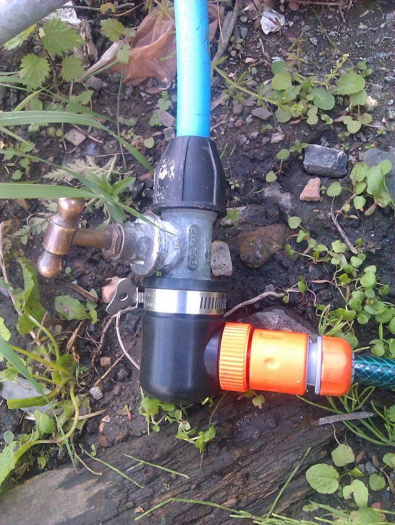

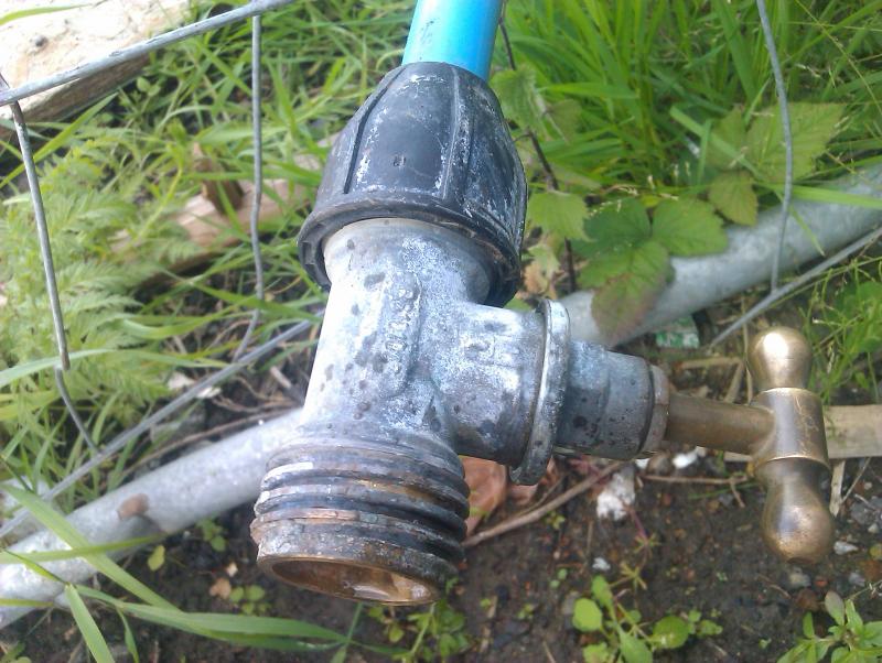

I have a water supply on my allotment that comes from a MDPE pipe. There used to be a standard tap fitting on the end that a hose could be connected to but it has been stolen. This leaves a brass stop cock connected to the MDPE pipe with a 1" male thread on the end (i think). I want to be able to connect a hose to the water supply and have searched for a suitable connector but cannot find one. I want a standard brass tap fitting which i can connect a hose to. Can any one give me any advice please??
Here's a photo of the existing fitting
Many thanks
Tom

you need to identify that pipe fitting. that is not an inch thead that shoukd have a nut on it like the other end if you cannot identify the make and find a suppler do this which is what i would do anyway
buy one of these
//media.diynot.com/159000_158781_34740_75202643_thumb.jpg
or similar from a local merchant
and i fitting to reduce this plasic fitting to copper to attach a tap
dont forget you should have a double check valve before an outside tap
open the existing valve and with the new one ready and open cut the pipe put new valve on tighten and then close and attach the rest of your pipework

That is an old-style Philmac stop cock. you will not find a anything that will fit directly onto that thread.
Is it possible to cut it off and start from scratch, or is there no way of isolating it?
philmac thats the one my merchant has changed now i tend to use a squeeze off tool but as your at an allotment there shouldnt be too much damage done by just cutting it
I would imagine though, that the other end of the fitting is still live, so yes, you could just cut it and let the pipe snake everywhere showering your veggy patch, and you probably, while you attempt to replace the fitting. Or you could, if you have the necessary fittings and know how, do it the correct way. If you can isolate the pipe further back along the line, then great, this will make your job a lot easier, and drier!! :)
Yep, definitely an old philmac. I have several in my outside plumbing bag, 20 and 25mm (sorry, cba to post and you'd be better replacing anyway)
And yes - pair of secateurs, a liner and a new philmac plastic stopcock.
Piece of cake to replace even if unable to isolate supply. I do these very often and often do them live even if I can isolate it for speed.
Clean the pipe if it's dirty.
Open the old stop cock to reduce pressure.
Open the new stop cock fully.
Cut the pipe 3 inches back from the old fitting, pointing it away from you.
Push the liner inside it.
Fit the new stop cock over (obeying the arrow) and tighten hand-tight.
Close stop cock.
Five seconds if you're good!
