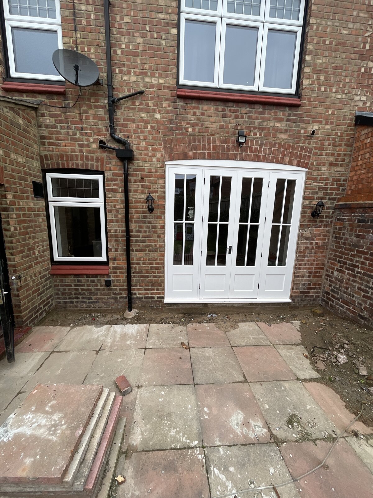

That photo is right now, I’d not noticed the internal walls on the first picture if im honest but from the outside the wall itself looks damp and there was previously a green house there.

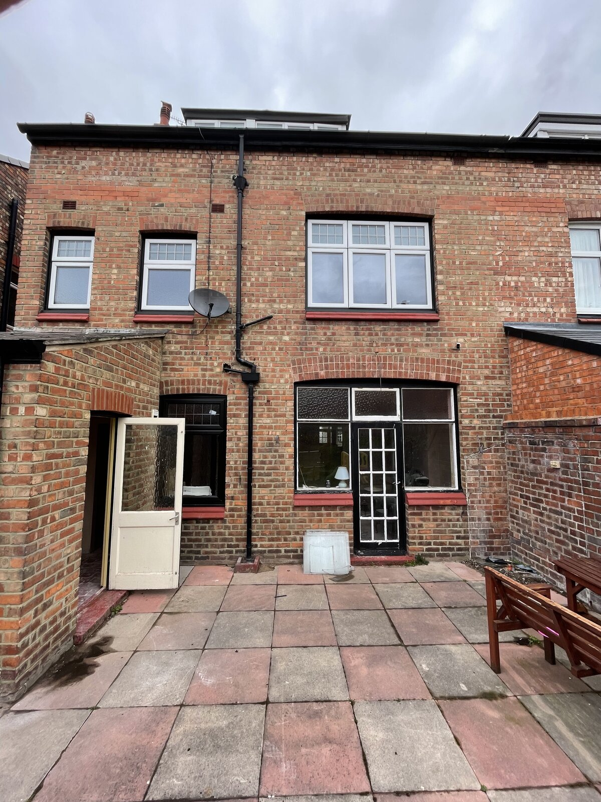

Picture before any work was done
The drain pipe you can see has been taken below ground into the drain as it was previously overflowing a lot and the water (rain water too) would just sit on top of the patio.
Is the old drain glazed... might be cracked/leaking/blocked or have you replaced it with plastic? Might explain the abundance of water when it rains.
Patio is also too high in my opinion, could do with coming down a couple of bricks depth.
I'm liking the brick lintels.

I’ve only replaced the lower (below the hopper) pipe which goes straight into the drain.
When you say is the old drain glazed, do you mean underground damage?
Yes, the 'hopper' and the pipework that is connected to this. I've frequently found cracks in old drainage, and had to replace lots of it.
The waste pipes from your sinks shouldn't really be fed into this drain, as you currently have, they should go into the foul drain.
Your rainwater drain may be a soak away, these can get silted-up over the years and be slow at dispersing water, if it backs-up you can have problems with standing water.

If it were me, i would dig up the patio. Check drains. Lower the patio as above. Make sure no rain flows or pools by the house wall.

The gulley is pretty sure to be cracked and leaking. The concrete poultice is typical of futile attempts to repair broken clay drains.
The paving is too high and may be above DPC.
Can you see the DPC?
The lowest bricks are a darker colour, as if they are wet.
You might find a hidden manhole when you remove the paving.

Thanks JohnD,
The concrete was put on top a few months back just to ensure the pipe water collected and didn't spill over, although I've not checked any further.
Paving is definitely too high and runs toward the house, but having it run away may make things harder as the line at the house would have to be higher.
I can vaguely see what may be a DPC - almost a black layer between some bricks that, underneath the door, isn't there anymore.
I'm assuming finding a manhole wouldn't be a good thing?

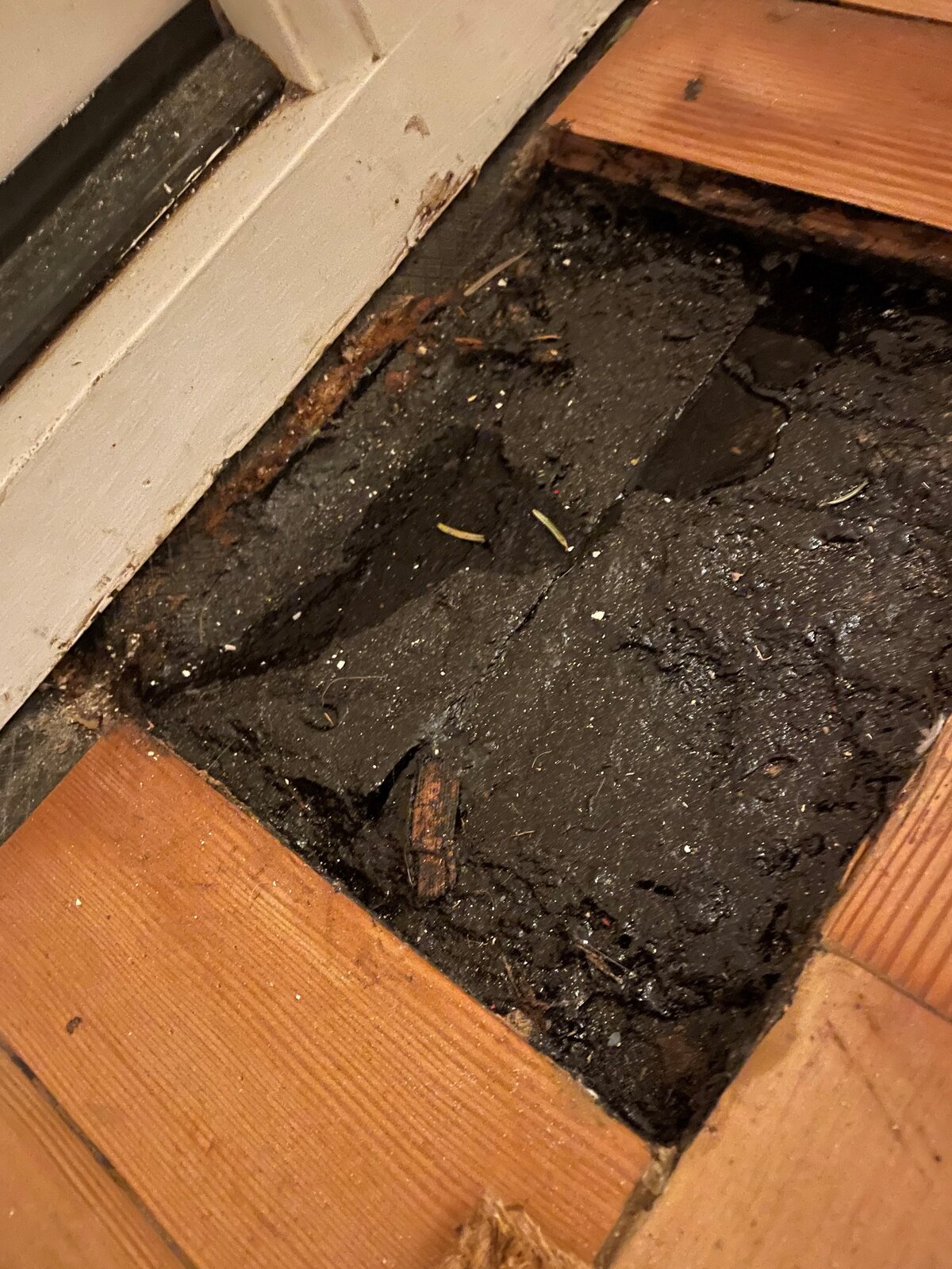

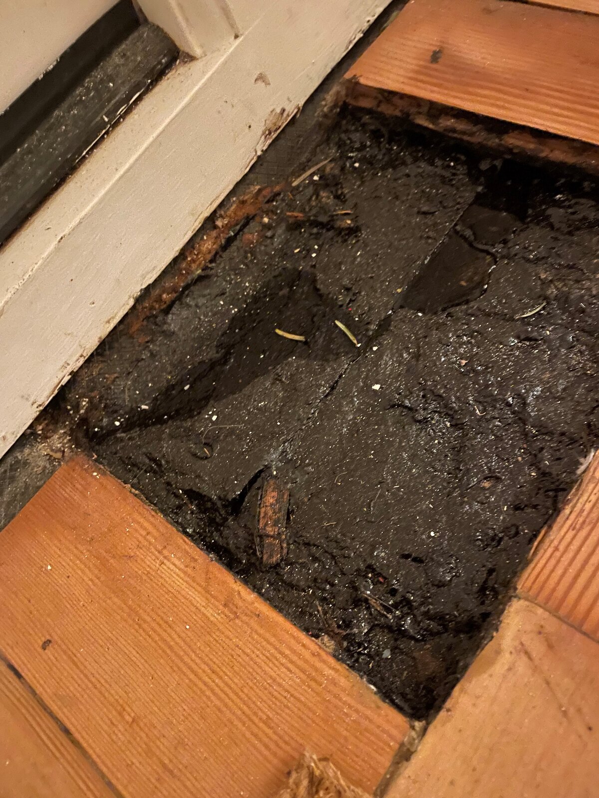

So, after some investigative work it looks like the water is coming in around the DPM that you can see below the sill. The picture below shows the trickle in after a night of rain.
The water is coming in both below the DPM and above it, below the french doors.
The fix to this in my mind is to cut back the DPM so its hardly visible and use exterior silicone around it to prevent any future ingress.
Any pros or cons to this?

I can't see how the water's getting in round that door.
Could it be running round the frame?
