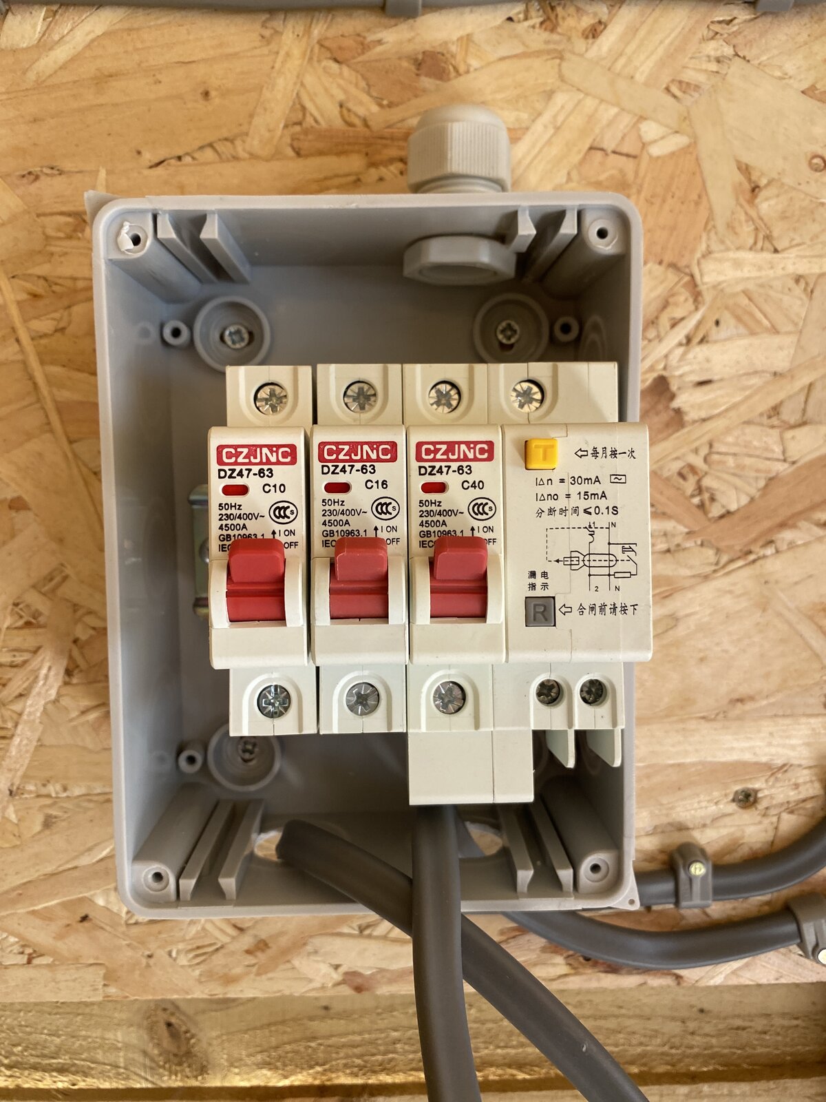

Sorry was working away when I asked the question got home and this is what I bought
Well that's a shoddy looking thing.
First problem- you appear to be installing a consumer unit. Such things are required to be metal nowadays.
Second problem- you've bought some safety -critical kit from Wish or somewhere similar? Was it that much cheaper than trotting down to Screwfix or similar and getting a garage CU?

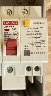

You'll need a multimeter to determine for certain what does what- it is likely that the terminal above the TEST button is N, the bottom 2 small terminals might both be N or might not. Are there any markings on the cable entry faces?

Are you realising that this is one piece?
Meaning that there are 'enough' terminals (too many???).
Plus - does the C40 mean it is in fact a (single pole???) RCBO?
The unmarked terminal is an internal connection.
The other devices are separate and unrelated.
Type AC RCD which is not permitted
GB10963.1 is a Chinese standard.
The enclosure may be plastic but that is not 'waterproof' by any stretch of the imagination.
A UK compliant item with the required busbar, terminals, metal enclosure and Type A RCD is £33, https://www.toolstation.com/axiom-garage-consumer-unit-type-a-2-way/p75358
Ah :) No, I obviously was not noticing/realising that! Thanks for making me look properly!

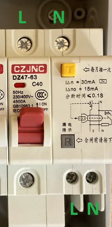

In that case, as you say, if anything there are 'two many' terminals, and I therefore am inclined to agree with what oldbutnotdead said - namely that the terminal above the test button is an N, as presumably are the pair at the bottom-ight (and, by implication the terminals at top and bottom of the part that looks like an MCB are the two Ls
It does look like that and, although I do not find the diagram on it very clear, it looks as if that probably confirms that it is only SP.
... and why, I wonder, do all the devices appear to be C-curve? One has to hope that the circuits the OP intends to use it for will have a low enough Zs to support that.
What you have indicated and say above seems credible (and different what what I had suspected).
Do I take it that you are familiar with the device and/or have seen its documentation, or are you just 'guessing'? ( without taking a meter to it, guessing is all I could personally do).
Kind Regards, John
Not seen that exact one, but have seen similar items before. They are typically sold for use in caravans and motorhomes on places like Aliexpress.
It's effectively an RCBO, but the MCB and RCD are separate items, overcurrent trips the MCB, current imbalance trips the RCD, but resetting one has no effect on the other, which is why the RCD has both test and reset buttons.
