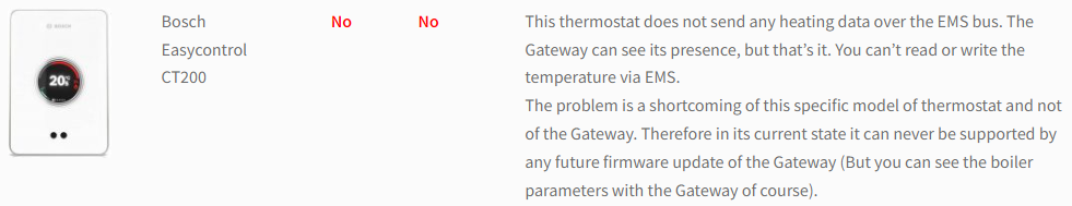

I have been in touch with WB tech support who tell me that my boiler can’t do different flow temps even with the Easycontrol so that’s a non starter. I won’t gain anything by swapping Wiser to Easycontrol.

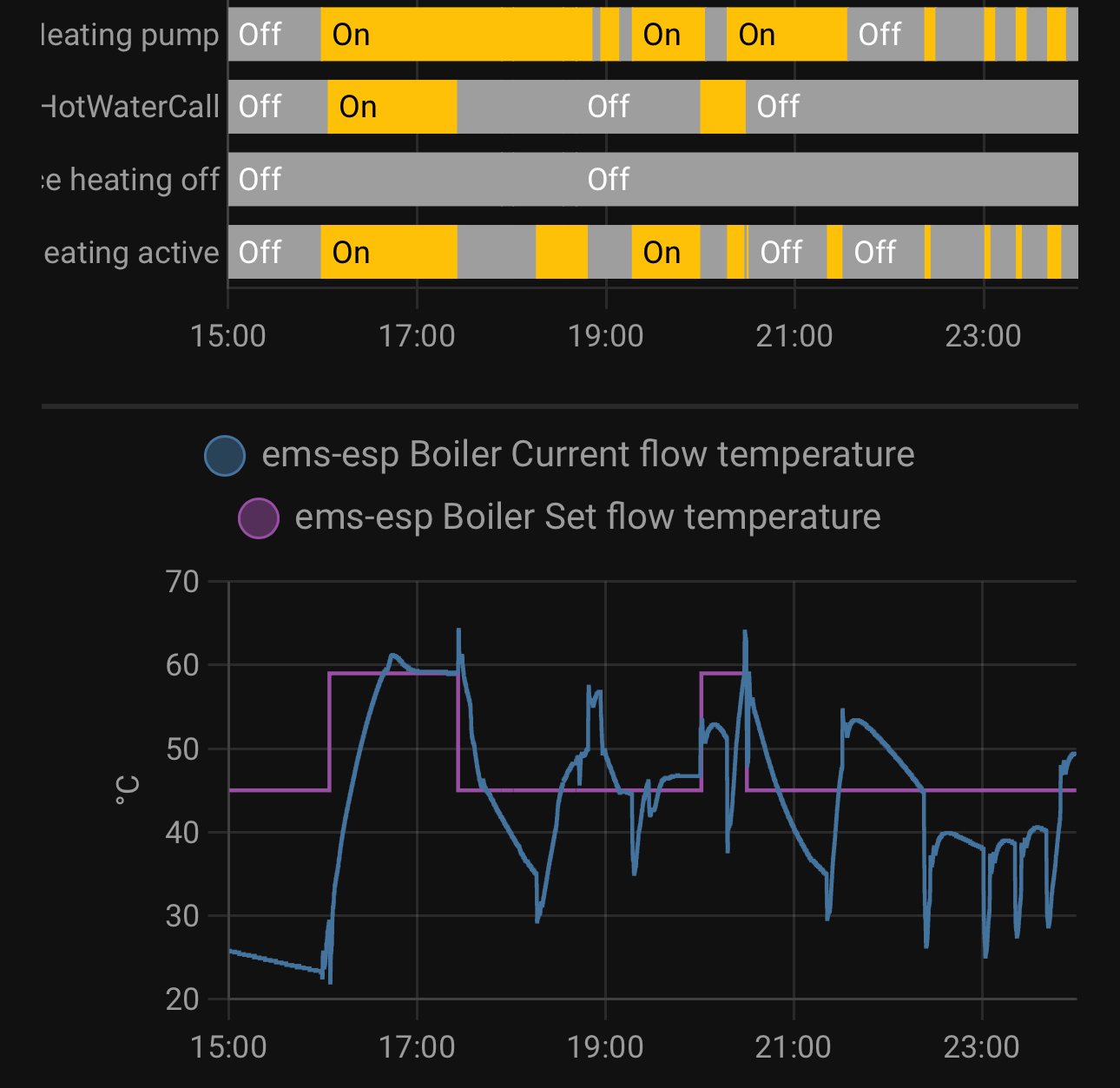

I’m not sure how committed to the idea you are, but I recently got my 2019 Greenstar 15 Ri to do hot water priority with different flow temps.
It took building and configuring an EMS to wifi bridge you can buy from https://bbqkees-electronics.nl/
Its controlled via home assistant to pick up the call for heat from the HW tank thermostat via a mains coil relay and change the flow temp and max burner power via EMS.
I didn’t see this capability documented anywhere, I’m guessing since it’s a “bottom of the range” boiler WB want you to buy a fancier one to get this functionality that’s actually already there….
I only tried as the previous owners had a British Gas telemetry module hooked up to the EMS bus which I modded to a cheap ESP32 I had from another project anyway, so my initial investment was zero.

I thought it strange that the Bosch Easycontrol connects directly to the EMS bus yet it is still only an on/off control and according to WB tech support can not change the flow temp.
Trying to get information from WB about this is like getting blood from a stone. All they will tell you is that the only way to make it work is by using their integral diverter valve kit.

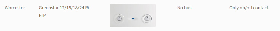

On the website you linked to it seems to say that your boiler isn't compatible? But clearly you've made it work!

I dont see the point of having an EMS bus and controls that don't do more than on/off control.
According to the link from @Rxt_ian the Easy Control has very limited EMS functionality. But there are other WB controls which also use EMS and may possibly do more.
