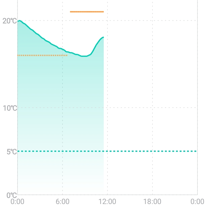

I ask as I have a problem, with a hysteresis in room temperatures. 1706528039140.png This is likely due to three independent devices trying to control the room temperature, the boiler cycles on/off, the wall thermostat cycles on/off, and the TRV tries to modulate radiator output. So at the moment the wall thermostat has over shoot the mark
and until the hall has cooled the TRV can't possibly heat living room. It shows outside at 10ºC and raining
and yes found on warm days like today the wall thermostat works better if it raises by 0.5ºC every two hours, but on a cold day works better if it goes straight to 20ºC. But can't find any way to program in a different method depending on weather outside.

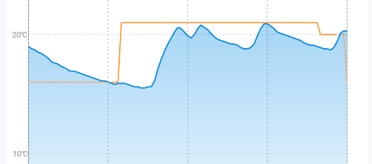

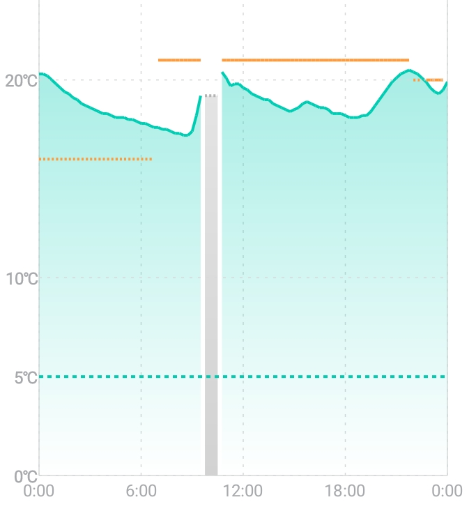

Anyway this was today 1706575725253.pngthe missing bit was when smart meter fitted so route was off, but boiler still running. Heating now off so temperature will drop until 8 am when wall thermostat starts boiler again. The TRV will open at 7:30 am but clearly with boiler not running as unlikely hall will drop to 16ºC it will do nothing until 8 am. So tomorrow will post result.

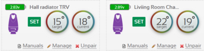

Well today reducing flow temperature does not seem to have impacted on the heating of the hall 1706615039050.png it is still warming up as quick as when the flow temperature was higher, however it has made a big difference to heating of the Living room 1706615186389.png it is taking twice as long to reheat. Since only just got up, and not used the Living room yet today this is not a problem, but clearly not what I really want, so think boiler temperature will be going back up, but will leave it for now and see how it does. My bedroom outside temp 9.7ºC in room 21ºC so that room OK.
