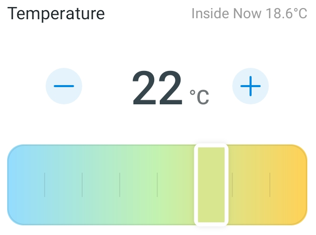

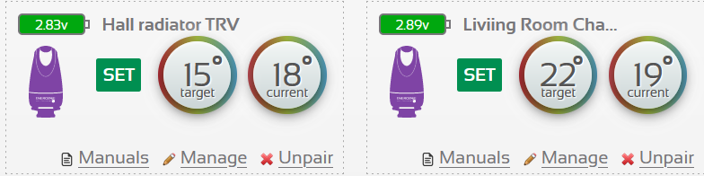

No hall has one small window in front door (never used) and the TRV set to 15ºC and at moment showing 18ºC so hall radiator has been off for most of the day, the wall thermostat however shows over 20ºC 1706632492993.png it seems heat comes from shower room, kitchen, and living room, plus likely through floor from flat below, the wall thermostat is likely at about the most central point in the house.
So living room not too bad today1706632996238.png 1706632714179.png but the delay in heating living room and hysteresis have increased 1706633115247.pngI suppose the point is without the TRV showing a history I would be unaware to what is happening, but the graph shows it so well, I do think the radiators are too small, however looking into changing wood framed double glazing to plastic double glazing with larger space between the two bits of glass, so will wait and see what that does.
