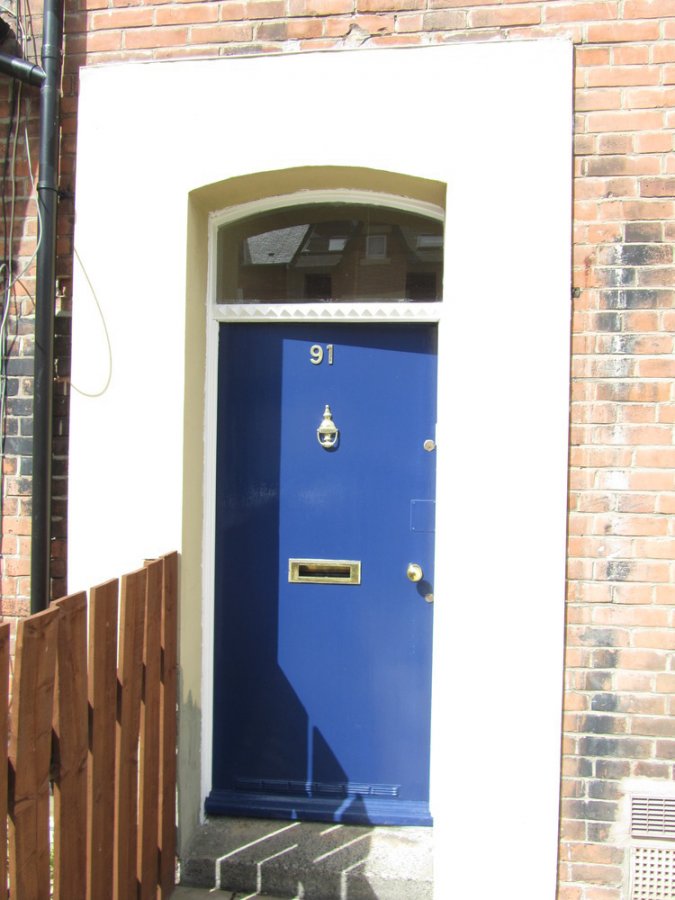

Weatherproofing/boxing in RSJ from the outside
You can but not sure why you'd want to, you'd have to pack it out to make it flush using some timber... :). You'd still have the flanges to deal with as well.
I still think you should put a little timber porch on the back. Would stop you messing around trying to tie in bond etc.
Or move the column so it's inline with the kitchen wall so you have a small cantilever.
Or render or clad around the door a bit.
Thank you tomfe. That frame around the door in the pictures looks very pretty. How do I achieve something like that?
You use render with stop beads around the edge.
Thank you.
So, what I need to do is:
1. Fix timber in the RSJ web (flush with RSJ flange)
2. Fix a cement board on top of the timber (also on the sides to make a levelled frame ?)
3. Render on top of cement board
anything missing?
